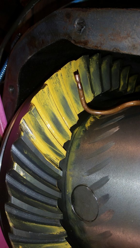

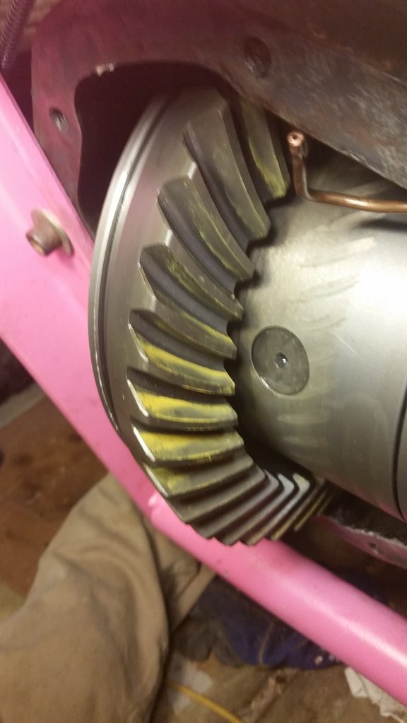

    Pattern looks good to me. A bit deep but not terrible.

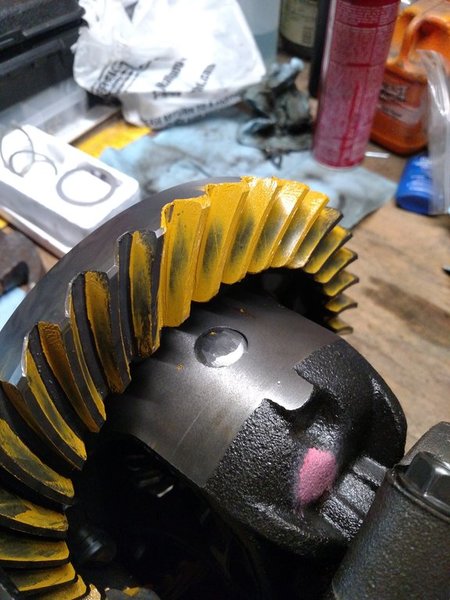

    No the pinion was still shallow, thats why the contact pattern on the drive side is to the outside of the ring gear. I figured it was but wanted to see what some pirates had to say and they agreed. I increased my pinion shim by .005 and then two more shot re shimming the carrier yielded a decent patter with .0065 " BL. Pictures of said pattern in a few.

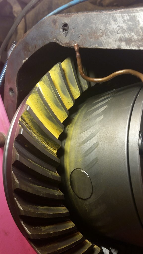

    Drive:
    Coast:

    Call me stupid, but is the pinion grazing the locker?

    Thats from driving back to the parking lot in front wheel drive with the pinion head loose in the pumpkin, thus why I removed my rear shafts for the drive home, so the carrier didn't turn ;)

    Still looks shallow to me. Try a bigger jump in shim like .010 or .015

    I was thinking the same thing, for a off road rig is better to have it a little deep to have room to walk up some.

    A little deep is stronger too.

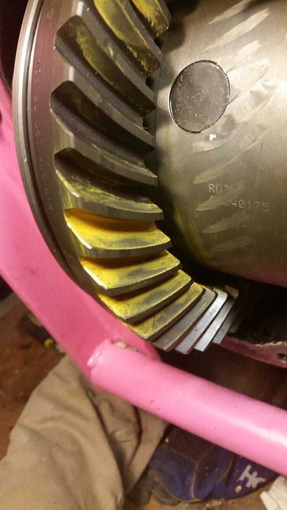

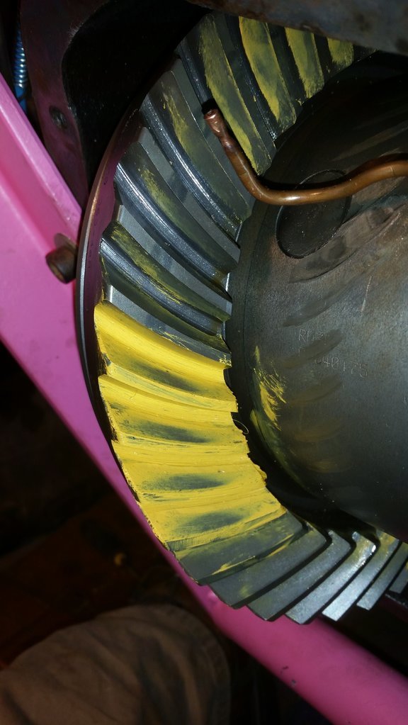

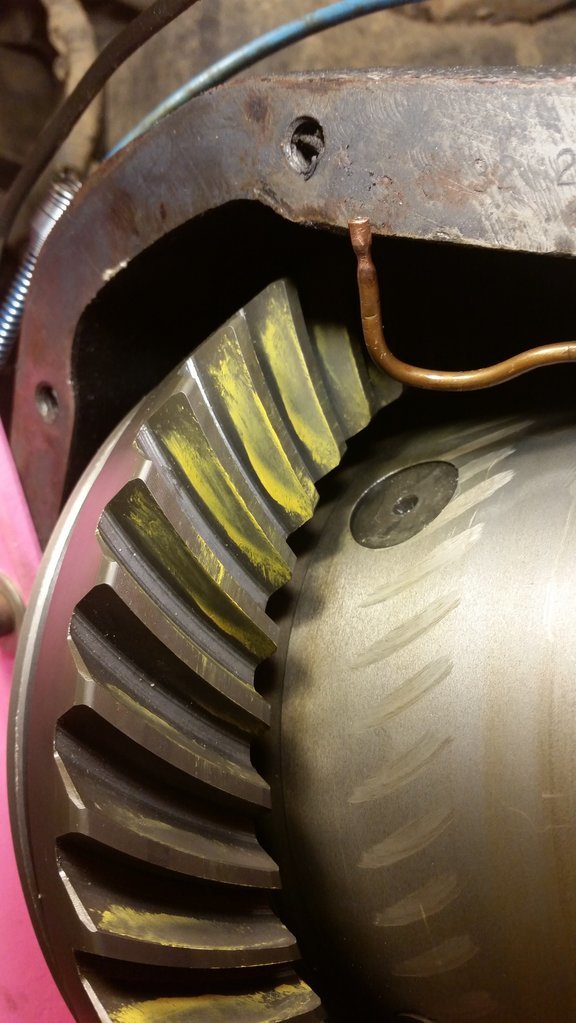

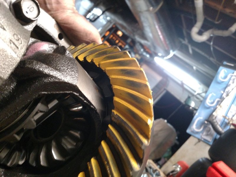

    Well I added another .005 last night and heres where i am at:
    Pinion Shim: .043"
    Pinion Preload shim: .054"
    NRGS: .094"
    RGS: .024"
    Pinion Preload: 10in*lbs
    Backlash: .005"
    Drive:
    Coast:
  20. Mar 10, 2016 at 7:15 PM

    Looking better. I'd still go a little deeper but that's my preference
