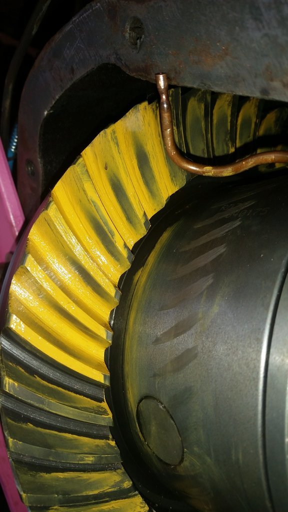

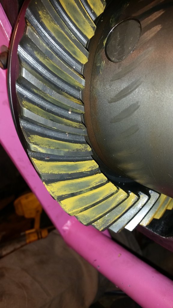

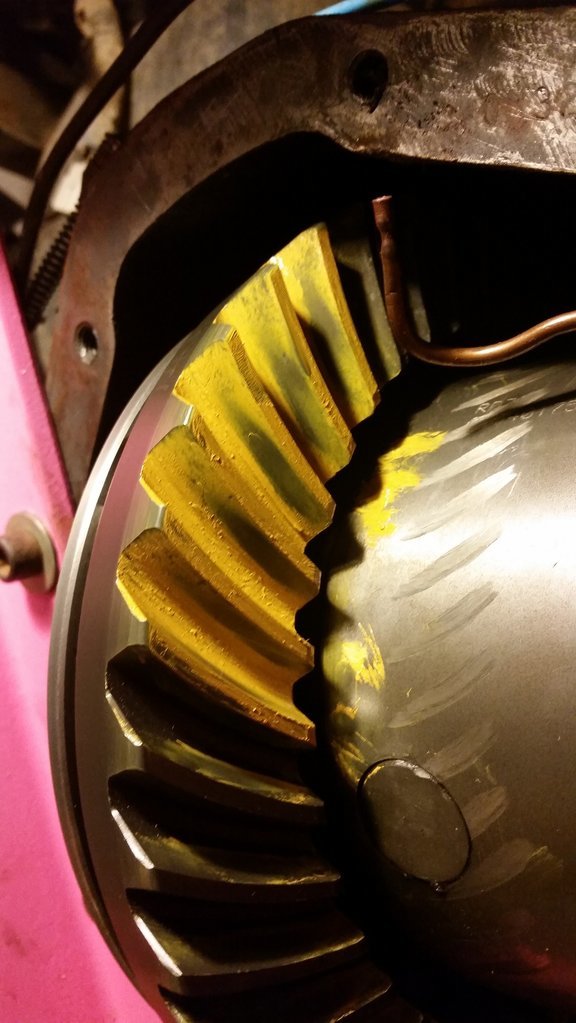

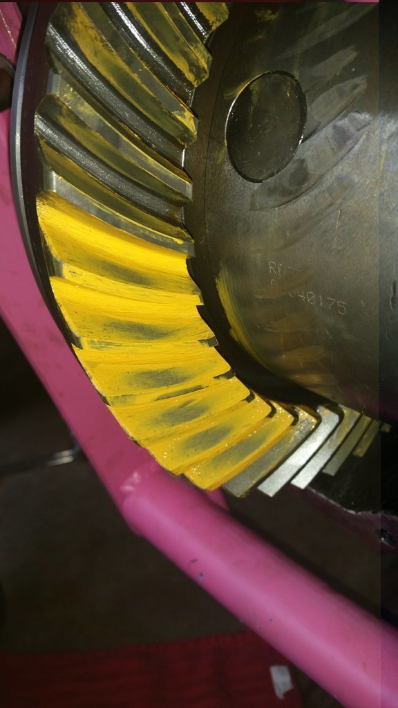

    And yet another .005"
    Drive:
    Coast:
    20160310_213849_zpscty450fq_f112f0a9411f0893b0a90372ca632ac9cf3cd71e.jpg[/QUOTE]
    Backlash is at .006. I am thinking it looks good, run it like this, but tighten up the BL a touch to get the gears running a bit deeper yet.

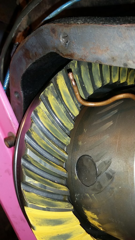

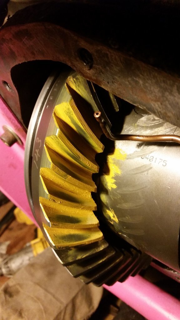

    Pulled out .002" and here's the result:
    Pinion Shim: .047"
    Pinion Preload shim: .056"
    NRGS: .095"
    RGS: .023"
    Pinion Preload: 10in*lbs
    Backlash: .005"
    I think this is it :cool:

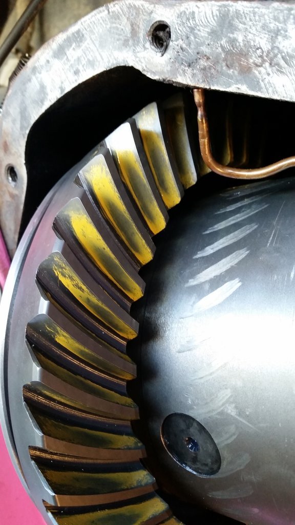

    OK final bearings installed in lieu of set-up bearings. One adjustment to pinion shim after installing with new bearings, and this is what I'm running [literally right now, lol]
    .006" BL
