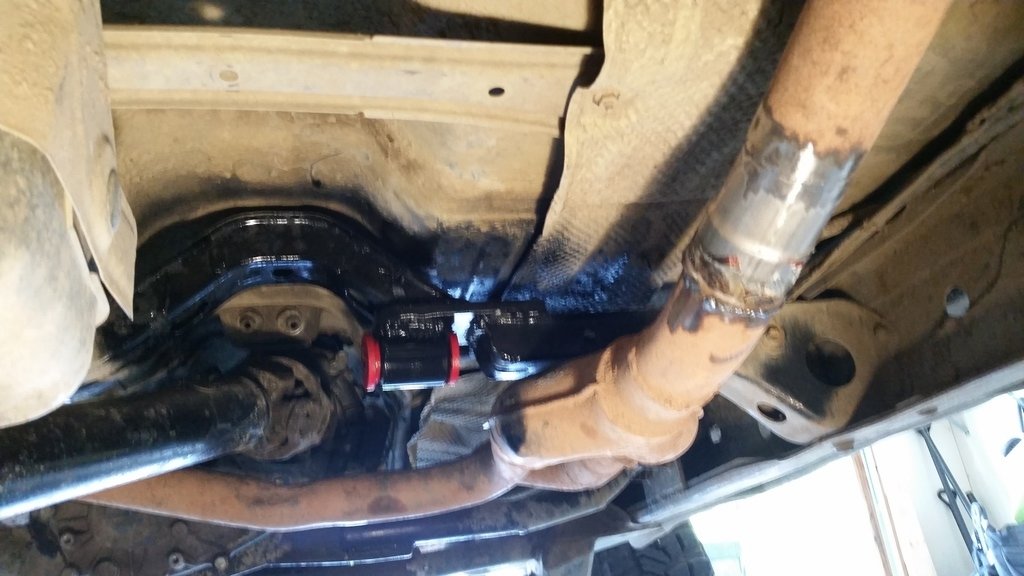

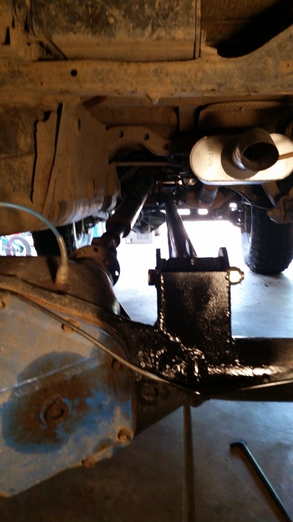

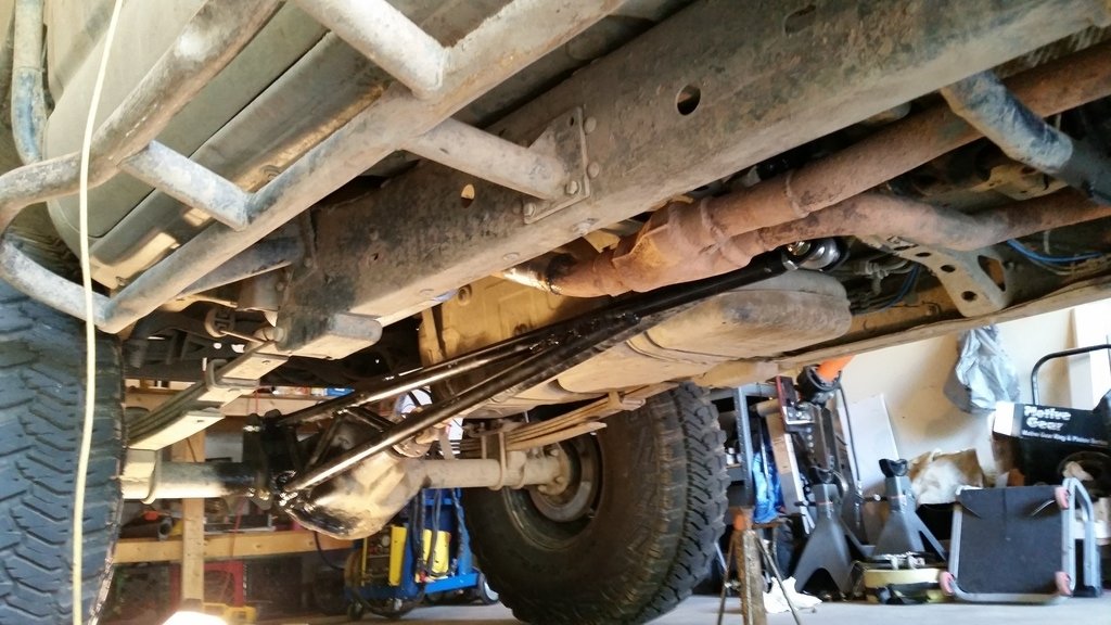

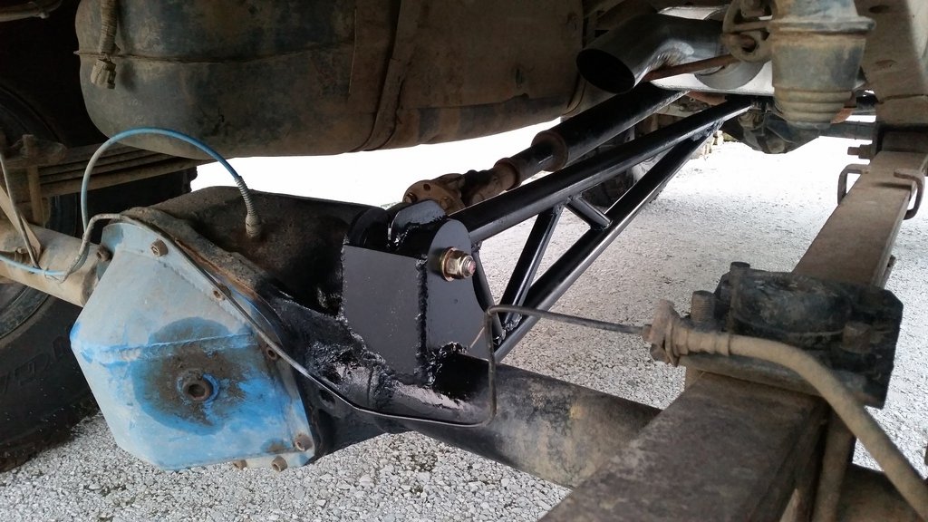

    Well after 6 years of sitting on a shelf, I put my Craptastic Fab Traction Bar kit together. I had scavenged the DOM for steering links during the SAC so I got more of that too. And SupraTT stole some of the bushings last leaf spring first-aid application on his truck, so yeah some are red and some are black who cares. Red bushings matter too.
    A little slice and dice and weld on the cross-member:
    Angle's just about right, lower bar sits about 1" lower than the driveshaft:
    From the back:
    Backerer:
    Moved the exhaust over a touch and threw a new "muffler" in as well for good measure since the old Flowmaster 50 was rotted through. Everything just fits between my driveshaft and y-collector.
    Man its like driving a different truck. The rear is planted. Its amazing how much rear suspension movement was actually being induced by axle wrap :/

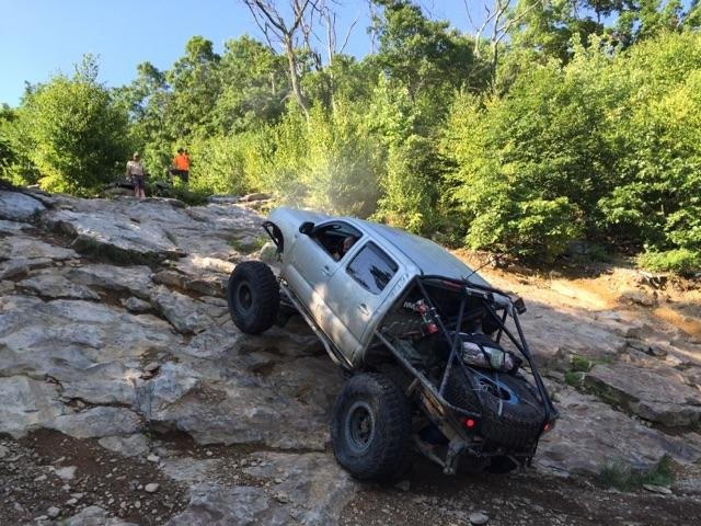

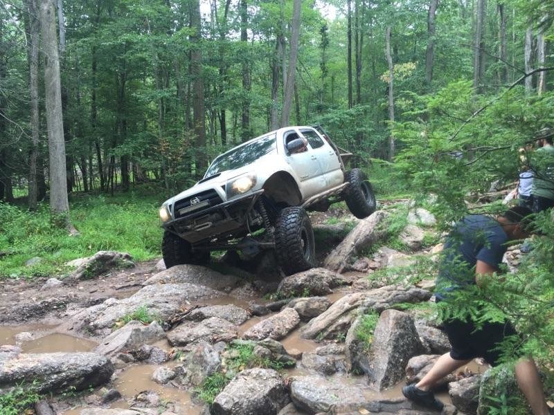

    Well I got to put it to the test this weekend.

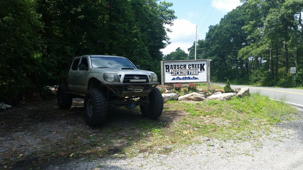

    Went to Rausch Creek Off Road Park in Tremont PA for an event held by TW and Northeast Toyota Crawlers. Roughly 700 miles each way, in the truck :D
    We left on Thursday night and drove about to Cleveland where we slept in the truck in a rest stop for about 3 hours. Never been to PA before so the obligatory photo:
    We then continued straight to the park:

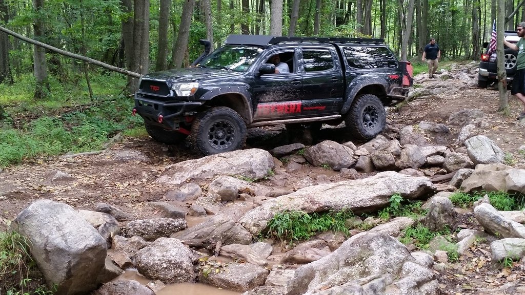

    Found a few guys and headed out on the trails. Ran blacks and reds all day and evening. Basically every black hillclimb on the back side of the comp course. Including Jotter several times. Some random pics I collected from the interwebz:
    Tatts521, 45acp, Neutral and 4 others like this.

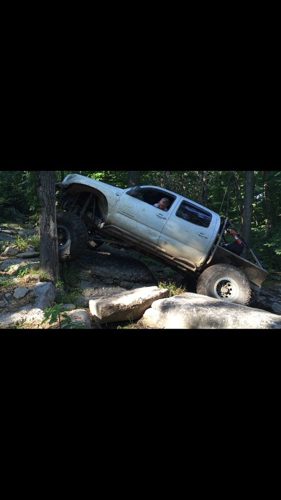

    Saturday we met up with some TW people and ran some easier trails with them for a few hours:
    Then we headed into Rock Creek which is just a giant glacial deposit of rocks, really fun:
