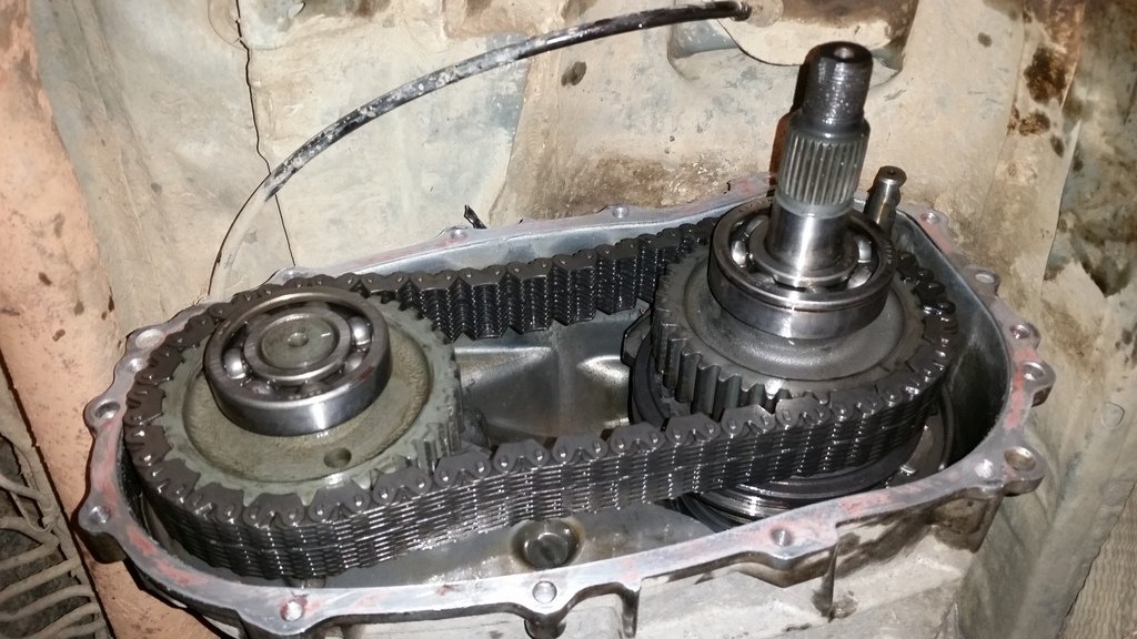

    And I snapped my tcase output tonight at the truck pulls...launched just a tad to hard lol

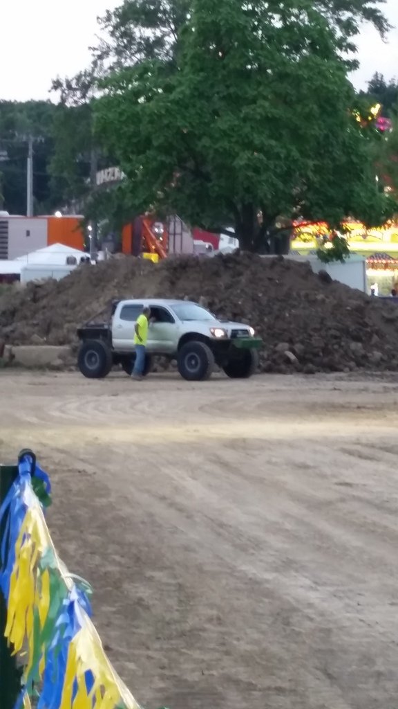

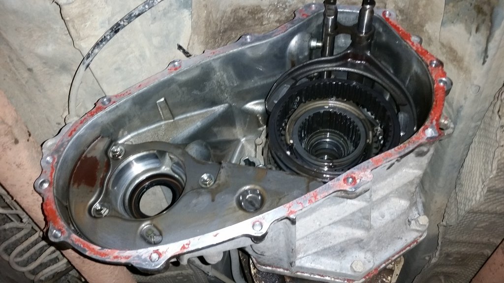

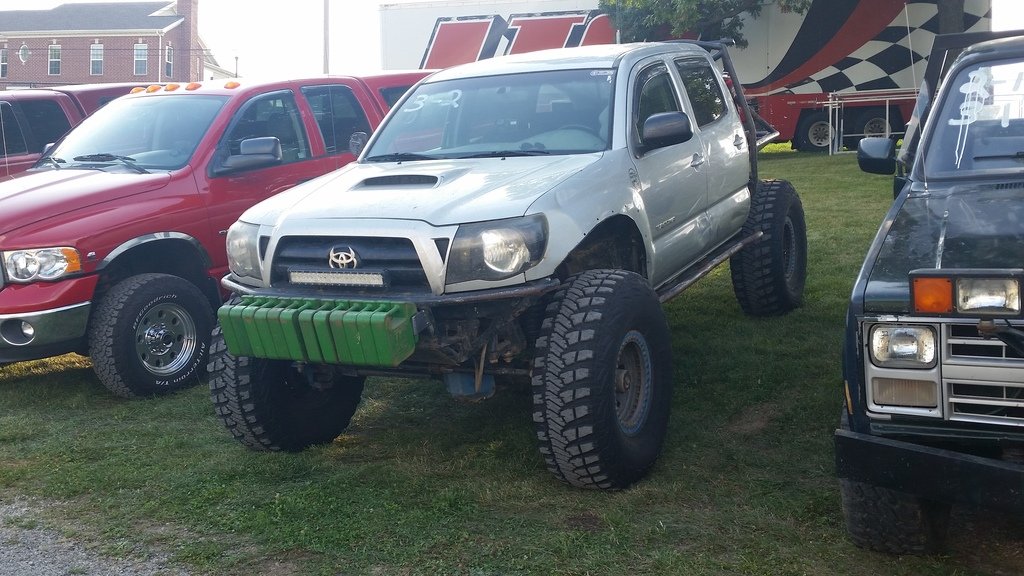

    Well last Friday afternoon I busted hump to get bumpstop extensions done (to save my springs) and a weight bar made up front, and got to the pulls with plenty of time to spare. After getting tech'd in a found a nice spot to park:
    There was a stock gas, stock diesel, and run what you brung class, all had to be street legal no trailers. Patiently waitng my turn:

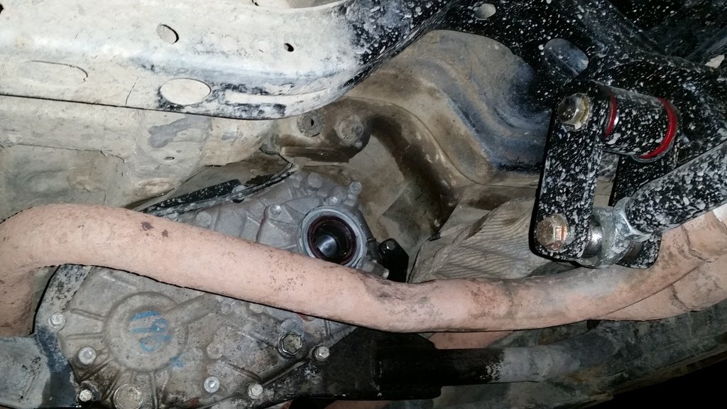

    Well my turn came soon enough and went quick enough. Since this was a floating finish distance was all that mattered so I figured I would give L-L a shot. Bad move. Major Mistake. Epic Fail. Call it what you wish. I gassed it off the line to a large whoo-POW which I figured was something important but the sled was moving now. 75' later I called it and looked under the truck to see my rear output gone.
    Luckily the exhaust, shackle from the traction bar, and the horsecollar crossmember acted like a driveshaft hoop and kept it out of things while I drove to the pits. I removed the rear driveshaft and drove home front wheel drive.
    Cracked the case open and gutted it:

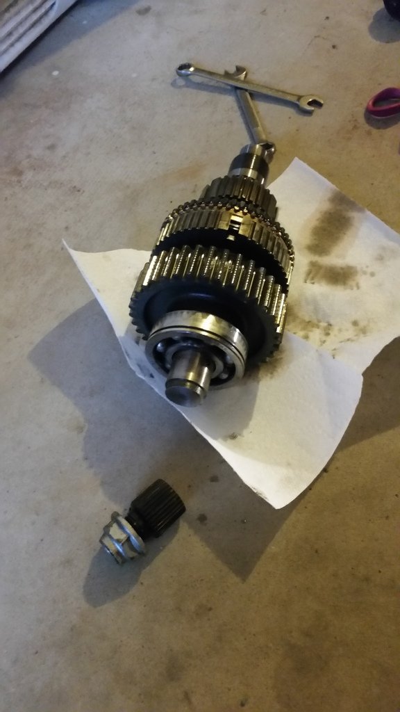

    Stuck some new guts in:
    All back together now and ready for V6 mud drags Thursday at the Fair :D
    The offending shaft:

    I'm surprised at how clean that break is.

    Shear point?

    Yes, but I would assume grain structure would be running lengthwise leaving some amount of deformity, spiraling, or multiple pieces. So clean, it almost looks machined off.

    Mark, if you post a picture of the shaft looking straight on at the break I can probably tell you why it failed. We had a training at work to be able to determine how and why things break.

    I can, but it was right at a stress riser due to a notch machined in it for some reason. I will get more this afternoon for you all.

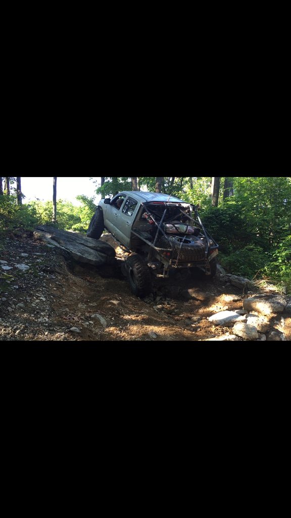

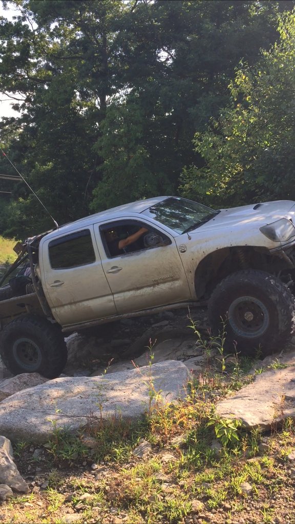

    [​IMG]DSC00346 by Jonathan Krajnak, on Flickr
    [​IMG]DSC00353 by Jonathan Krajnak, on Flickr
    [​IMG]DSC00357 by Jonathan Krajnak, on Flickr
    [​IMG]DSC00358 by Jonathan Krajnak, on Flickr
    [​IMG]DSC00360 by Jonathan Krajnak, on Flickr
    [​IMG]DSC00361 by Jonathan Krajnak, on Flickr
    [​IMG]DSC00364 by Jonathan Krajnak, on Flickr
    [​IMG]DSC00365 by Jonathan Krajnak, on Flickr
    [​IMG]DSC00366 by Jonathan Krajnak, on Flickr
    [​IMG]DSC00370 by Jonathan Krajnak, on Flickr
    [​IMG]DSC00380 by Jonathan Krajnak, on Flickr
    [​IMG]DSC00384 by Jonathan Krajnak, on Flickr
    [​IMG]DSC00392 by Jonathan Krajnak, on Flickr
    [​IMG]DSC00393 by Jonathan Krajnak, on Flickr
    [​IMG]DSC00402 by Jonathan Krajnak, on Flickr
    [​IMG]DSC00405 by Jonathan Krajnak, on Flickr
    [​IMG]DSC00406 by Jonathan Krajnak, on Flickr
    [​IMG]DSC00411 by Jonathan Krajnak, on Flickr
    [​IMG]DSC00413 by Jonathan Krajnak, on Flickr
    [​IMG]DSC00422 by Jonathan Krajnak, on Flickr
    [​IMG]DSC00424 by Jonathan Krajnak, on Flickr
    [​IMG]DSC00426 by Jonathan Krajnak, on Flickr
    [​IMG]DSC00430 by Jonathan Krajnak, on Flickr
    [​IMG]DSC00440 by Jonathan Krajnak, on Flickr
    [​IMG]DSC00446 by Jonathan Krajnak, on Flickr
    [​IMG]DSC00454 by Jonathan Krajnak, on Flickr

    Damn, awesome action pics!
    Rig looks great!

    As usual, pictures never do it justice. Even so, the rig and Mark's driving don't need ridiculous camera angles/tricks to make it look steeper. :eek:
