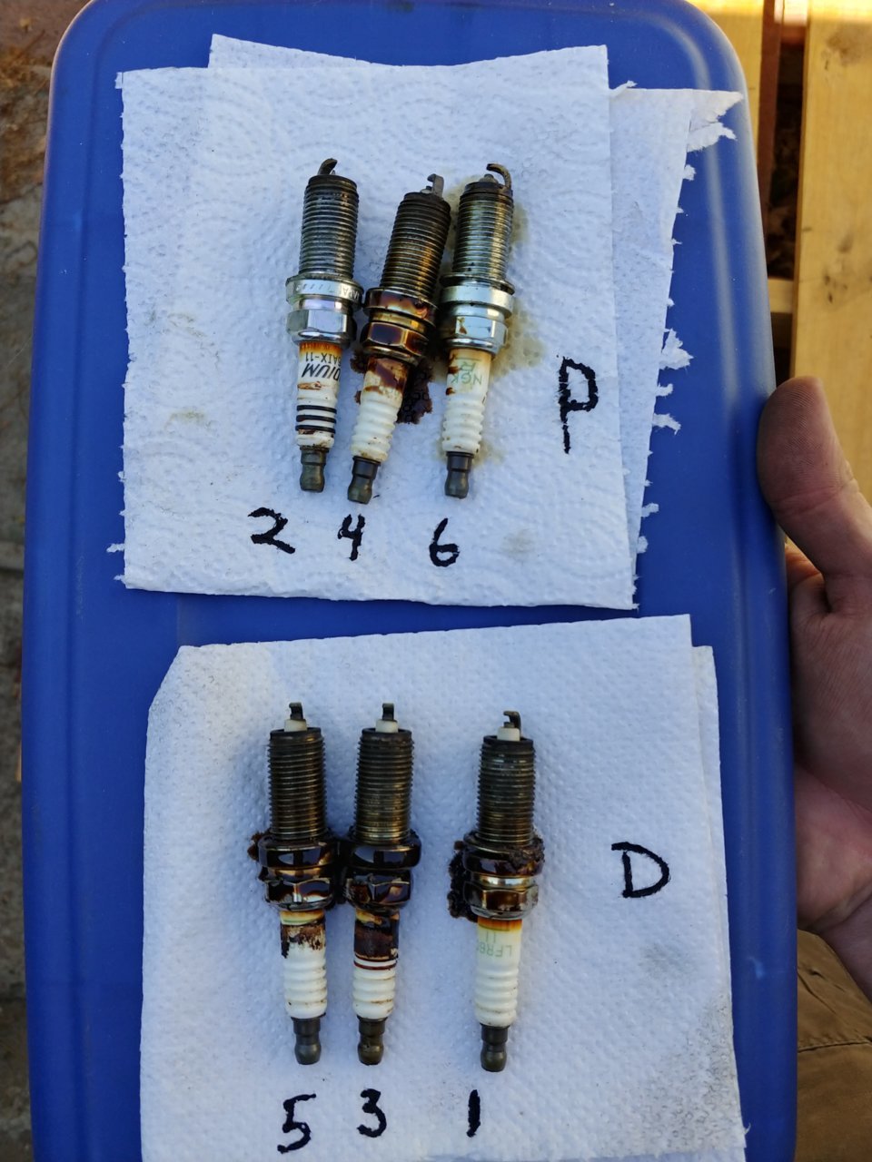

    I did spark plugs today!
    Finally an easy job!
    I did have to go get another 6" 3/8 extension because I couldn't turn my retchet enough with just a 6" and 3".
    But then...:goingcrazy:
    And then...:help:
    Well this is less than ideal.
    There is an odd man out here too.
    #2 is an Iridium LFR6AIX-11 while the rest are LFR6C-11.
    #2 was also the only one without oil on it.
    So I guess valve cover gaskets and/or plug tube seals are now on the list.
    That's for a later time, but not too much later. Catch 22.
