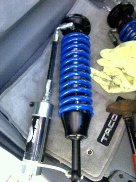

    700 lb King coils installed on Fox Long travel shock. Less preload for winch bumper and skid plates
