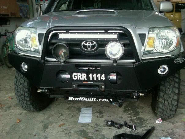

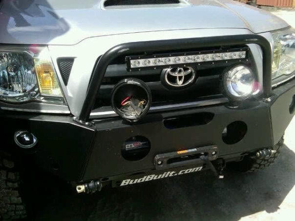

    Based on what you said, it looks like this may be the set for me. I only want a 2"-3" lift, and I'm after more of an expedition setup for desert travel. Good to see Bud's skid plates meet your needs. I went with 1/4" aluminum to save weight. No major rock crawling for my daily driver. :)

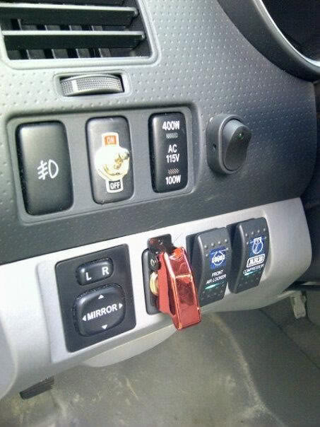

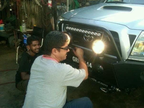

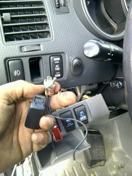

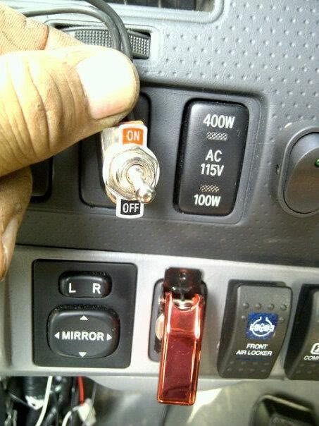

    ABS DISABLE Switch
    ABS Disable Switch installed.

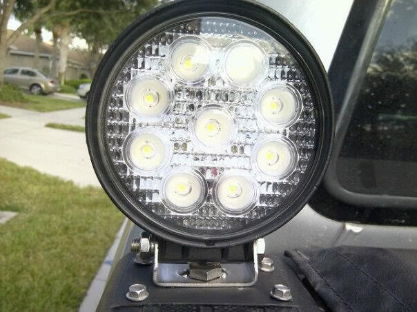

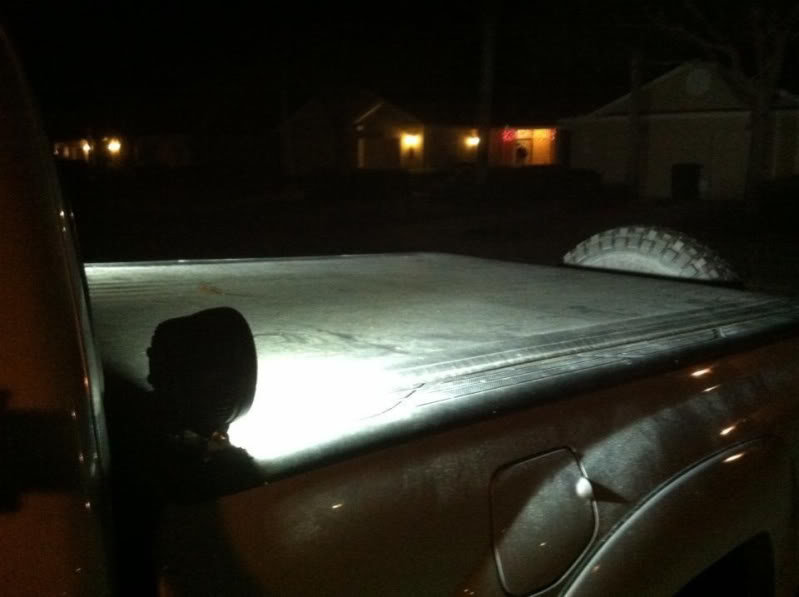

    REAR Bed Flood lights

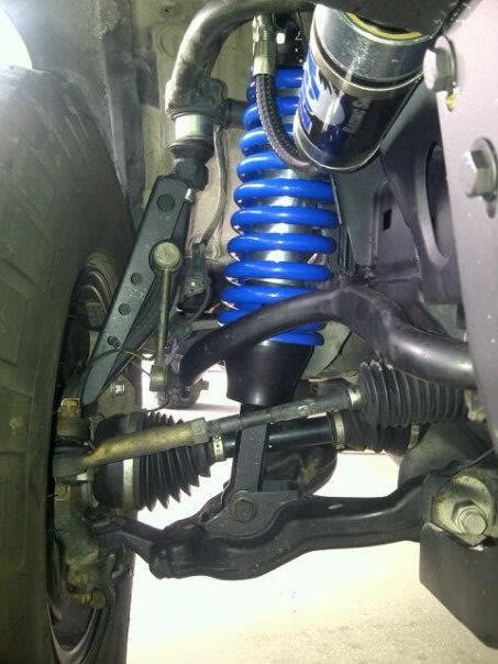

    For stock Lower arms this is the best setup for long travel IFS. Also most reliable as no Uniballs to wear out. The high speed off road ride is amazing.

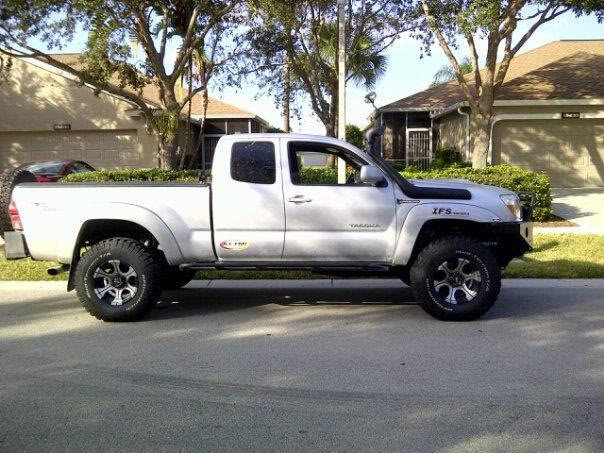

    Truck as it sits now with 3in Droop and 700lb coils. Changing to 600lb coils and lowering to 4 in droop.

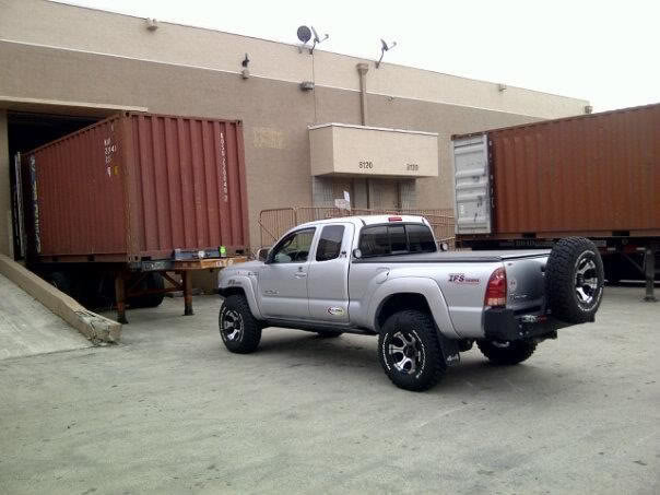

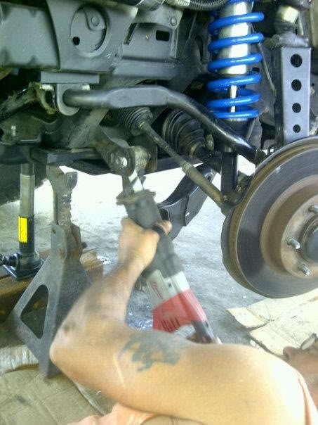

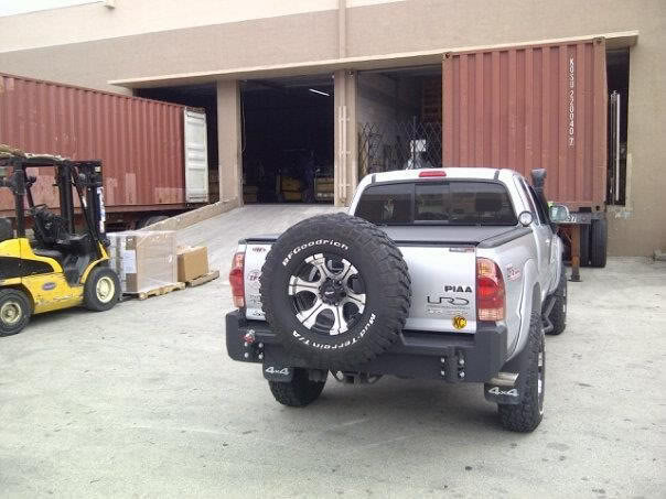

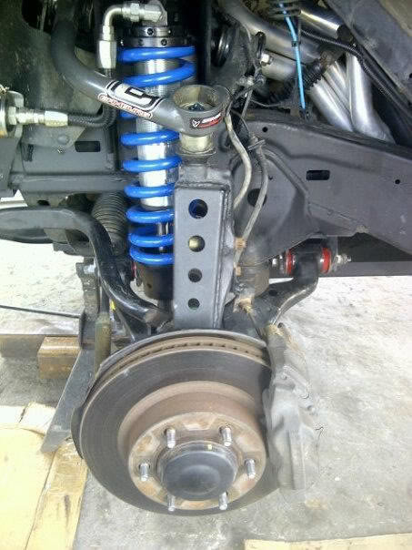

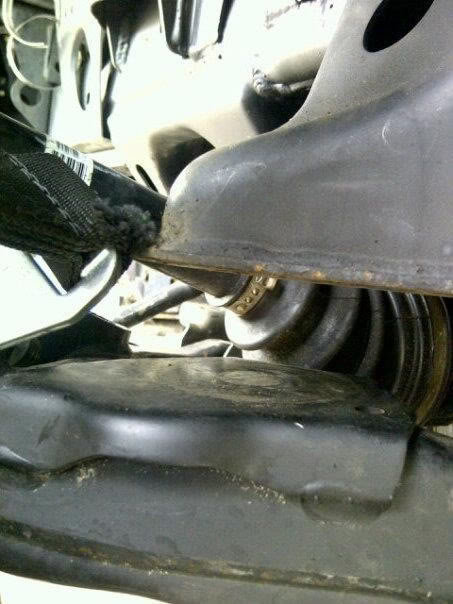

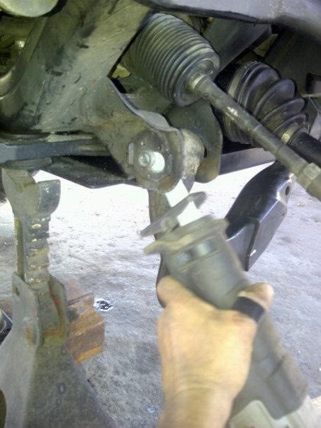

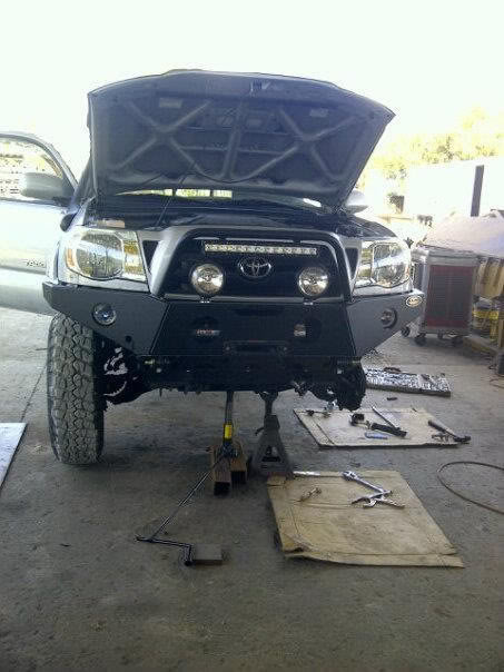

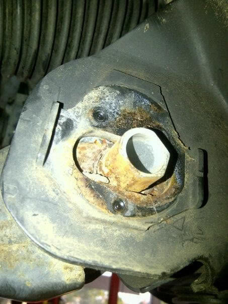

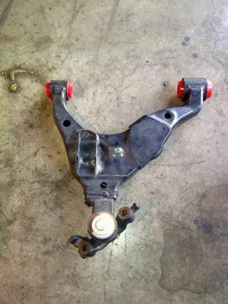

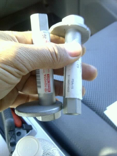

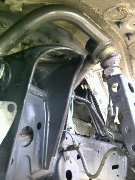

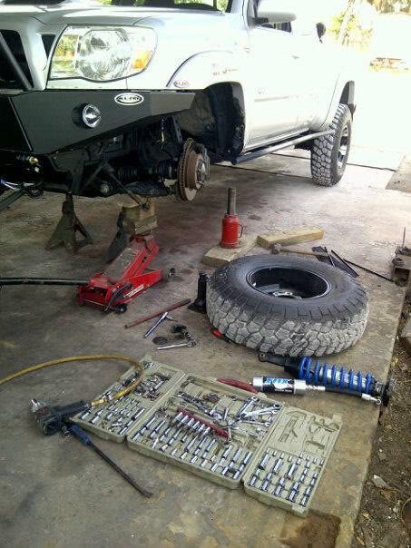

    Frozen LCA cam adjuster
    Had to cut out LCA to change Arms.

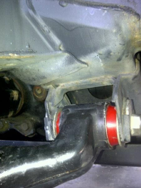

    Arms with non binding Nolathane bushings installed.
    New alignment cams installed with protective lube

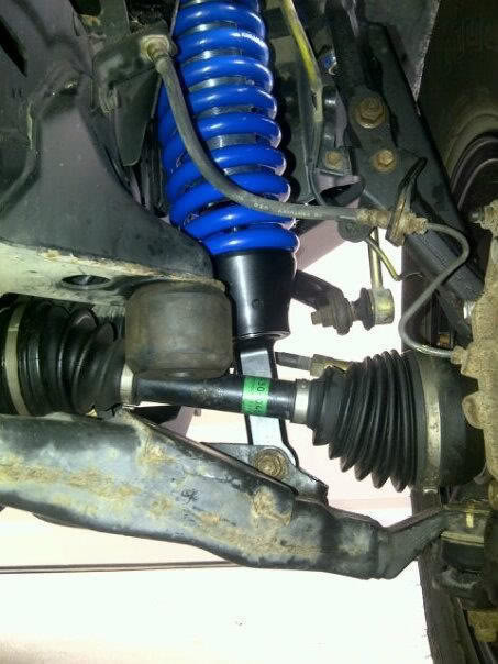

    Getting ready to check suspension flex and ball joint limits
    Nolathane bushings.

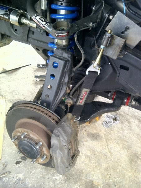

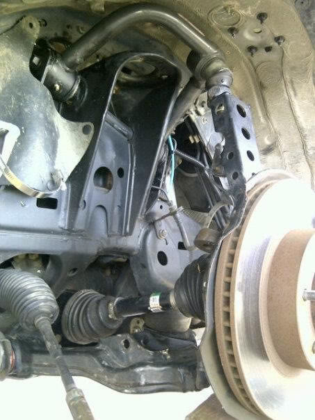

    Bumpstop shimming to control UCA balljoint limits

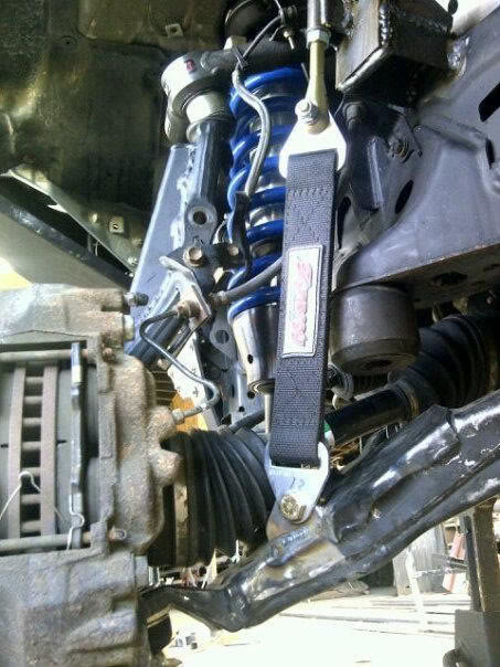

    Upper balljoint bind limit
    Limit strap to stop shock extension clunk at sudden full droop extension on huge bumps..installed on rear to stay away from Swaybar and steering.

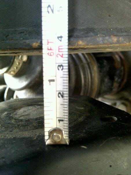

    3.5cm to upper balljoint bind..shimmed bumpstop for protection.

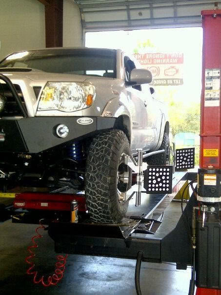

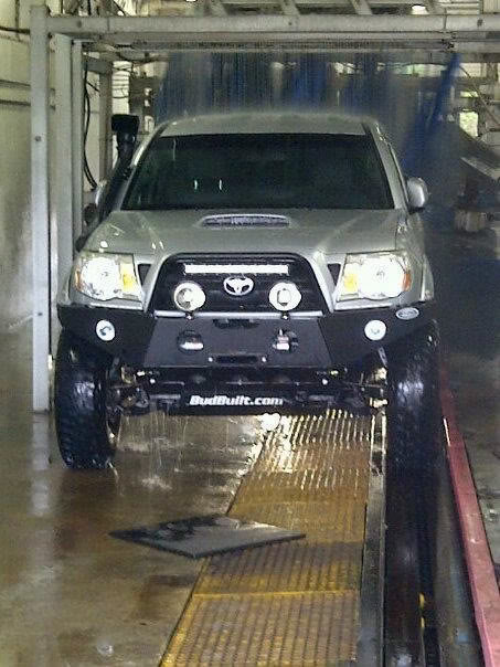

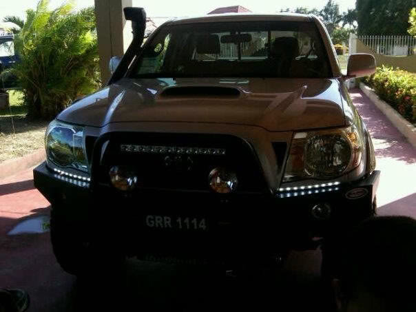

    Final wheel alignment.
    Test drive!!!
    Clean up!!!!

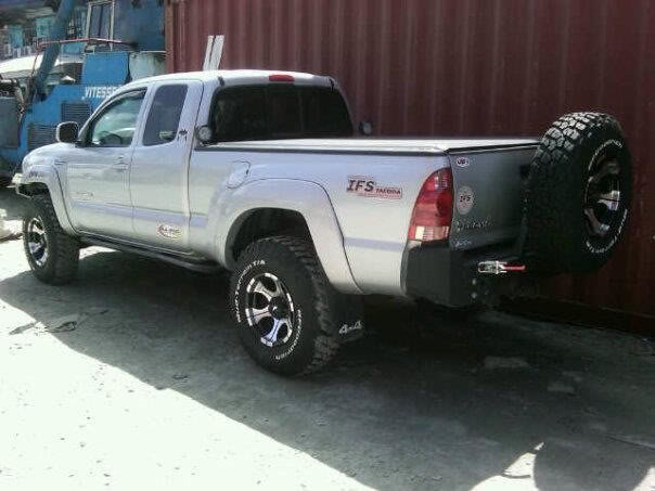

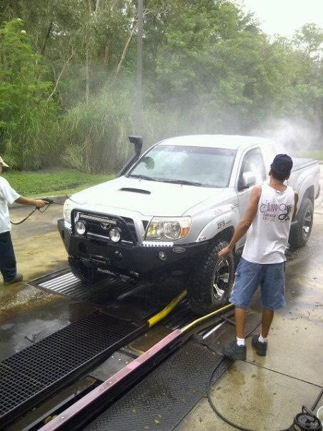

    At the port in Miami waiting to go into container for Guyana.
    Next set of photos will be from Guyana!!!
