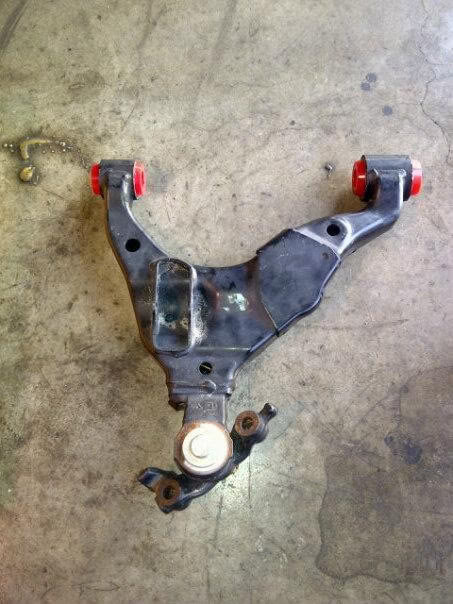

    From Australia..Nolathane part# 45574 $400.00 mailed to me in Florida when i got them or you can get new stock bushings, burn out the rubber, clean the shells and sleeve and machine a bushing out of nylatron rod..with cost of bushing and workmanship to do it cost may almost be a wash compared to $100 bucks per Nolathane bushing from AU.

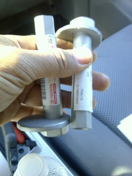

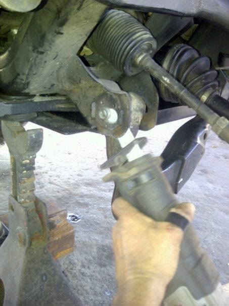

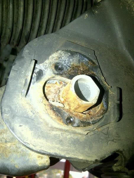

    If you didn't use anti seize in the LCA cam bolts there is a high possibility of seizure as Toyota did not put anti seize. If it does seize, the arm will have to be cut off destroying the bushings. You have a 2012 so dive into this early before it locks up on you.
    If you do nylatron bushings make sure you put in grease groves and of course a nipple. I would also leave the outer part of the bush grease free ane even glue it to the shell to stop rotation.as you just want the inner part to slide around the metal sleeve.
    You may need a new bushing to get the exact measurements of the rubber to machine the nylatron bushing.

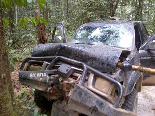

    HAZARDS OF JUNGLE DRIVING!!!! Happened yesterday in Guyanas Jungle.Toyota Hilux Pickup.
    Two of six miners were Friday night receiving emergency treatment at the Georgetown Public Hospital after the vehicle that they were travelling in veered off a trail at Issano and slammed into a tree, relatives said.
    Seriously injured are 32-year old Owen Harry of Lance* Gibbs Street, Queeenstown and another man whose only known name was James.
    The four others were treated at the Georgetown Public Hospital and sent away.
    Demerara Waves Online News (www.demwaves.com) was told that Harry sustained serious neck injury and a number of James’ ribs is broken and one of his lungs is punctured.
    He underwent surgery Friday night.
    Relatives were told that the men had been returning to a work site when Harry, who was s the driver, was seen being tossed about in the vehicle.
    One of them managed to grab the steering wheel but it was too late and the pick-up crashed into a tree.
