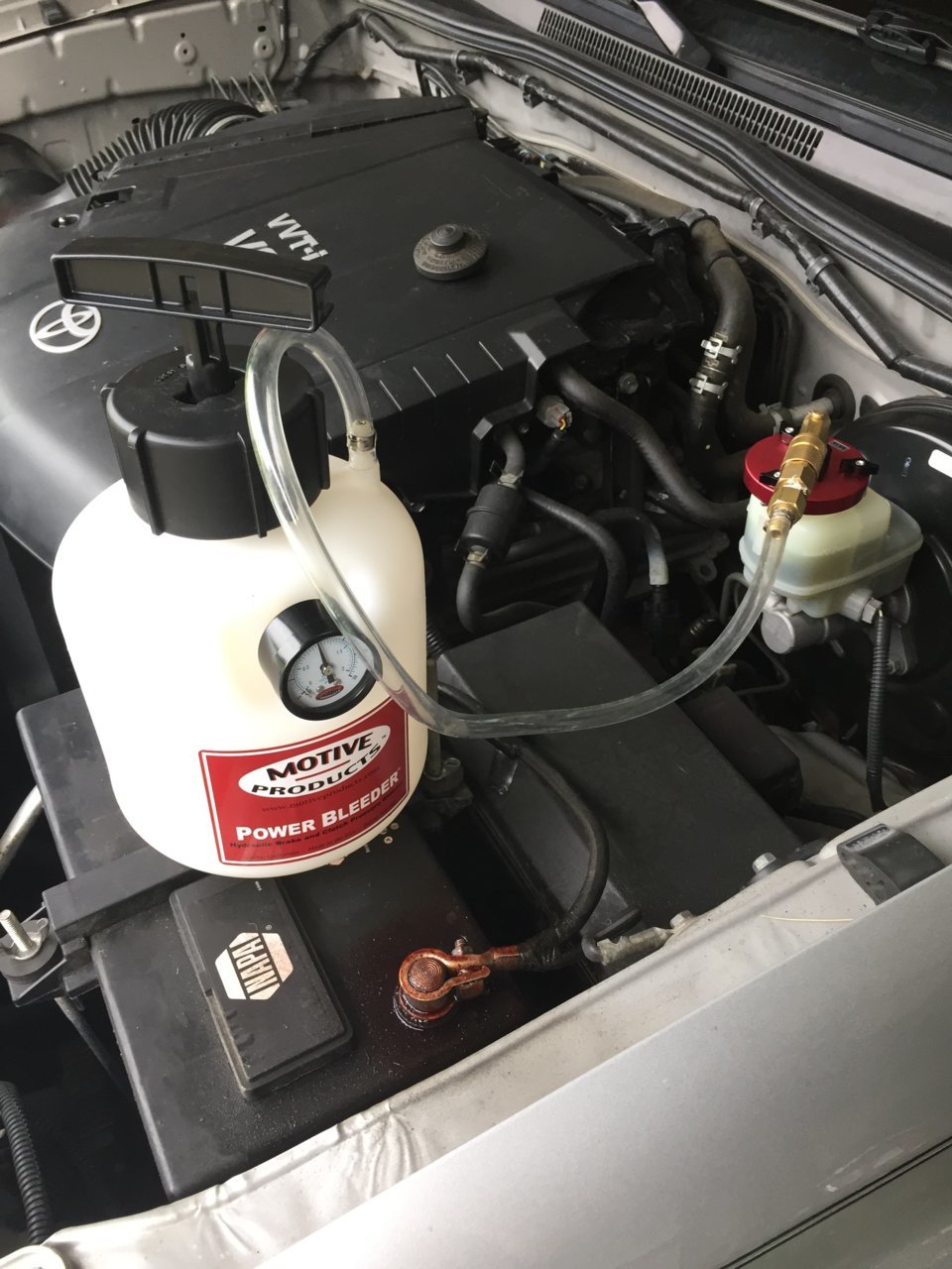

    This is how I do it
    b_r_o and Drainbung like this.

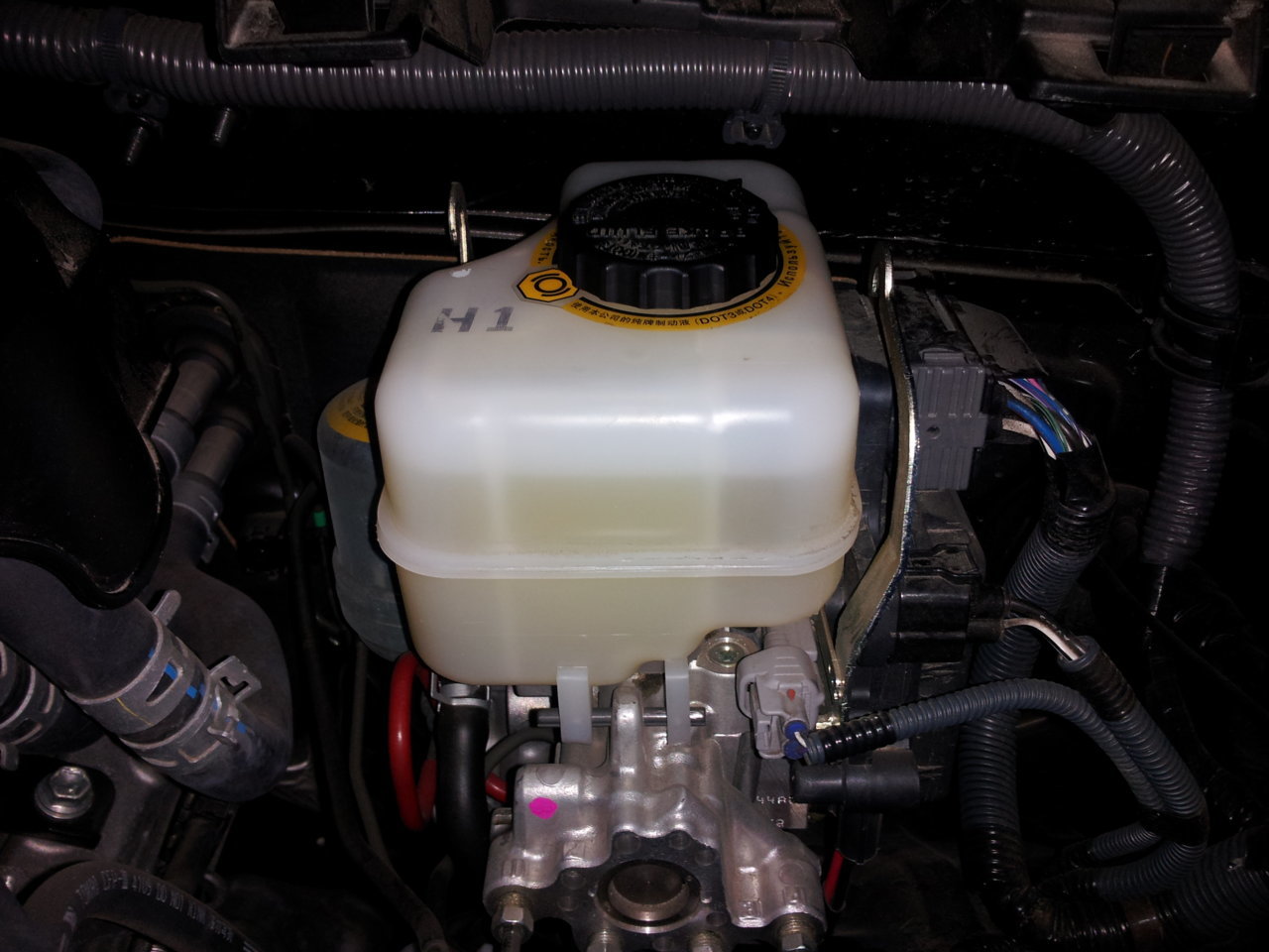

  18. Nov 29, 2018 at 1:32 PM
    #38
    Lester Lugnut
    Lester Lugnut Well-Known Member
    Mar 3, 2010
    #32477
    2,822
    N of Mex-S of Canada-E of LA-W of NC
    '15 Tacoma PreRunner V6 SR5 Auto
    If you have this, you have an electric booster

  19. Nov 29, 2018 at 5:17 PM
    #39
    joshroz2
    joshroz2 Active Member
    Jun 20, 2013
    #106712
    37
    Josh
    New Jersey
    nope. I have the round thing in back of my reservoir and what i assume is the abs is all the way on the far right past the air filter
