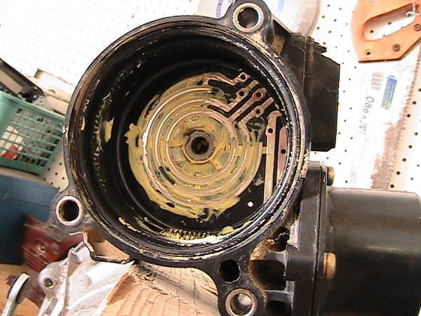

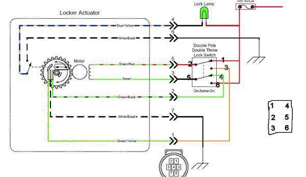

    The ADD all you need is a power switch it has internal limit switches,
    Like this
    That is an actuator for a transfer case but the front diff uses A Similar one
    Or it is vaccuum actuated
    You can wire it the same way you would wire a locker
    I think you would have to wire it, I didn't because I had the option to go with manual hubs, Which I don't think the 2nd gens have the option of.
    But i would ask on ttora they are much more knowledgable and they helped me with a lot for my conversion.
    And you shouldn't have to replace the wheel bearing unless they are bad, just swap in some 4wd spindles.

    If he buys wheel hubs they will come with no bearings on them and he can not press old ones out wit h out damaging them.
    As far as the wiring thats why I put $??? he can build his own computer to shift ADD by the switch or get factory one to do so. Either way he can not use just simple on/off switch on that it needs relay and bunch of properly connected wiring (aka simple shift computer)
