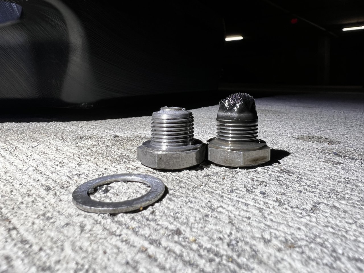

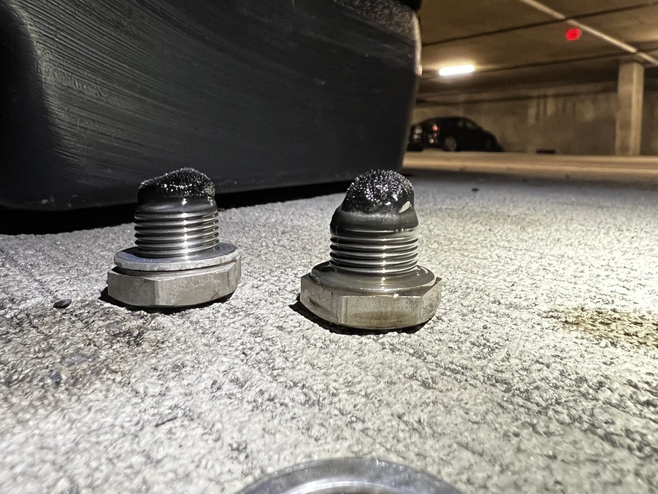

    Just thought I’d throw in an update. I just did a service on my transmission. These things definitely do their job. Kinda wish I had switched over earlier. A lot of the metal is most likely left overs from the past. Transmission has been getting a healthy Redline MT90 service @30k intervals so this isn’t neglect.

    Also no galling of threads since there was some concern of that. Between the threads being lubed by oil, and anti corrosion additives in the oil there really isn’t anything to worry about IMO
