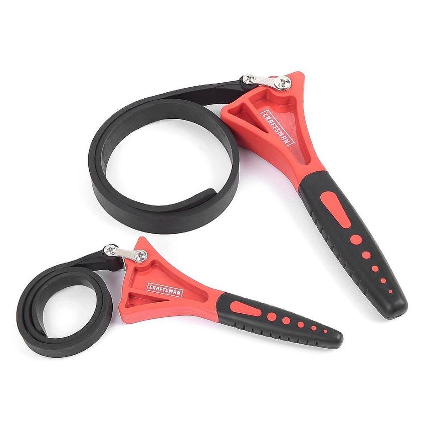

    Rubber strap wrench. Removes even the tightest filter, is not a specialized tool that has zero other uses. (Works great to open jars, hold onto pipes to prevent from spinning, etc)
    You'll only need the small one in the pic (they are often sold in a 2 pack set like this). It helps to remove the engine plastic cover (just unbolt the 2 front acorn nuts and hinge it up).
