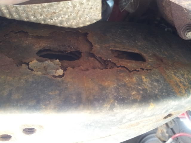

    Yep my 05 showing signs of the dreaded cancer in the same spot. Gonna try and do something aboot it tis summer.

    Its actually a lot more solid than what the pic shows even though it is separating. As for "cut and replace time" thats the plan.

    Quote:
    DoorDingGood luck. Your repair project might make a great DIY thread.
    Take it to toyota so it is documented. Last thing I would do is mod the frame and then have toyota deny any claim in the future.
    The OP got his frame replaced so why do you believe yours is not eligible?

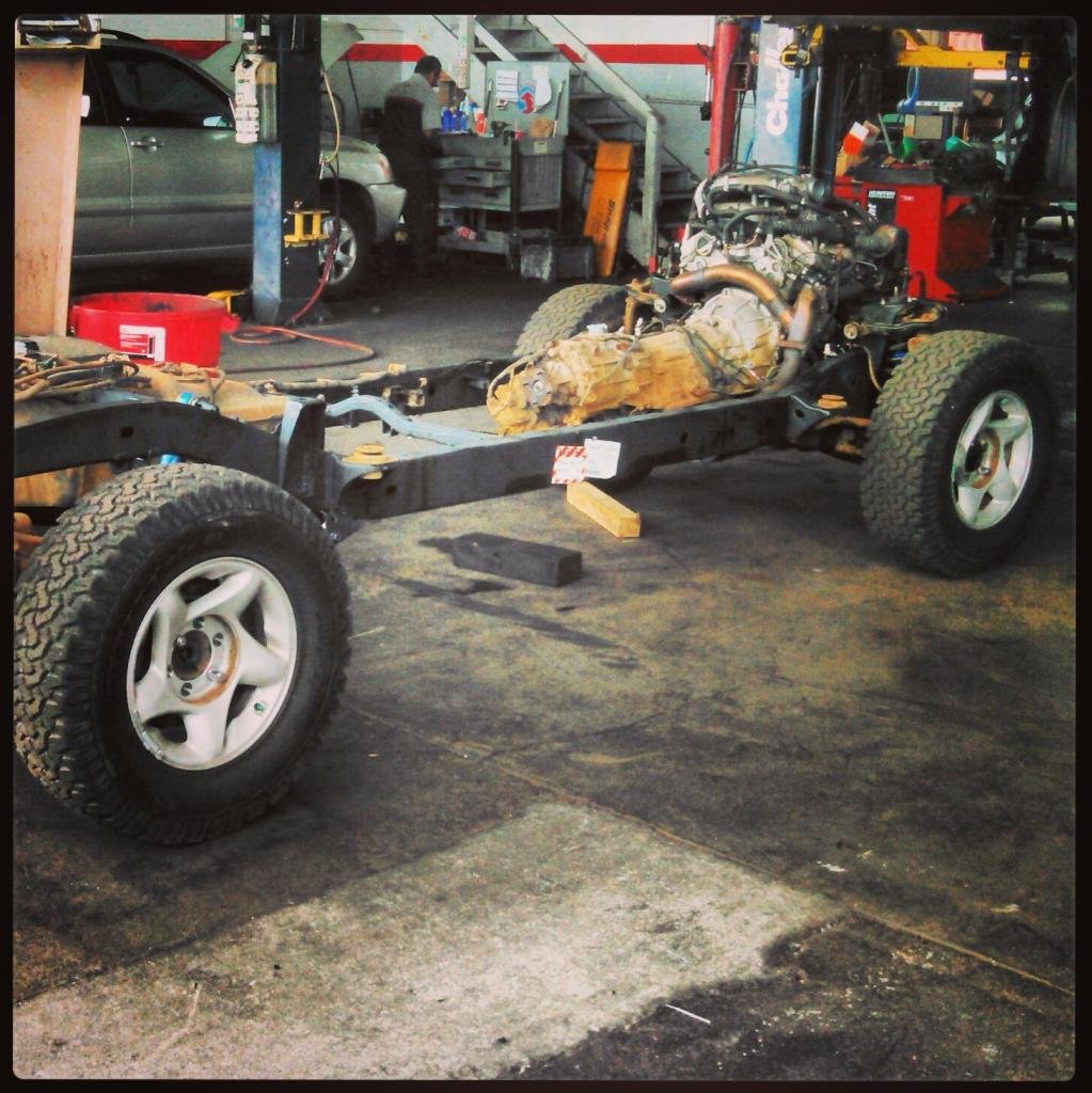

    point of clarification: our Taco was not a certified pre-owned vehicle. it was a used vehicle purchased from a toyota dealership.

    You should go to Toyota about this. At least make a try. Your truck rusted in the same spot many others did so its no accident.

    Any vehicle which is not ready to roll after the frame swap is an indication of a crappy shop, not Toyota policy.
    My shop had a lot of first generation and tundra swaps under its belt, they knew what they were doing and were attentive to any after-swap issues. The tech had me bring it in at 30 days for a bolt tightening.
    No fluids? That's an issue for corporate, the dealership management and the BBB.
