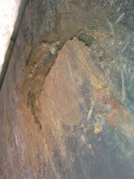

    AHH! My drivers side :mad:
    Scraped/brushed all I could out and drenched it in primer and paint.

  11. Oct 30, 2013 at 10:49 AM

    Ouch Rugged. And that's central Virginia too. The farther North you go I'll bet the worse they look.

    No point in the dealer looking... they will give me the thats normal speech. I did send out some info to Toyota corp tho.
    Yea :(

    Noticed this last night while poking around under there... Check out the lower frame seperation

    The very fact that you actually have some black paint left has me jealous.

    Im unsure what im going to do yet. Im rather curious what cause the frame to separate between the rivits... maybe ice? Thats a new one for me

    Toyota corp is having a local dealer setup an apt for me to bring the truck in. At least it will be documented.
    Better pics...

    Is this the passenger side by the muffler, mine looks similar there. Keep us informed as to what toyota says.

    I am.
    It is. The other rust spot is in the same spot at the OP's rusty cancer hole
