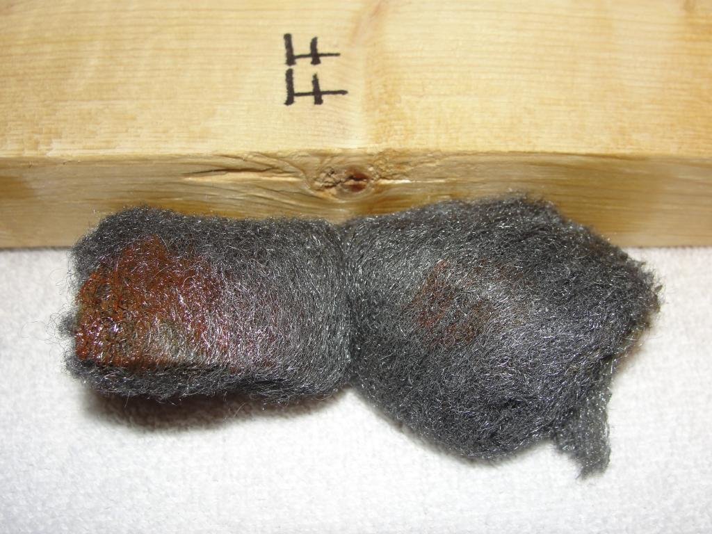

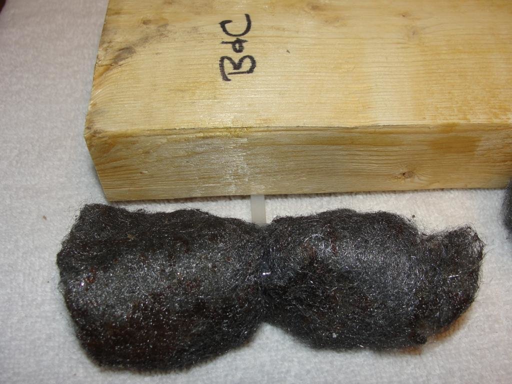

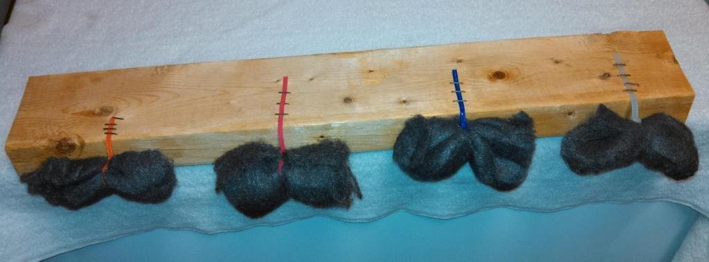

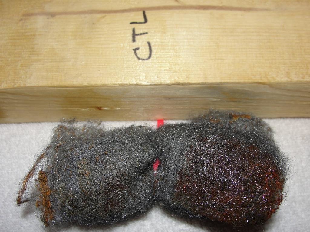

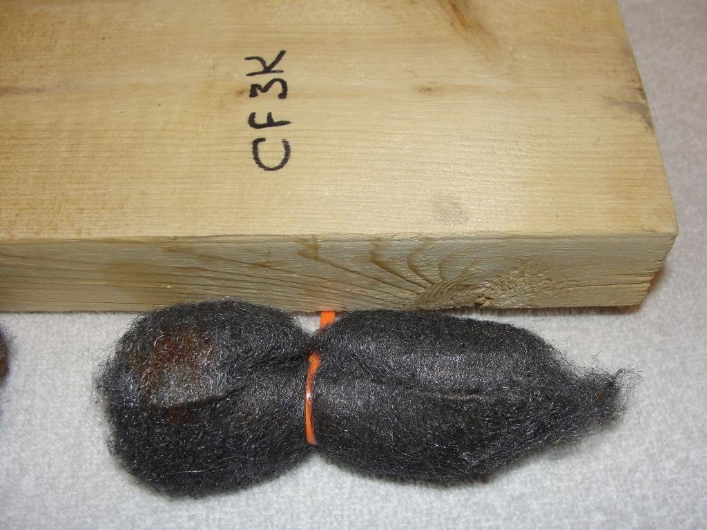

    I had not seen that one before. Somewhere around here I posted a similar test done by a guy on another firearms BBS with Eezox vs. FF. He has done a lot of testing over the years and concluded that Eezox is the best and I think his bias shows through, he claims that Eezox works better than FF. From the pictures he posted it looks like FF is just as good to me. In any event I think in the US from readily available resources FF is the best choice. The Canadian Government did a lot of testing with the military and concluded that CF 3000 was the best at rust prevention overall from what they have readily available. My hope is that CF 3000 will be as effective or more so than FF.
    To try and determine this I am using a methodology similar to the Eezox test. For a couple of weeks I have had steel wool sitting in ziplock bags of FF, CF3k, Bar & Chain oil, and a control with nothing on it. Last night I used zip ties to attach them to a scrap piece of 2x4 then ran warm tap water over each piece of wool for 30 sec. (car wash resistance). Then poured 1 1/2 cup concentrated salt water over each piece.
    They are sitting in my heated garage where the temp. is usually 38-40 during the winter. That is the temperature where the Toyota owners manual says rust occurs the fastest. And why my truck is sitting outside where it is -9 F right now. Only 12 hours later the control piece already has a lot of rust on it. I expect it will take quite awhile for the other pieces to start showing any rust however.

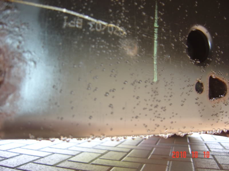

    I'm not saying it's a problem, but my initial application of FF dripped maybe 10-15 spots on the driveway for a few weeks after I applied it. I know why it did, because I laid a heavy coat on, especially in the boxed in area and in the hitch area.
    I'm sure my follow up applications won't be so bad as far as dripping, but I'd just as soon clean a few spots up off my driveway than ever have to spend a summer scraping, wire brushing and painting my frame ever again.

    I think that I will start a seperate thread in a few days on the FF, bar & chain oil, and CF3K test. While I am not in a panic yet I'm starting to think that it may be worth looking at other protection methods, at least in addition to the film ones.
    The steel wool is hanging suspended in air attached to a 2x4 sitting on an I-beam in the garage so there is no contact anywhere on them except with the air in the garage. They dripped water\brine mix on the floor for a couple of hours, I put red rosin flooring paper under them to keep the water off the floor. The paper was dry this morning. The undersides of all 4 are rusted already. The one thing I know for certain at this point is that if you have a heated garage that is just above freezing I would NOT be using your garage to park your truck!!
    Control (raw steel wool):
    Bar and Chain Oil. This is very dark rust and almost as bad as the control piece but darker. Brand is Pro Chain and ~1.5 old think I purchased it at Fleet Farm:
    Fluid Film:
    Corrosion Free 3000 Rust Cure:
    IRL the CF3K has the least rust of any of them. But I would not call any of these a winner as I don't want ANY rust on my frame. I thought these would take a lot longer to start rusting.
