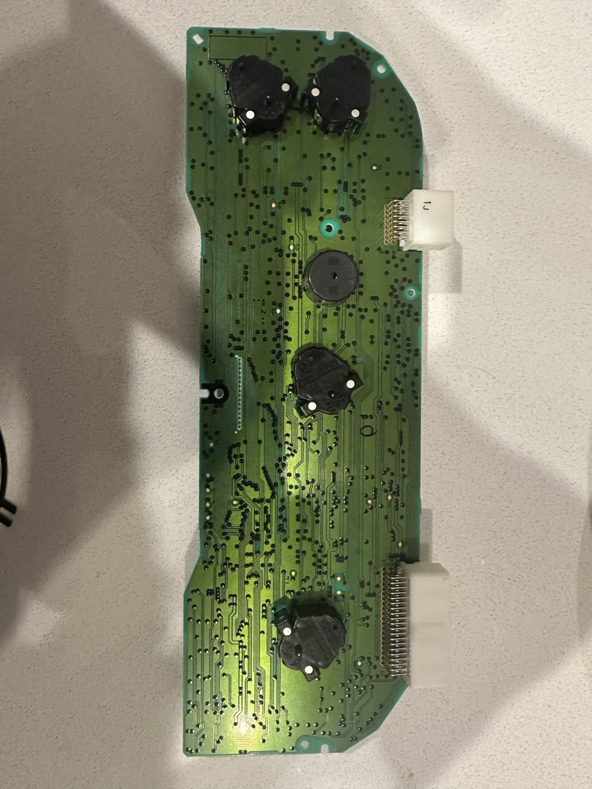

  4. May 4, 2024 at 8:48 PM
    #24
    kcx403
    kcx403 [OP] Member
    May 3, 2024
    #449079
    12
    Kyle
    2005 Tacoma 4.0 Automatic
    None
    There’s the mother board I don’t see any issues on this or the pins

  5. May 4, 2024 at 8:59 PM
    #25
    Dm93
    Dm93 Test Don't Guess
    Mar 3, 2015
    #150066
    13,705
    Texas
    2014 DC OR 6spd 4x4
    Predator tube steps, Ranch Hand grill guard, Magnaflow CatBack exhaust, Toyota tool box & bed mat, 2LO Module by @Up2NoGood, Rearview Compass/Temp Mirror, Tune by @JustDSM.
    Interesting, I really don't know what goes bad on them or where the circuitry for the SPD signal is but since a few taps usually get's them working temporarily I always figured it was a cracked solder joint.
