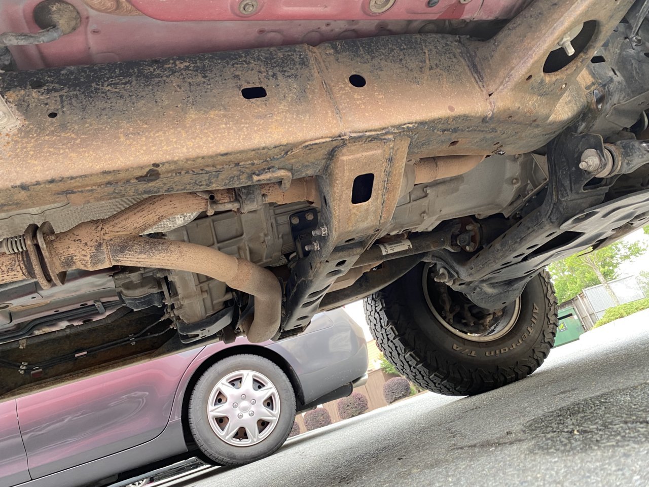

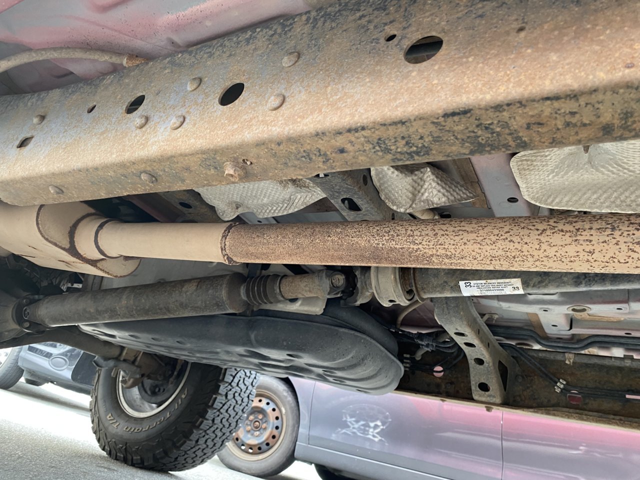

    Thank you for your time and effort writing this.
    As of rust, I don’t believe I have a problem with it.
    Here is a couple of pics (Just an general overview)
    As for prior experience, not much if any. My experience goes as far as than changing the oil, changing my brakes, flushing the coolant, and thermostat.
    As for confidence, if I’m going to be honest, low if I were to do it myself. I do have a buddy that is a mechanic for our company that said he was up for it, but I don’t know how much experience he has out of the army and he seems to be backing out. I believe I would have the time, but I’m in the barracks and got the parking lot. But there was a comment earlier that brought up the idea of going to the service members shop on post, so there is that. I also already do have the OEM gasket kit on hand.
    I really do think my circumstances are pushing me into the direction of taking it to a mechanic. I do however have a peaked interest in figuring out how to fix my own truck. I think I want to start on smaller fixs and build myself up rather that tackling this major project by myself.
