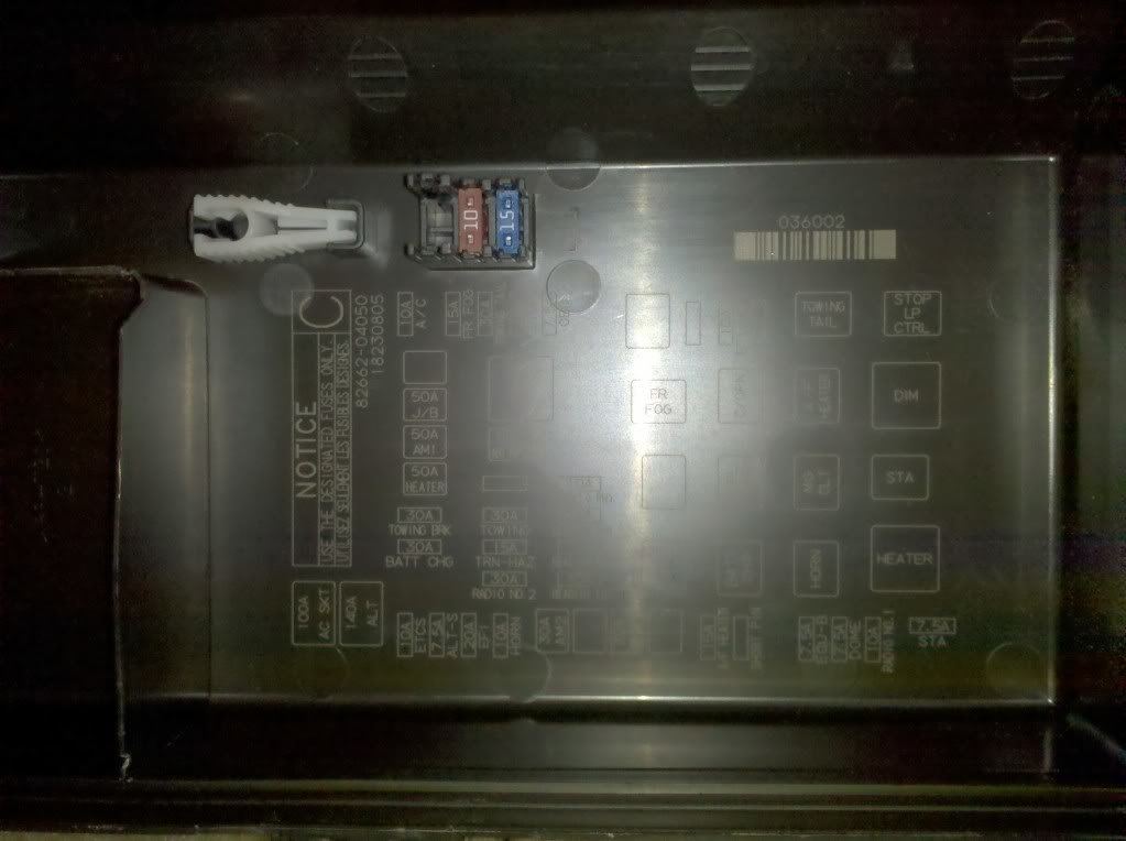

    if you look at this picture below of the ENGINE FUSE DIAGRAM:
    look at the top right just under the Notice its the very top right fuxe labels [10A] A/C...that's the fuse your looking for...its just to the left of the spare red (10) and blue (15) fuses...

    oh heck yes thanks for the pic! im gonna go check it out..

    ok just checked the a/c fuse its fine... i even replaced it with the spare 10 just for fun, and still a no go on the A/C.

    Does the green light in the A/C button blink at you when this happens? If it does odds are its the compressor clutch relay. I had a very similar problem...and it's EXTREMELY common with Toyota's, Lexus' and Scion's of all makes and models.
    The relay costs like $90 at Toyota; there are others a lot cheaper. I swapped my trailer stop light relay for it since I'm not towing anything right now and I've not had the problem since.
    In that fuse box picture, it's the one labeled "MG CLT", for Magnetic Clutch. I would never have figured that out!
