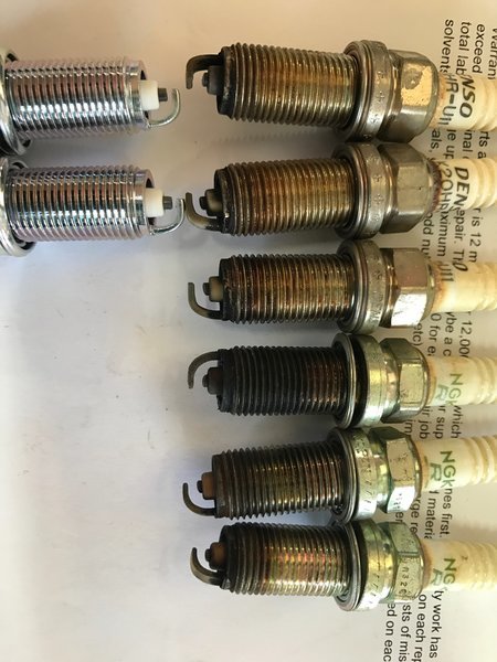

    That's typical for this motor from the factory. They look like they've got a few miles on'm... Any idea how many? Manual says 30k.

    Like @Larzzzz said, normal from factory. This is the first time you've changed them?

    BUCKLE UP! It makes it harder for Aliens to pull you out of your Truck.
    Look at the size of those gaps!

    K&n, flowmaster, plastidip, chipped, hids, daves
    Tyson would be envious

    Wee bit worn

    Original spark plugs! 12 years old wow

    Yeah never been replaced!

    Well, you got your moneys worth. Edit: I bet that MAF sensor looks like the Luray ;) Caverns

    I bought the truck a couple months ago. Had been running fine until recently

    Just did a 30k service. From the looks of it you already had the new plugs. But the 4.0 seems to like these....

    IKH20 NGK iridium's are well invited by these motors too apparently.
