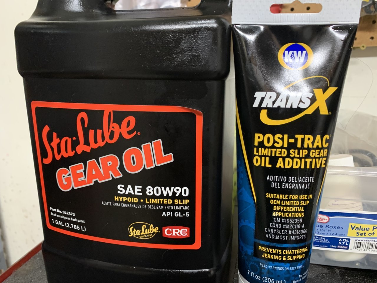

    36CAA9D7-C36F-4B6E-9321-C0922CA79284.jpg for my prerunner, i change my diff gear oil to synthetic gear oil with LSD addittive, after ward run for few miles, develop chattering during backups and cornering... i flush it again and change it to conventional mineral gear oil with LSD additve. chattering and shimming disappear

    i just bought a used 2008 Prerunner with 110,000 on the odometer. yeah the oil is totally black. change it with 3 quartz of synthetic 75W-90 gear oil with one bottle of LSD additives. Note: a sticker on the differential box is "LSD oil only". with this in mind, a synthetic is better.. so i did, after that was done.. run it a few miles, it develops a shimming and chattering as i back up and even in cornering... read the manual again, nothing it mentions about synthetic gear oil. results, i change it with Sta Lube conventional gear oil and a bottle of Tranx Posi-Trac LS gear oil additive.. resullts , shimming and chattering dis appear.. Synthetic gear oil doesn't work on limited Slip Differential... it works ... learn a lesson...

    thanks P16.... i'm feel better now, ohh the dealership also check my VIN and they come up with few recall, replace the lift spring Assembly (4spring in a pack) at no cost to me...
