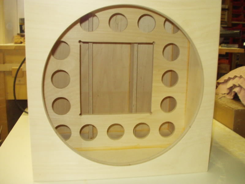

    i have seen it before but never asked... what is the purpose of the internal holes in this box.

    That enclosure needed to be as light as possible but still not flex so I built it from high quality 12mm multi ply birch and the center piece is a brace with the holes drilled out just to reduce the weight a little more. :)

    Very interesting, you do some great work and thanks for the how to. I have more experience with fiberglass sub boxes and think im gonna try going that route, but i might hit you up at your number before i do. thanks again
