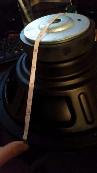

    Hello Marv,
    Is it possibly to fit 2 mtx 12's that need at least 6 inches of depth in the box to fit in a 2008 double cab?
    all of the boxes iv found online only go around 5 inches deep maybe a tad more.
    Thanks!

    Unfortunately that would require use of a plasma cutter Brian! :eek: Seriously though the mounting depth is not set in stone rather it is determined by the basket size/shape, magnet size shape and those are too large as well as too deep.

    Hey there Marv, here is a pic with the measurement, am i still buggered?
    manethon is checking into it for me as well.
    You guys are awesome.

    Unfortunately it looks like those would require repositioning of the rear seats in order to fit.

    You could always cut out a rectangle on the back wall of your box where the magnet is hitting and patch with a thinner material such as plexi glass.

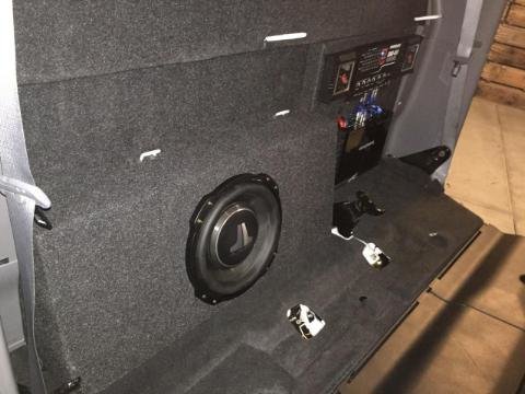

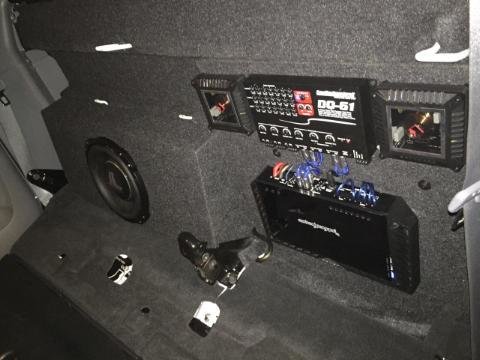

    Just thought I'd share my setup in my Double Cab Tacoma. Running (2) Powerbass Shallow Mount 12" subs and full component system in front and rear doors.
