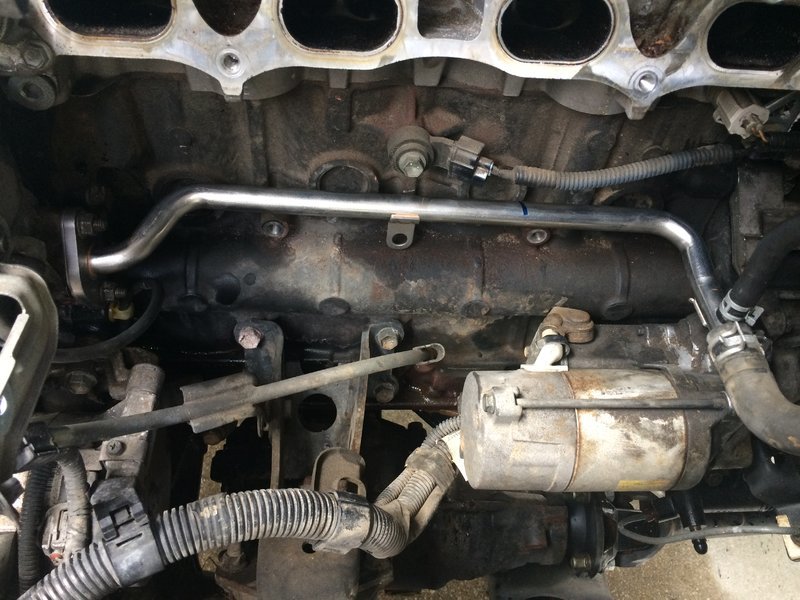

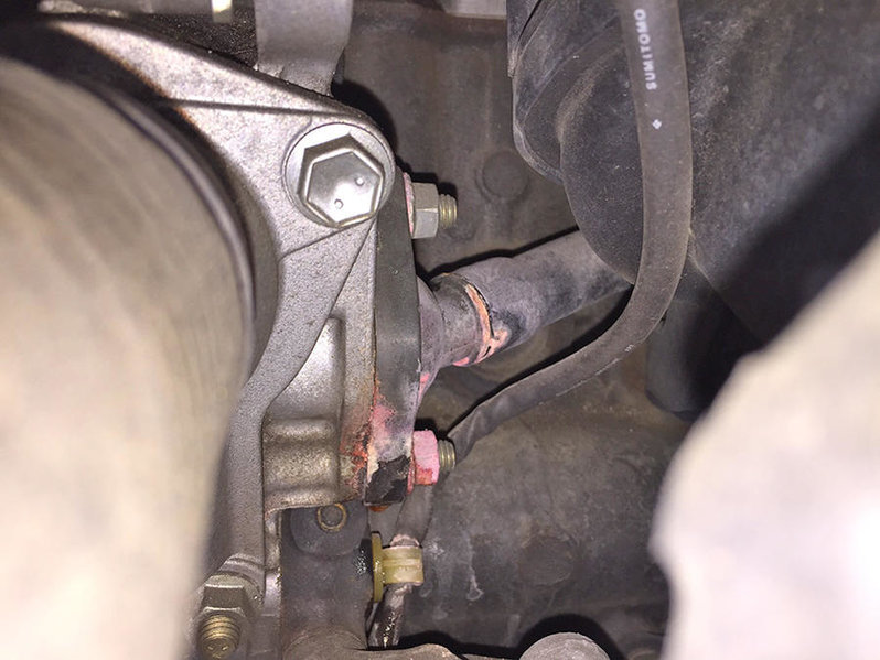

    It is probably the plastic coolant bypass pipe that runs behind the Intake manifold. The intake manifold has to be removed in order to install the replacement pipe.
    The leak is probably here:
    This is the new steel pipe:
    If you get the new steel pipe make sure they give you the correct gasket as it is different from the original plastic pipe that uses a rubber seal ring.

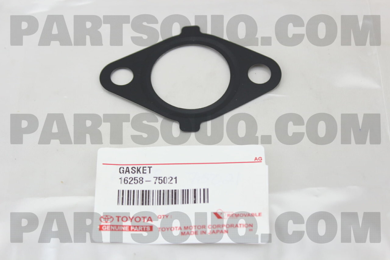

    Pipe Part # 16268-75110
    Gasket Part # 16258-75021
