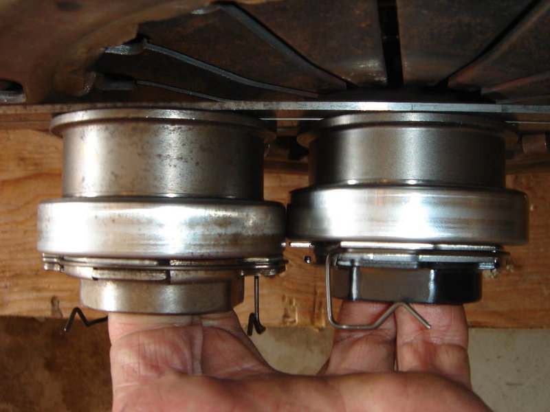

  18. Mar 25, 2017 at 2:18 PM
    #58
    Powerwagon896
    Powerwagon896 Member
    Mar 23, 2017
    #214121
    10
    Dan
    2010 Tacoma Access Cab TRD Off Road 4.0 6-Apeed
    It looks like trhey may have done just that. See picture below.
    I've been trying to find the thread that showed pictures of the TSB throw out bearing, slave cylinder and fork stud. While the SC push rod is longer and the stud for the fork is different, the TOB is also significantly shorter/thinner.
    The way I read the TSB, the fork stud and thnner TOB are to be tried 1st and the longer sc is then employed as a last resort if the fork stud and thinner TOB fail to fix the issue.
    HERE, I FOUND IT.
    The link above shows PIX of all the components. Here are the old (left) and new (right) TOBs.
