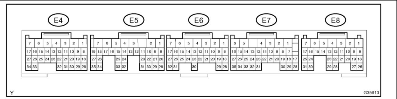

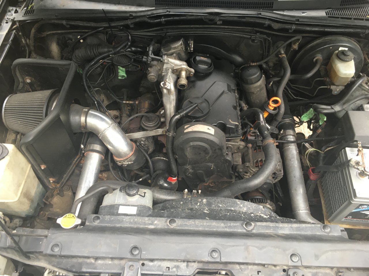

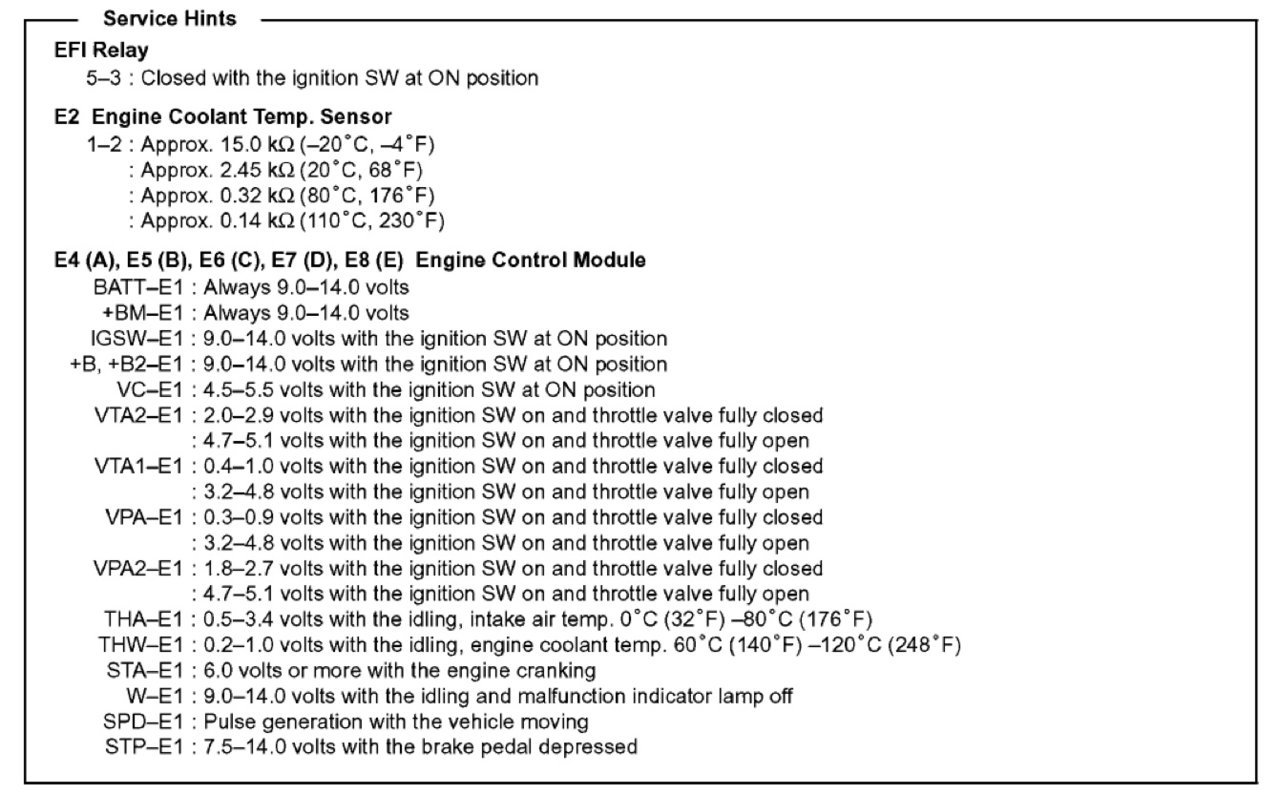

    I am pretty much finished swapping a 2.0L Volkswagen TDI diesel engine in my 2005 Tacoma. Custom adapter plates, intake, exhaust and wiring harness. The build thread is over at the TDI Club website https://forums.tdiclub.com/index.php?threads/2nd-gen-tacoma-bhw-swap.516662/#post-5675802 All I have left to do is tidy up some of the electrical wires, install an electric rad fan and get the gauges working.

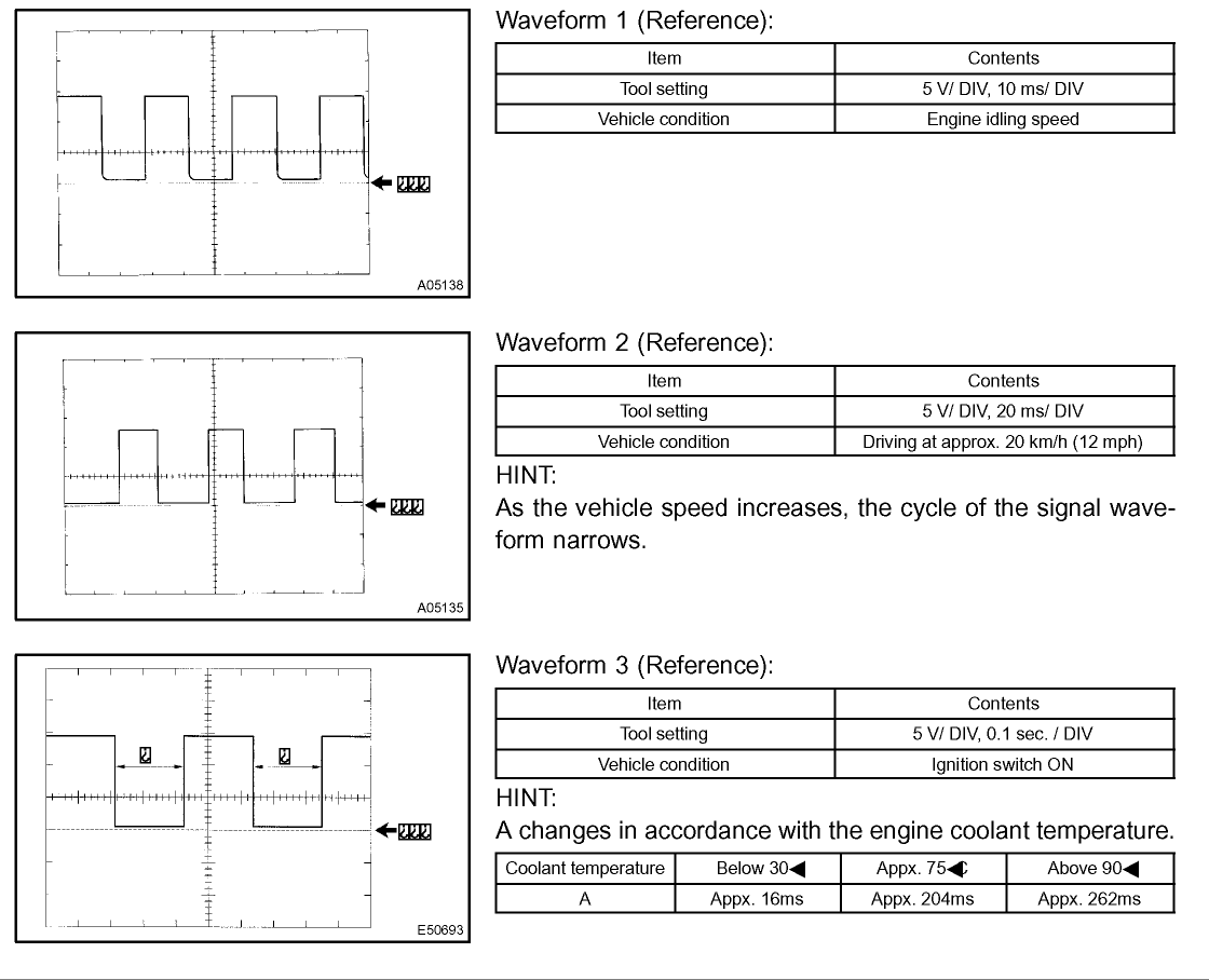

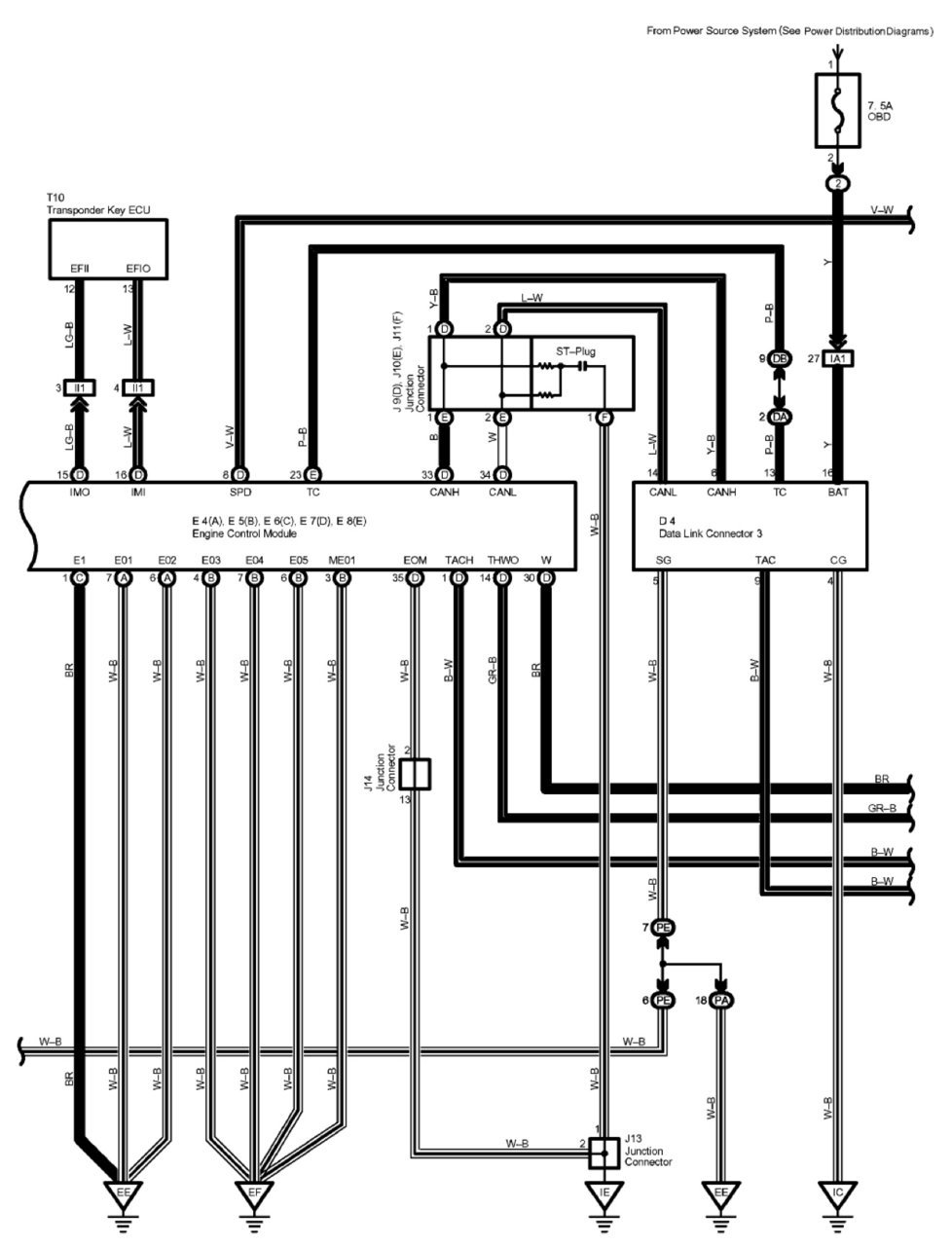

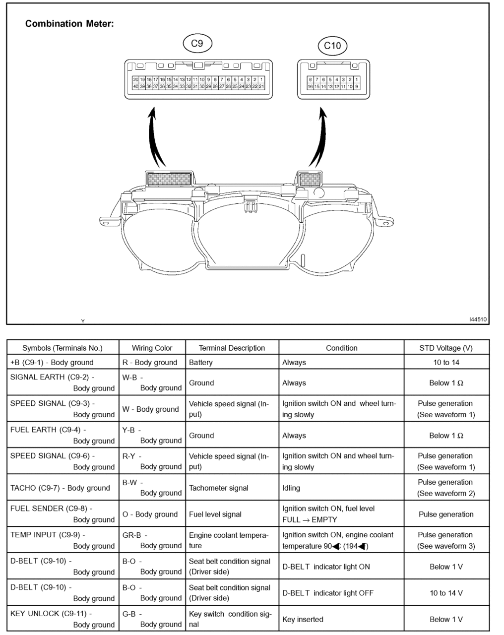

    I am currently working on getting my temperature gauge working and I know the temperature gauge on the cluster needs a 12v square wave signal. According to the Alldata manual the frequency the gauge cluster requires is
    Below 30degC 16ms between fall and rise
    75degC 204 between fall and rise
    Above 90degC 262ms between fall and rise
    I’m not sure if the valve is a changing frequency or if it is a PWM duty cycle.
    Since I now longer have the 1GR-FE or the Toyota ECU. I am wondering is someone with an oscilloscope and a 2005 - 2011 Tacoma could give me some more accurate frequency readings relative to engine temperature. The wire that goes to the temperature gauge is connector E7 pin 14 on the ECU, grey and black wire.

    I got my temperature gauge working. I had to develop my own conversion module with printed circuit board and program it because the Tacoma cluster requires a specific PWM signal to operate. The signal is supposed to come from the Toyota ECU but I no longer have that in my truck. The Tacoma Temp Gauge Converter reads the resistance on the instrument cluster part on the VW coolant temperature sensor and sends a PWM signal to the Tacoma cluster.
    The Tacoma Temp Gauge Converters are available for purchase for $200 CAD if setup for a VW TDI BHW coolant temp sensor or $250 CAD if setup and shipped with a 1/8” NPT sensor with 10’ leads. Shipping is included in the price. You could use this converter with any engine swaps on 2005-2011 Tacoma, such as LS or 4BT swaps. This converter may work on Toyota FJ Cruisers or Tundras but I have not tested it.
