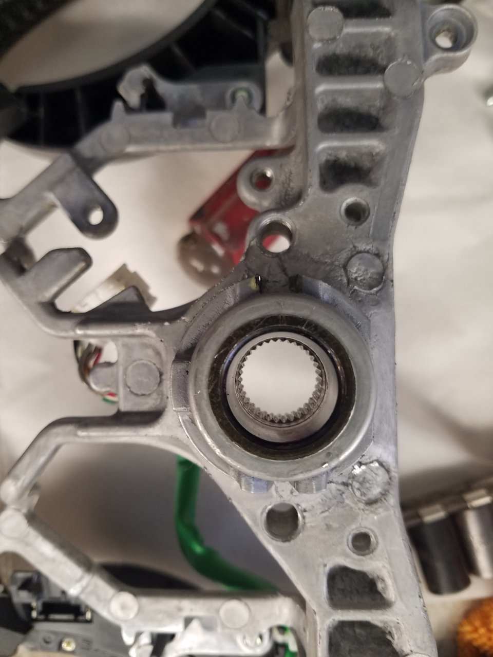

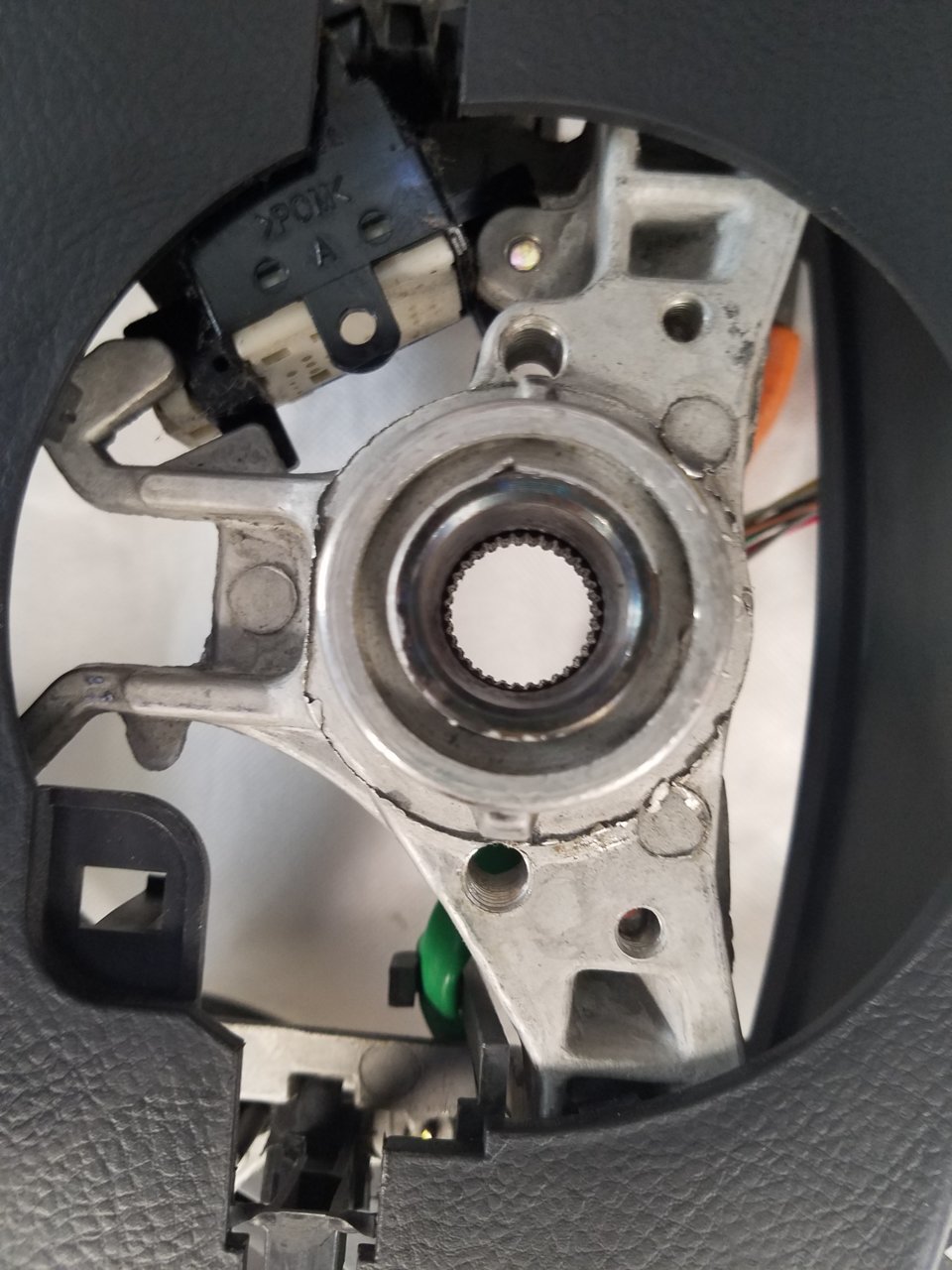

    I ordered the 03 -09 4runner one from Ebay like the one you got posted . Clock springs are different so back of wheel is different.
    4runner on top Tacoma on bottom

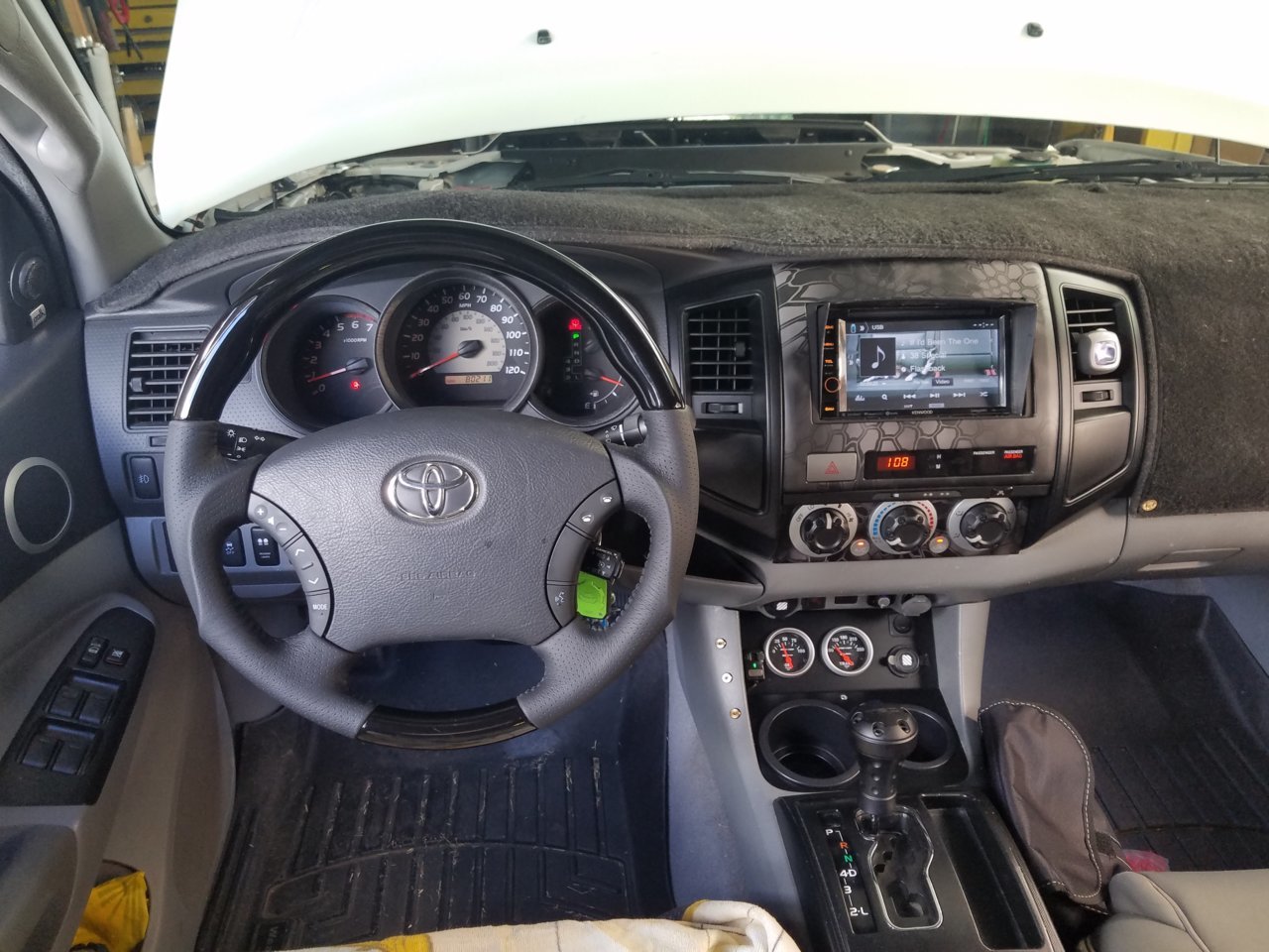

    Ended up shaving the 2 tabs in center on 4runner one and used JB epoxy putty to build up sides like the Tacoma one . The 4runner wheel is a snug fit into the Tacoma clock spring so might not have been necessary to build up with the epoxy puddy .
    Just letting you know about the difference in the wheels and what I did . Been over a year with no problems.

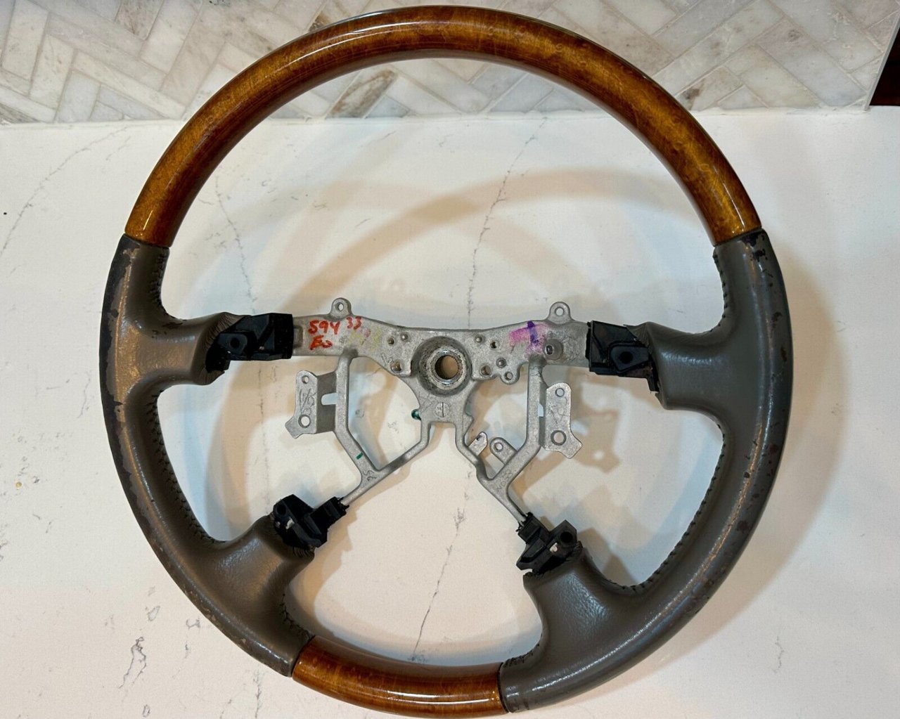

    My search indicates a gx/ls Lexus 470, land cruiser 100 are 100% interchangable. Seemingly bolt over. They both seem to have grey leather and woodgrain. I think the land cruizer may also have perforated leather?
    The avalon has grey/wood but and appears to be the same base structure. Where it changes is the coveŕ and swithes that attach are different. Ebay new units prices are considerably less for the Avalon than most other models??

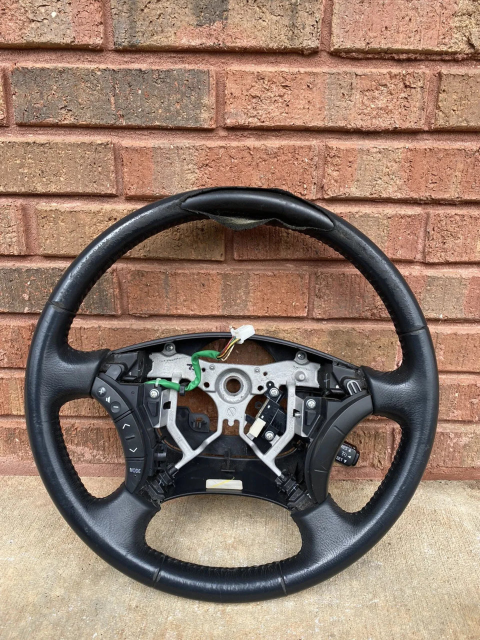

    My son changed his 08 tacoma to 15 and had to mill the steering wheel but he can't remember the exacts
    05 -15 wheel
