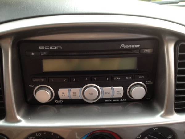

    as long as you get the right harness and dash kit its not to hard. well unless you have a JBL system then The factory amp usually causes issues. i ended up using a scion deck. plugs right in to non jbl systems and has more power and ipod hookup in the back.
