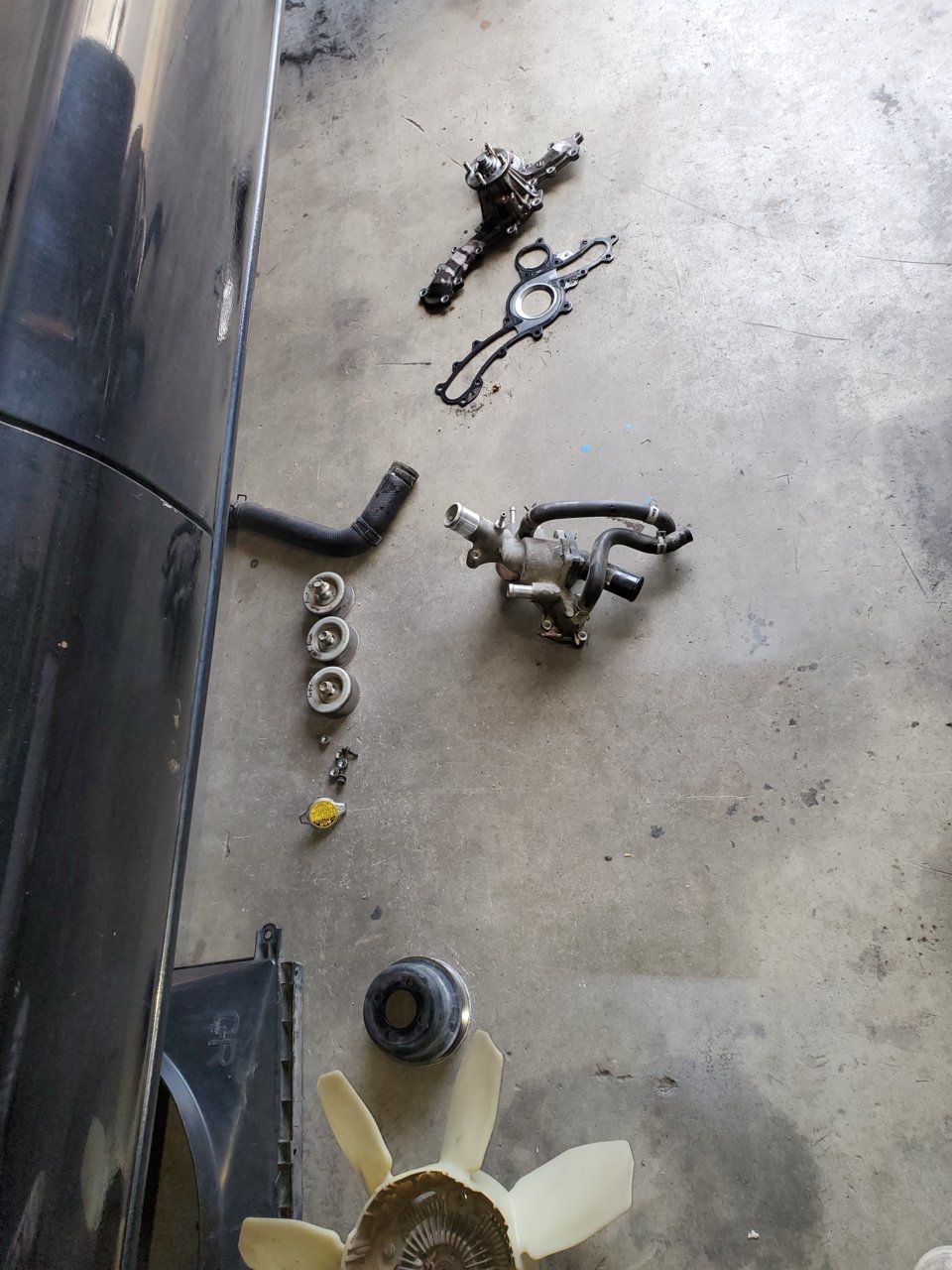

    The water pump arrived today. The old water pumps bearings are wasted, I don't understand how it held any water, or why it was relatively quiet for a bad pump. Either way it's getting done today.

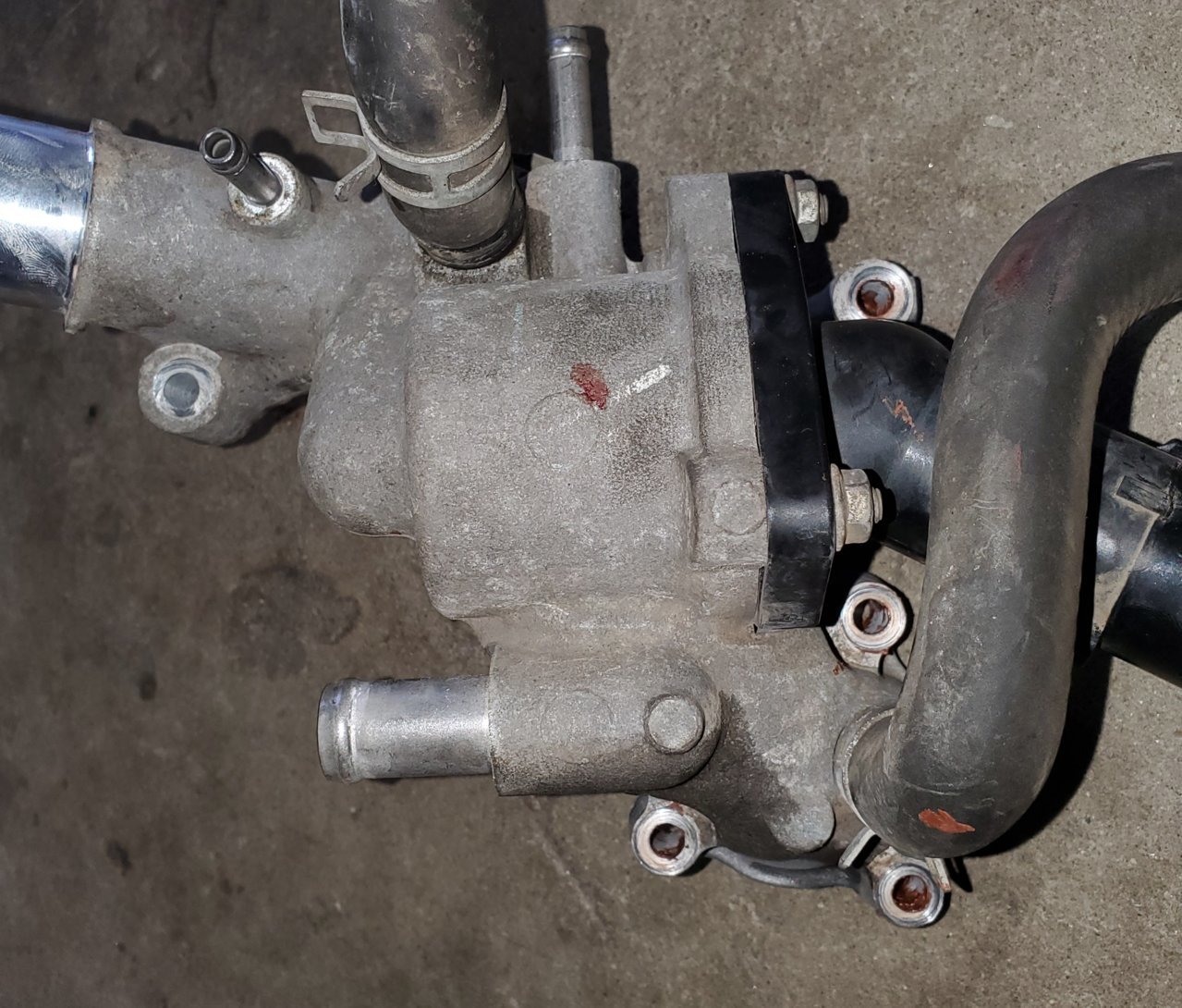

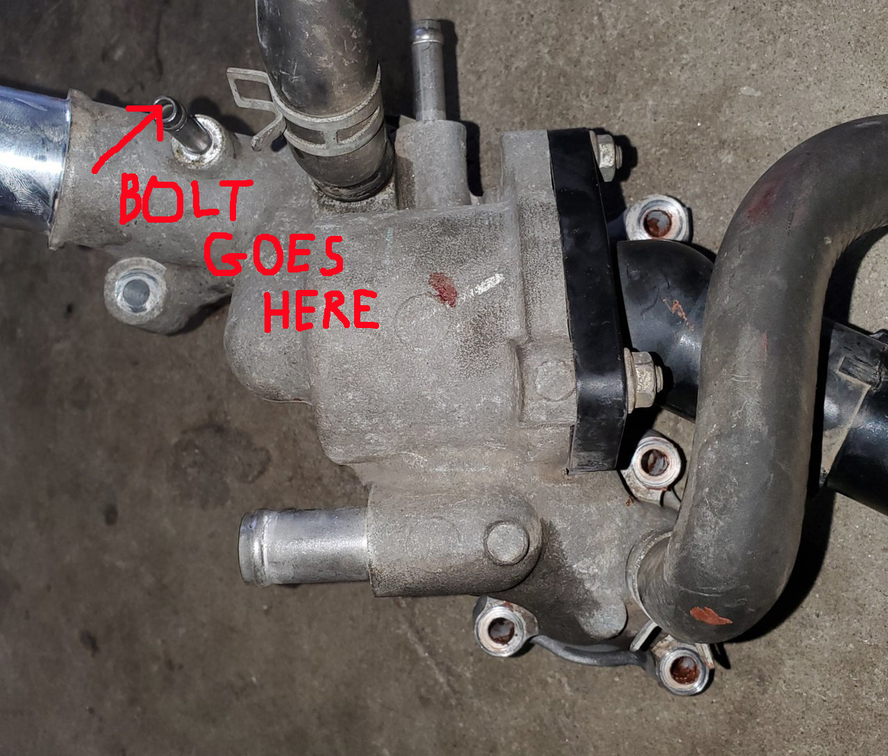

    I have an extra bolt. There's a housing between the water pump and the thermostat, I don't know what it's called. If I don't know the name of it I can't find it on the internet. I type in thermostat housing and all I see are thermostats and the housing I'm referring to, but the pictures are always in a useless to me direction. Phone won't stop ringing either, calls and texts. I'm getting upset from distractions and this one bolt that I don't know where it goes. Technically I know which part it holds, it holds that housing, but I can't find a unused hole for it. Frustrating...

    Turn off the phone, take a break, and find where it goes. You're almost done.

    Put the phone on silent. Drank half a beer. Took that housing off and took a picture just in case another idiot like myself runs into the same damn thing.

    edit: that's not blood. It's silicone used sparingly in the bolt threads. I had to remove the pump to find the hole, lol, and the silicone was fresh and getting everywhere. It got cleaned up;)

    I couldn't find the hole under the B in BOLT. It could have bit me.

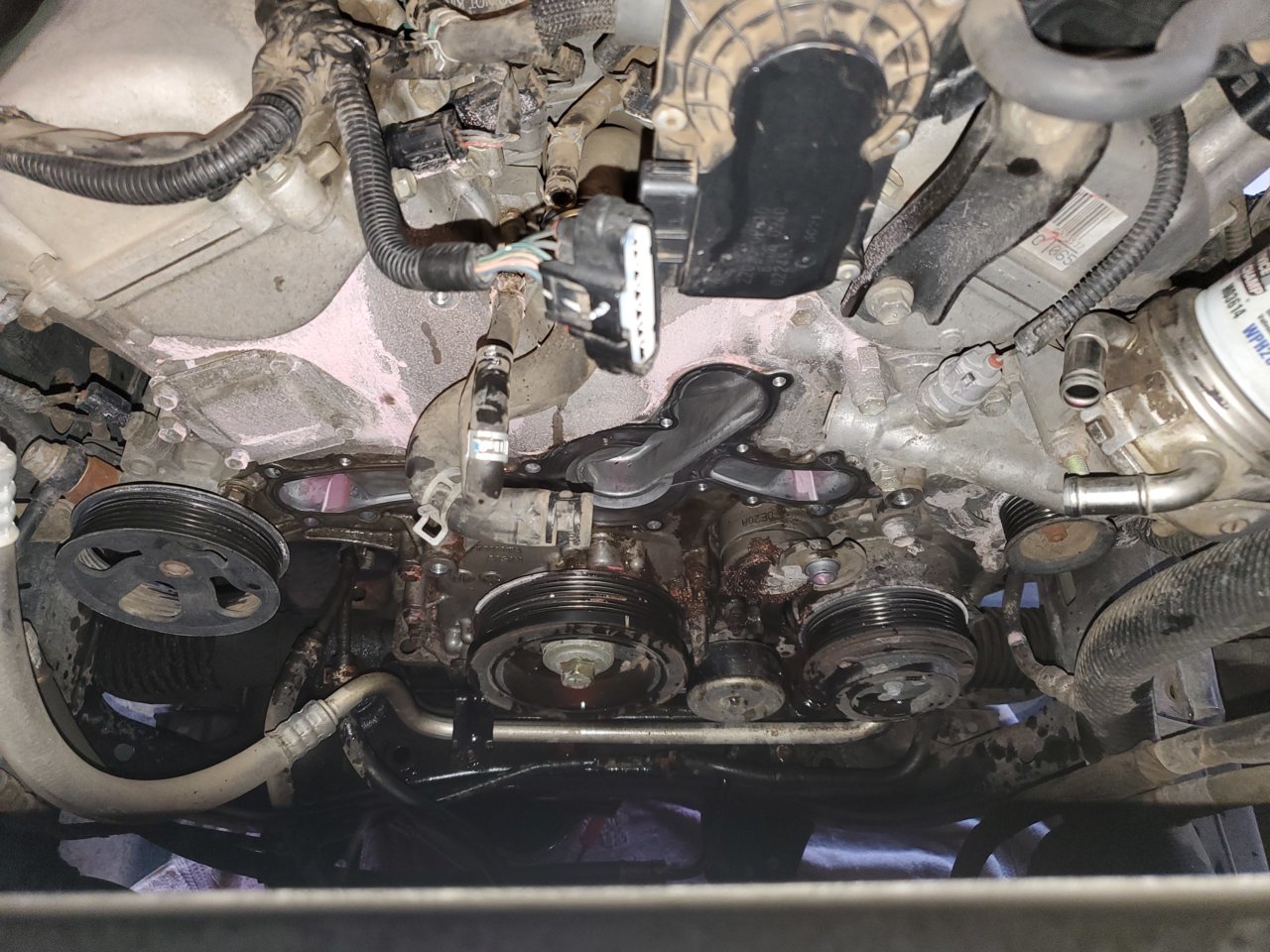

    Good tip. That pink antifreeze builds up like crazy from a leak.
