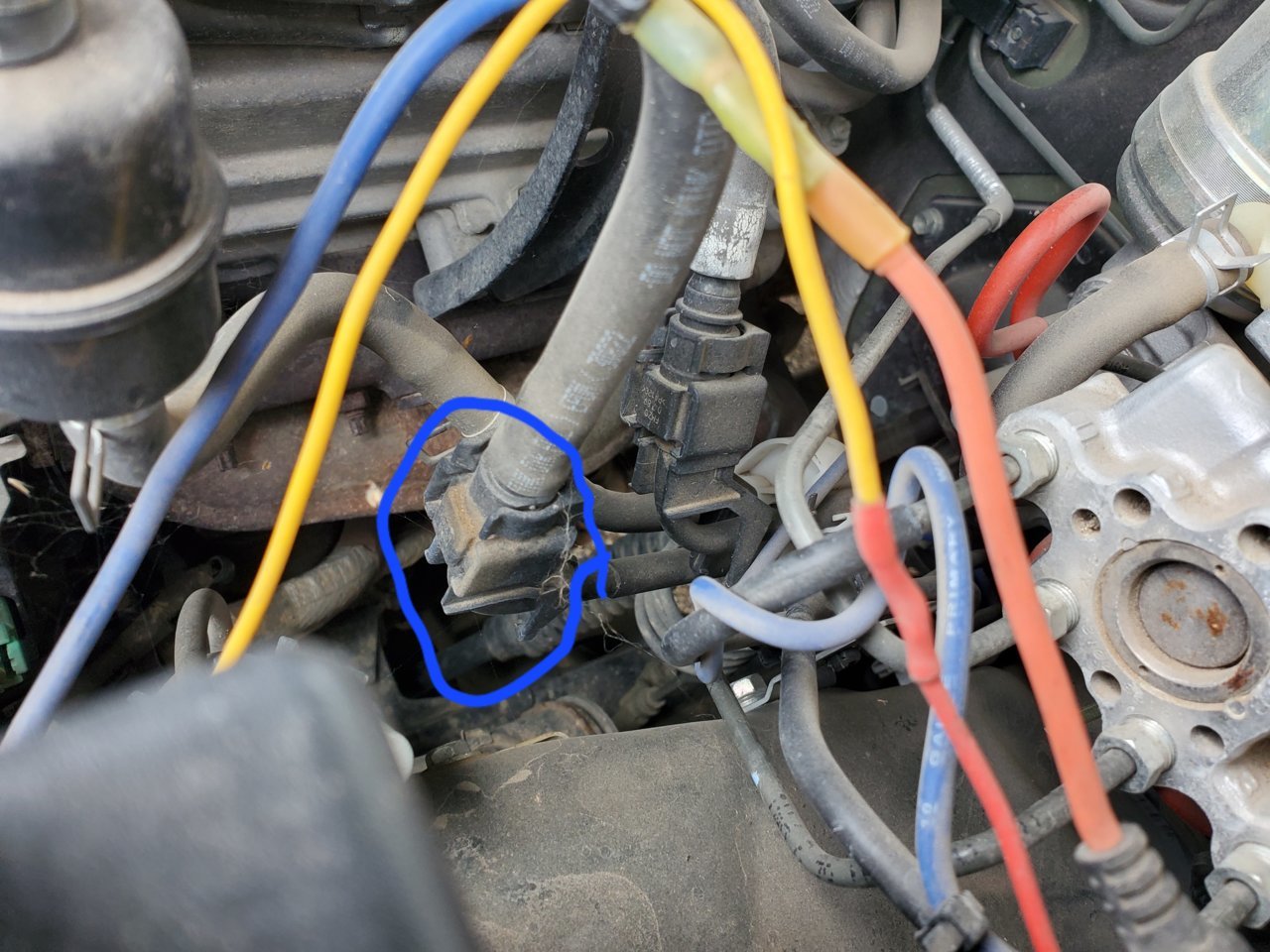

    Dm93, is the attached picture belonging to 2006 4.0 L Tacoma? Is it on driver side?

    It's on my 14 but 2nd gens are all in the same spot, yes it's on the drivers side near the brake booster.

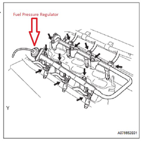

    Fuel Flow:
    Tank >> Filter >> Pump >> Fuel delivery tubing >> Fuel Rail >> Fuel Rail Regulator ( Set to ~ 40 - 41.7 PSI) >> Return to tank.
    Fuel Pressure Regulator:

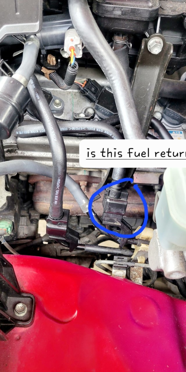

    Got the Betooll today. I did the T to the fuel line it read 26 psi, I know it's way too too low, I step on the gas pedal pressure gauge stays the same then it lower just a little once gas pedal released. Turned off the engine. Check the T connection I see a bit of gas leaked at Betooll end. Got it corrected
    Tried second time the pressure was read 20 psi, stepped on the gas it jumped to 25 psi then come back down to 20 once gas released but as soon as I stepped on the gas I heard a short burst of air blowing and engine hesitating. Turn off the car. The gauge pressure still read 20 psi. Come back about an hour it dropped to 15 psi.
    I am thinking short burst of air that is telling me the vacuum line open somewhere.
    I am wondering 2006 Tacoma has a fuel pressure regulator outside fuel tank? So I can check for vacuum line at fpr.
    In attached picture Is it the return fuel line?
    Thanks in advance for any suggestion.

    Left is feed, right return. Test the left one.
    If I recall, the FPR vacuum line connects to the far back of the air cleaner box.

    Yes the regulator is on the rail, the regulator increases pressure as vacuum decreases so I wouldn't suspect a broken vacuum line.
    The slight increase in pressure is likely the fuel pump going to high speed when you rev the truck.

    I posted an image of the fuel rail and regulator above...
