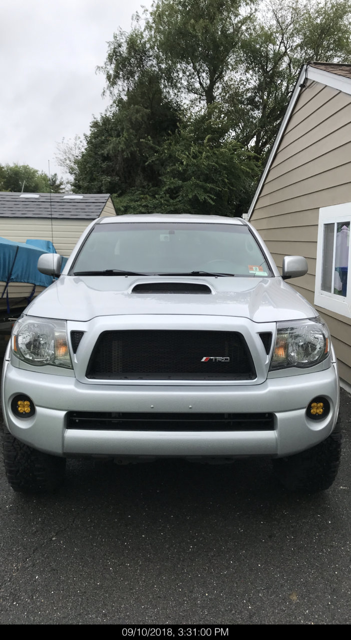

    I would highly recommend getting oem replacements. For your money it’s your best investment. The Toyota engineers know what there doing when it comes to the headlights. If you take care of the new ones if you get them they should last another 10 years. I replaced both of mine in the spring and i cleanbthem with plexus and protect them 303 aerospace. From experience with low dollar headlights they get condensation in them.theres a member on here (gully) I think who can get you a good discount on oem parts i believe he works for a dealership 6385198B-0BD0-42DE-8CE3-C301A72B4740.jpg

    Let me answer your question with a question. How picky are you about headlight performance? If you're not very picky and / or cannot tell the difference, you can buy any number of aftermarket headlight housings, try to seal them up to prevent condensation and call it a day. You'll also save a decent amount of money up front. On the other hand, you'll have to endure poor light (pattern) quality, possible condensation and early lens degradation (oxidation). That's the sad truth about virtually every aftermarket headlight housing.
    Or, you could spend a few extra bucks up front and buy OEM headlight housings - either new or used. As has already been said, there are very clear (no pun intended) reasons why the OEM lights cost more money up front. In my extensive experience though, they're well worth the price. Your choice.
