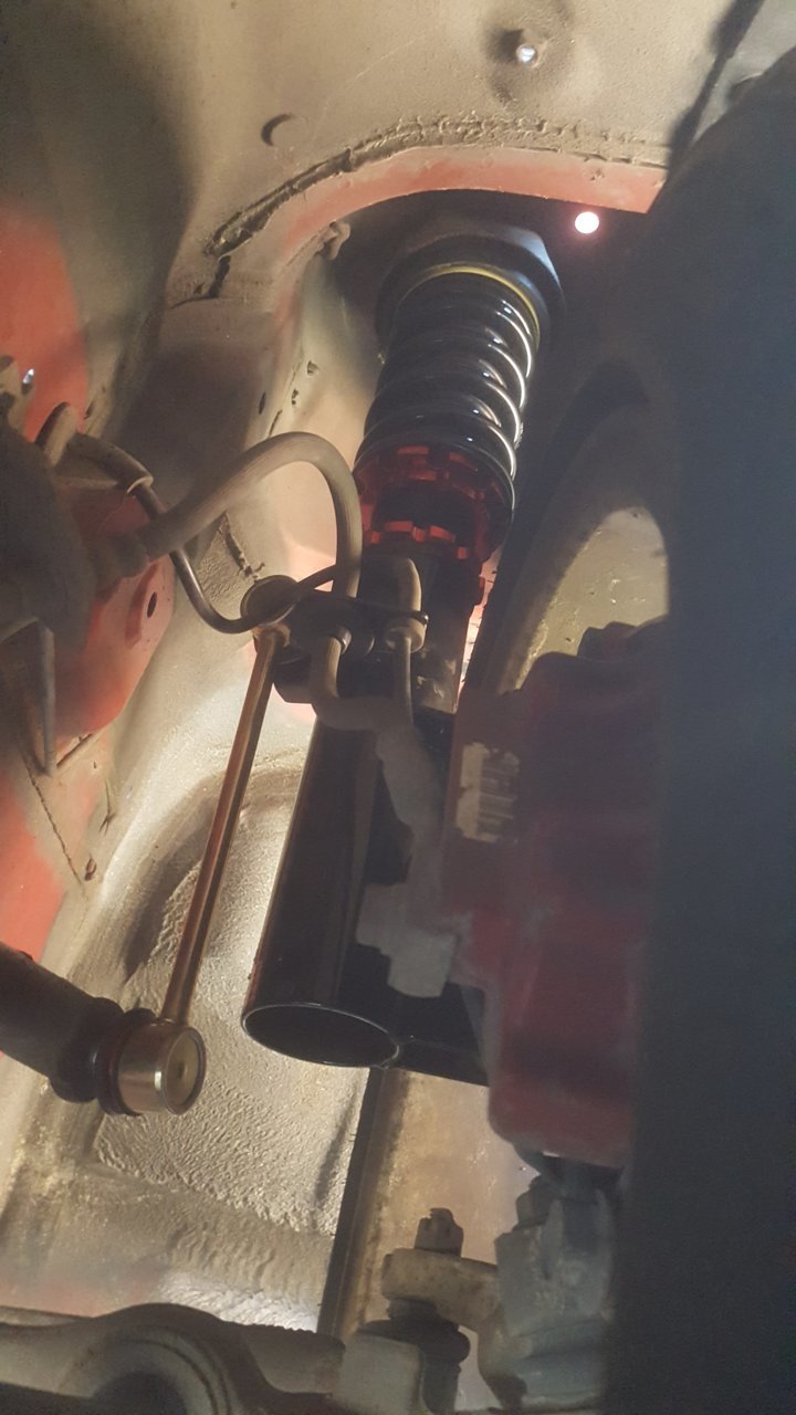

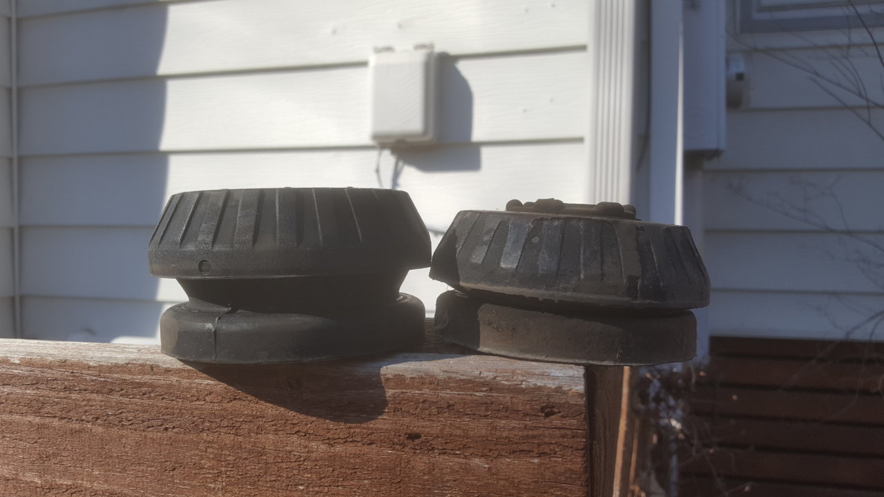

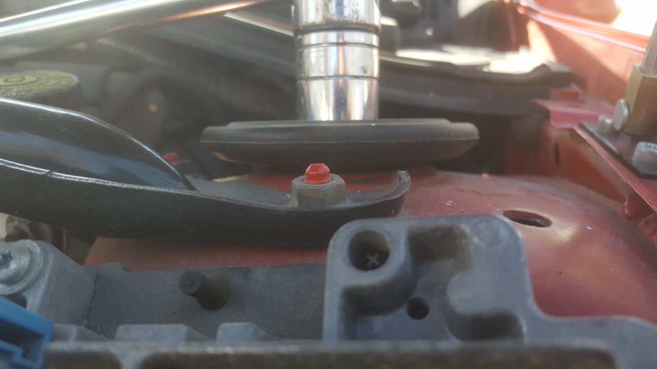

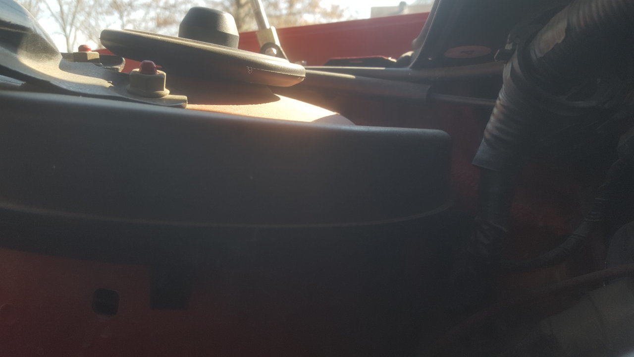

    jeez that sucked swapping front springs and upper bushing mounts but its done. the old bushings were definitely shot. im going to drive the car around for a day or two and then ill snap a side-shot since i think they need to settle first. the first pic shows how compressed they were which would technically allow the shock to move up and down and side to side some. the second and third show the top hat sticking above the strut towers.

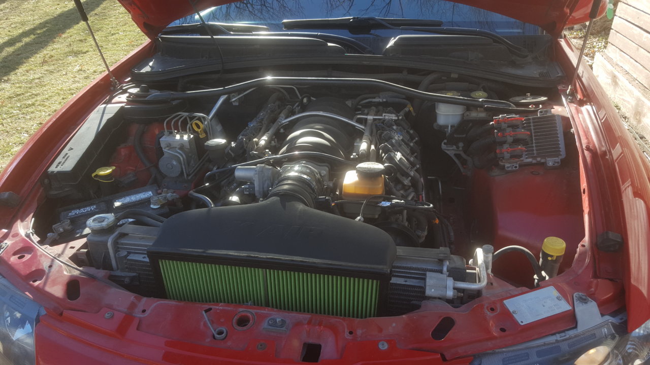

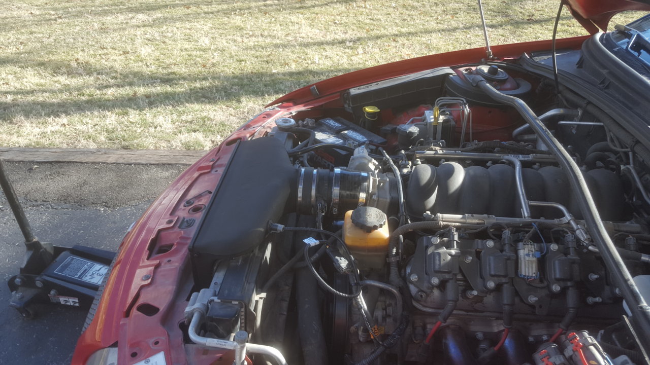

    put the new intake on tonight. xair over the radiator. i can see the difference it makes on iat alone from my ultragauge. driving down the highway air is ambient and it drops fast when above. the stock intake always read hot compared to ambient

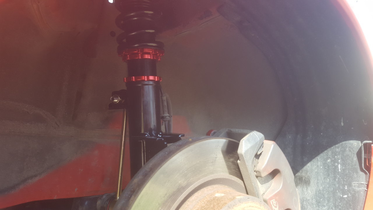

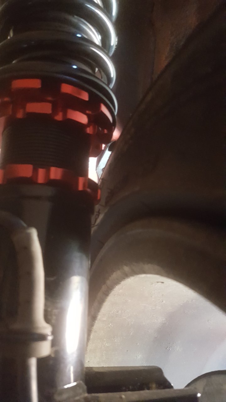

    Well tonight i did round 2 with the suspension.
    removed the stock shocks/struts and lovells springs i had installed. then installed the new maverick man coilovers which have higher springs rates. but WOW do they ride smoother. my stock struts had to be blown as fuck!

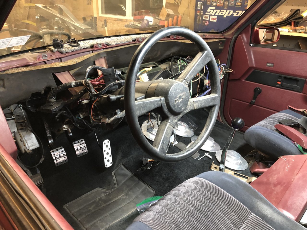

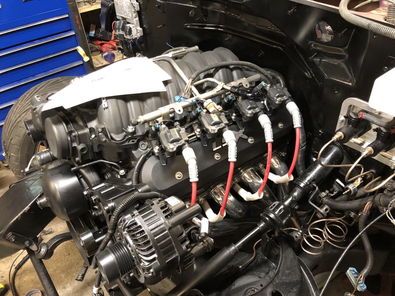

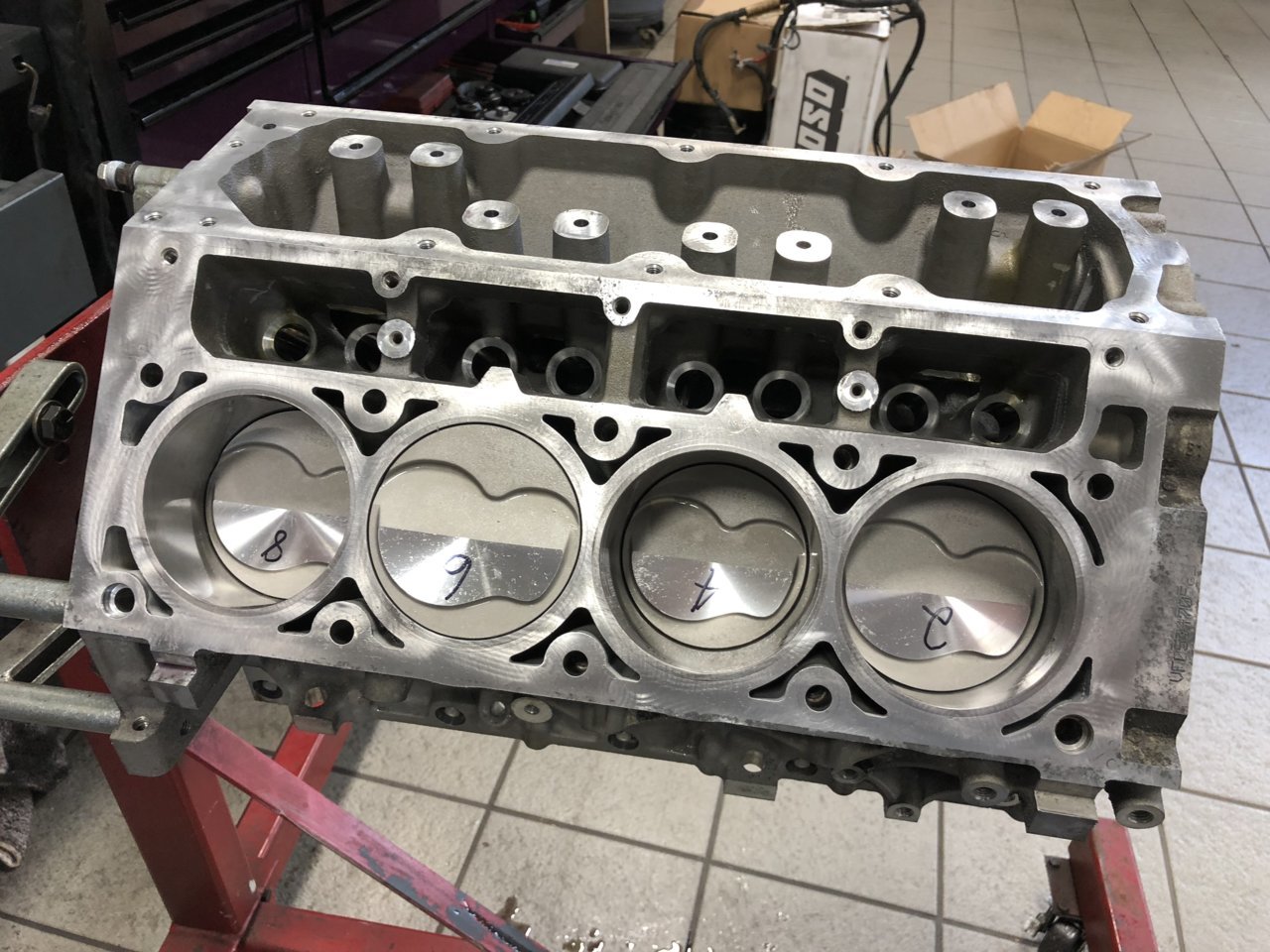

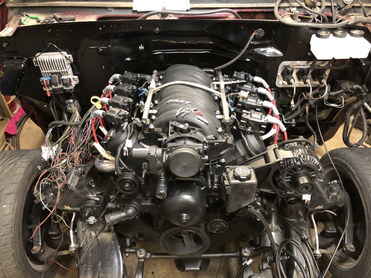

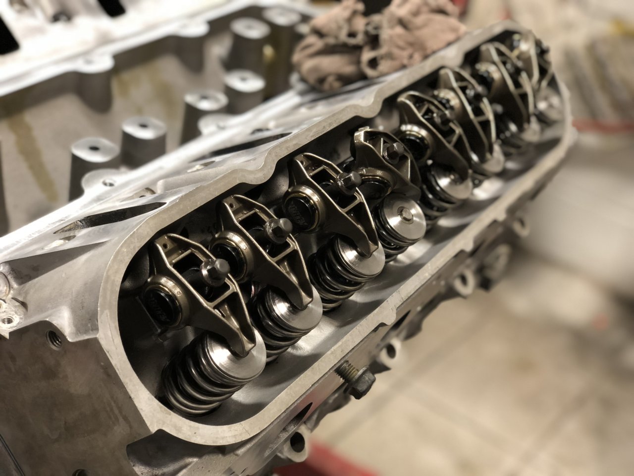

    I am in the middle of helping a friend swap a 6.0l and t56 out of a 2005 gto into a 1989 c1500 chevy truck. Found rust in a cylinder so had to bore it out, new pistons, Texas speed Tsunami camshaft, lsx 102 intake. Should be one nasty truck.

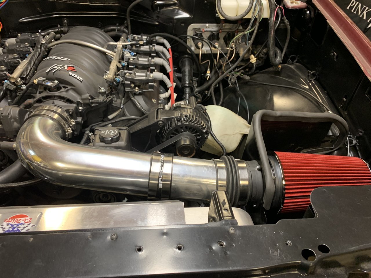

    Thanks, finally started it the other day. That cam sounds absolutely amazing.
    Here is how it looks as of today
