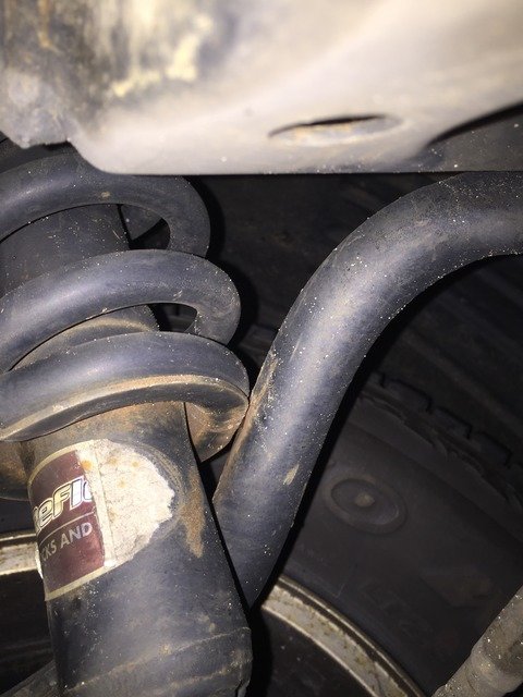

    So I have been reading a lot of different post and trying to get a little knowledge about my truck. Sometimes this forum can be a little confusion but I will dig it out. Here is an update and what actually caused me to start thinking one of the reasons my shocks were worn out. When I back up out of my driveway is when I notice this the most or when I back up while hitting the smallest of bumps there is a rubbing/squeaking noise. So I had my dad push on the bumper up and down while I was under my truck and this is the culprit. Coil rubbing sway bar. It is like this on both sides. Again this truck was purchased with stock coils/shocks but with a spacer that appears to measure about 1 1/4". So what I am thinking now is Bil 5100 and EMU 2885 coils. Not sure what to set shocks on though to match my current set up. Help there please. Here is a picture of the rubbing. I don't want to make any purchases until I know I don't have other issues going on. Again thanks for everyones help and please excuse the dumb questions. Merry Christmas.
