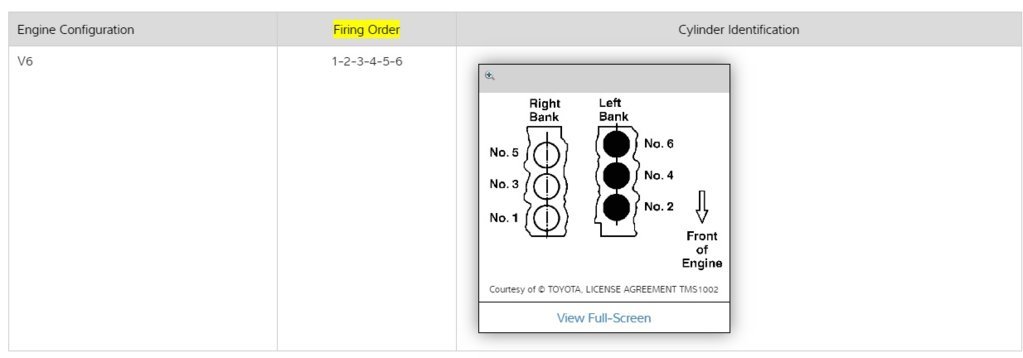

    Swap the #3 and #5 coils and see if you get a P0353 instead of a P0355.

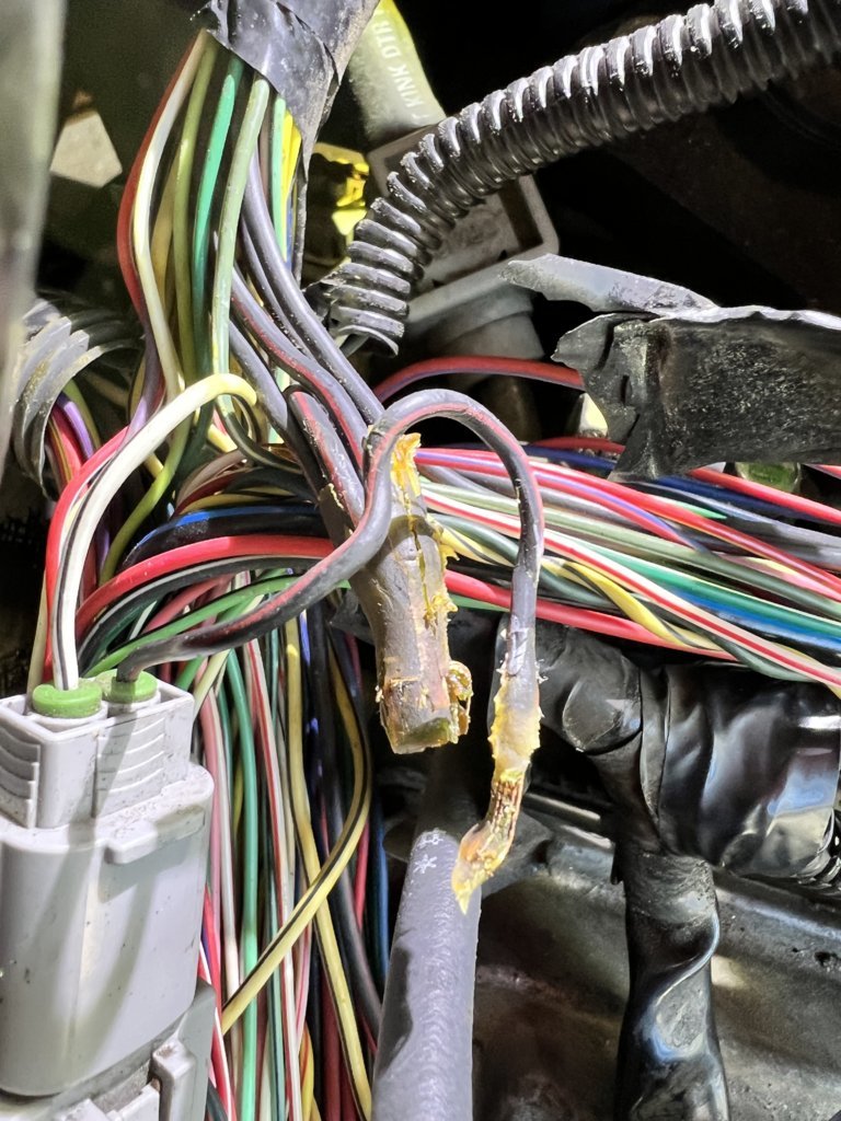

    So I am digging through the wiring harness and this is what I found so far. Doesn’t look OEM to me?
  10. Mar 19, 2025 at 7:50 AM
    #230
    sikruis
    sikruis [OP] Well-Known Member
    Jan 24, 2024
    #442373
    241
    Scott
    2006 Tacoma Off Road
    Im pretty sure I found the issue. Now I have to pull up the wiring diagram to ensure I connect these properly.

    If anyone has a link to the diagram showing which pistons are linked it would be much appreciated. I think I've seen where they're paired and not all connected together! I'm an accomplished solder tech so it'll be done right. I also need help determining where the black/red wire (in forefront of the last pic i posted) connects. I think I'm close ya'll!

    I know on my 2008 there is a set of grounds attached to the passenger side of the engine, near the fire wall. Wire markings appear similar to that bundle of grey/red stripe you have shown above.

    @caribe makaira Do you know what wire is OP looking at? Has been unable to get truck running well after engine swap (looking at engine harness).

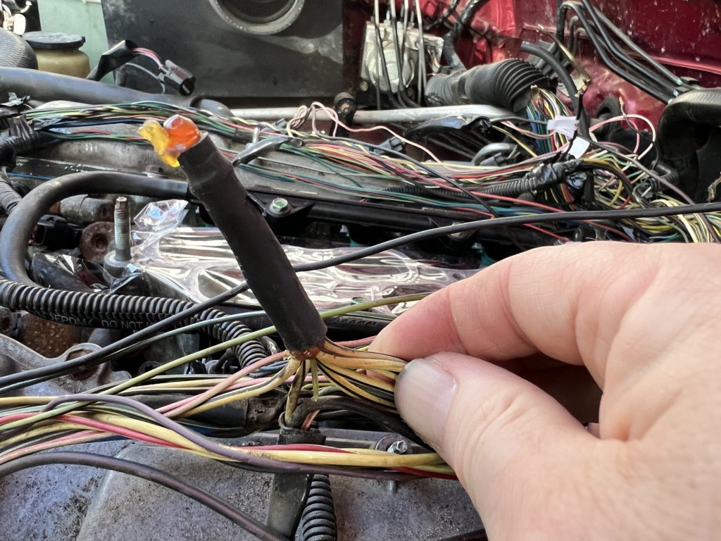

    Other shenanigans on the other side. This can’t be OEM either?

    Thats a factory splice, looks like the one for the ignition coil powers.

    On a better note, I think these ignition coils are paired together? Example would be piston one goes with piston two?

    Really?! That’s some shotty looking.

    No they are sequentially fired, it's not a waste spark system.
    Yea many manufacturers don't solder them, they are just pressed together and heat shrinked. But factory splices don't typically fail.

    Great! I'll solder them and cover with heat shrink. I guess I've still yet to find a short.
