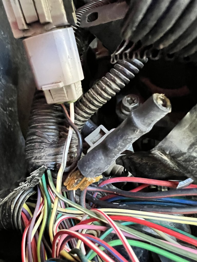

    That connector looks like it has overheated. The pins (metal terminals) in there loose their temper, if overheated, and make a bad connection. Or a bad connection, can be the cause of the heat, that slowly self destructs. Might be worth checking that connector, and any others that you see with heat stress.

    I think that's the connector for the engine noise monitor? Either way, I dug through the entire harness checking each wire. I did find some minor heat damage on the #1 injector. I ended up repairing with heat electrical tape and replaced the sleeve.

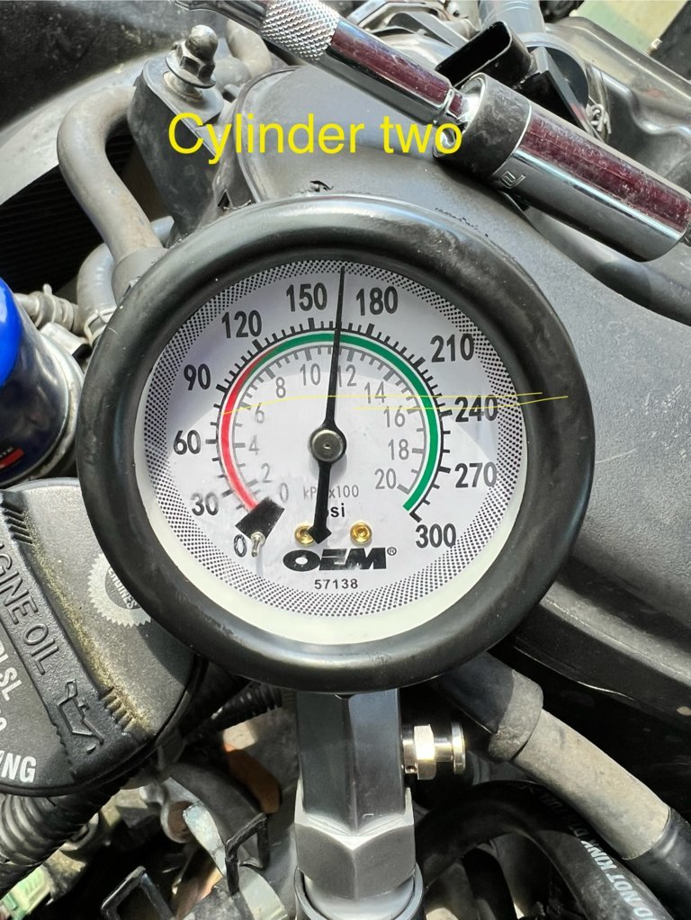

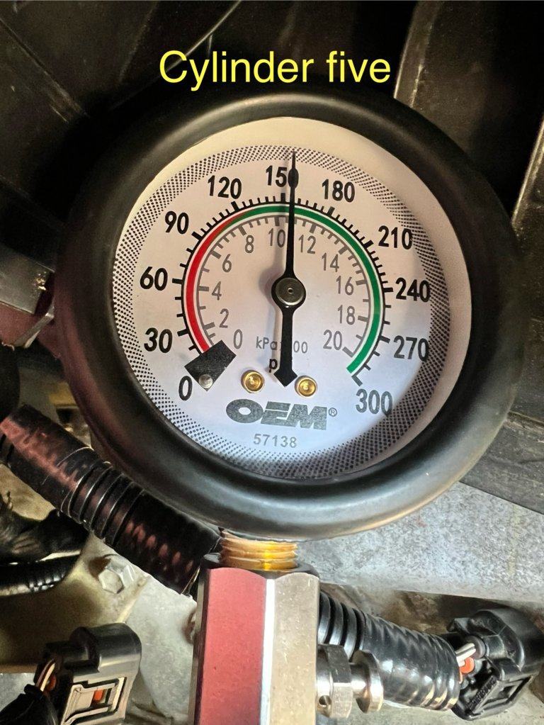

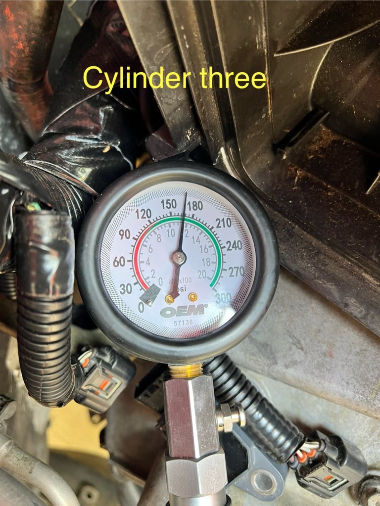

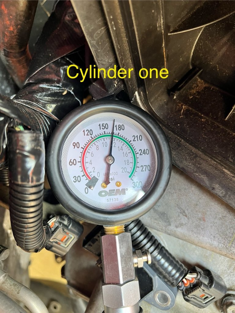

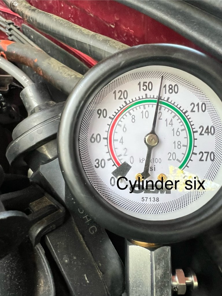

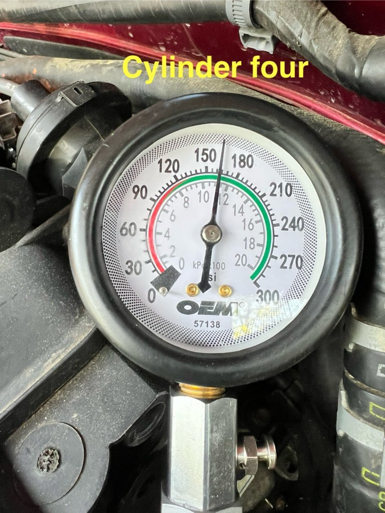

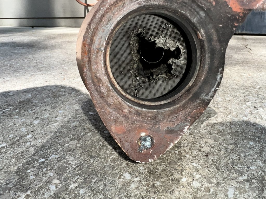

    Today I removed both catalytic converters to check for plugs. None was found. I also ran compression checks on all six cylinders.

    Cylinders are healthy. I imagine that you already knocked the reat of that crap out by the time of this reply though, correct?
    I just built an exhaust for a friend's truck. Post headers back. He had the idea that the cats were clogged and blocking his exhaust. Ends up that the muffler is where the blown cat material was bouncing around and causing the occasional blockage.

    That cat looks pooched, if that stuff went into the downstream cat then it's probably plugged.

    Agreed. Time for some aftermarket headers. :D

    Definitely makes sense, but would it plug enough to make the engine stall on idle, and counter to this being the problem, the OP said he can keep it running a bit longer if he revs it up; that seems unlikely if it is plugged exhaust.
    @sikruis have you run the truck straight off the headers,with the exhaust removed or at least cracked open with a gap at the header? If so, did it stay running this way? Would cause a check engine light, but should stay running, if your problem is a clogged exhaust. Do be careful to not run it very long straight off the headers, bent valves from an open exhaust, is a real thing.

    Yeah, these cats are from the old engine.
