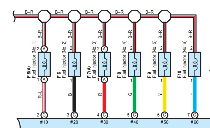

    Did you verify no injector connectors were swapped?

    I've checked everyone I could find. Something like 24.
  12. Apr 1, 2025 at 1:43 PM
    #292
    sikruis
    sikruis [OP] Well-Known Member
    Jan 24, 2024
    #442373
    241
    Scott
    2006 Tacoma Off Road
    Yup, they're good. Thanks @Dm93 for posting the schematics!

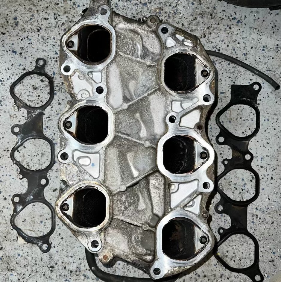

    Have you pulled the passenger valve cover to inspect for sludge?

    I have. I cleaned both the inner and outer intake manifolds.
    I cleaned them and replaced the gaskets.

    But what about the valve cover, for a health check?
