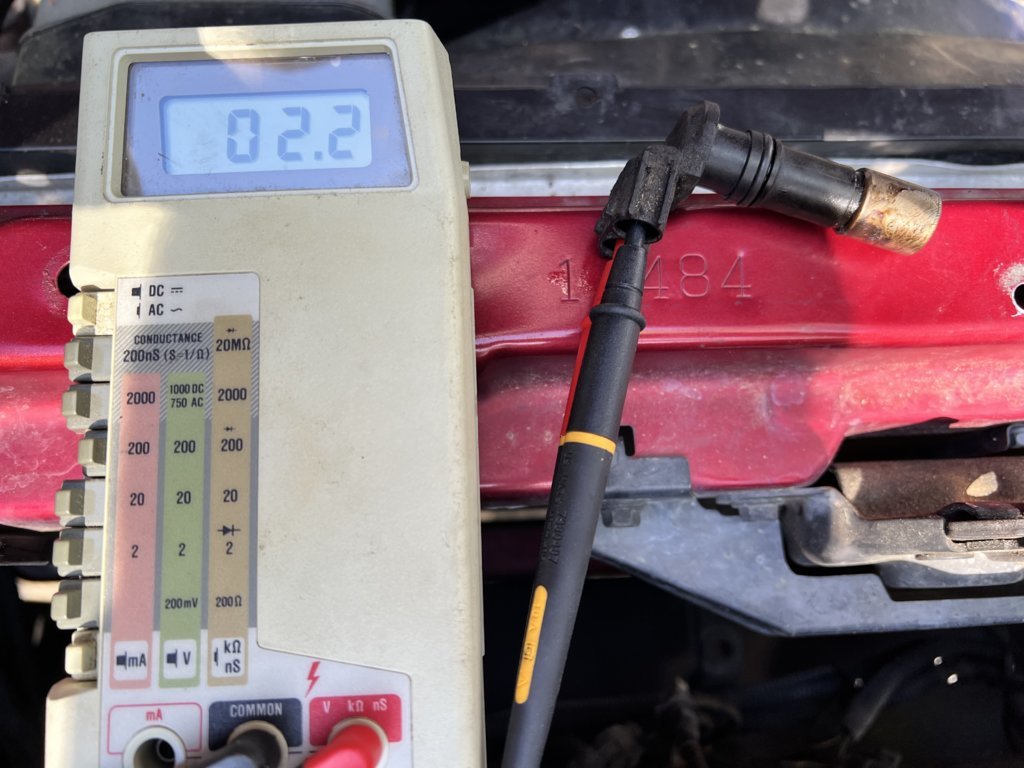

    Circling back to this. What exactly is that meter measuring? Never seen one like that before. As close as I can tell you're set to read in k-ohms? 2,200 ohms?
    If so the crank sensor looks good acceptable range is 1,850 - 2,450 ohms.
    Cannot find an acceptable range for the 1GR cam position sensors though... What was your reading on those?

    It is the strangest meter I have seen as well.

    It's 2200 ohms.

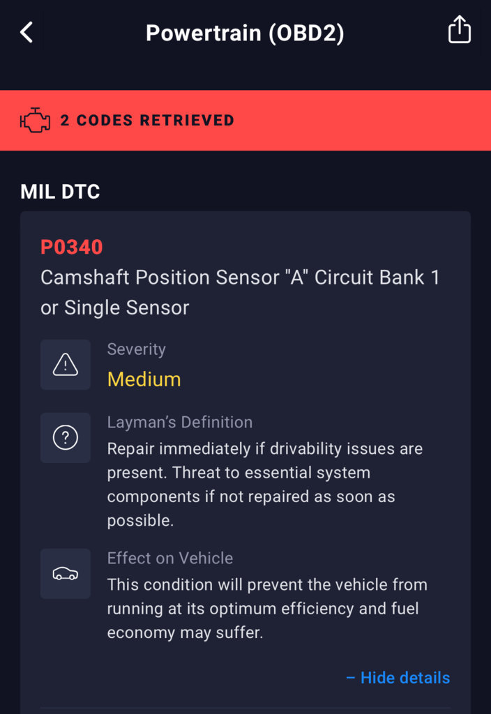

    So after checking my cam sensors, reading between 200 and 1000 ohms, I reinstalled them and now I’m getting the P0340 error. It’s still stalling, but I am not getting misfires.

    I am sure that you've double checked the plug for the sensor, to make certain it is properly clicked in?

    Scott
    2006 Tacoma Off Road
    I did, snug as a bug. I even cleaned off the terminals and added dielectric grease. I ordered new ones.

    Did anyone ever figure out what the ohm range is supposed to be per Toyota? For the cam position sensors?
    Kinda odd I cant find that anywhere in the books I have

    The only thing on the resistance spec of the cam sensor was between 200 and 1000 ohms.
    I did check the entire wiring loom inside the engine bay. There were some minor nicks, repaired, which didn't show anything obvious. How do I go about checking the resistance from inside the ECM?

    You can't ohm check Hall Effect sensors, you can only check the signal with an oscilloscope.
    The 4.0 will run on the crank sensor alone so you can unplug the cam sensor in question and see if it stays running.

    Is the crank position sensor a different type of sensor? I always assumed the resistance check was just a way of determining the internals of the sensors were ok (no open circuits or dead shorts) but never looked into it until now

    The crank sensor on the 4.0 is a VR (Variable Reluctance) sensor, it's just a coil of wire and a magnet and creates it's own voltage unlike a Hall Effect sensor that needs a voltage and ground supply to operate. While you can ohm test VR sensors and if they fail they are definitely bad but they can pass an ohm check and still be bad.
