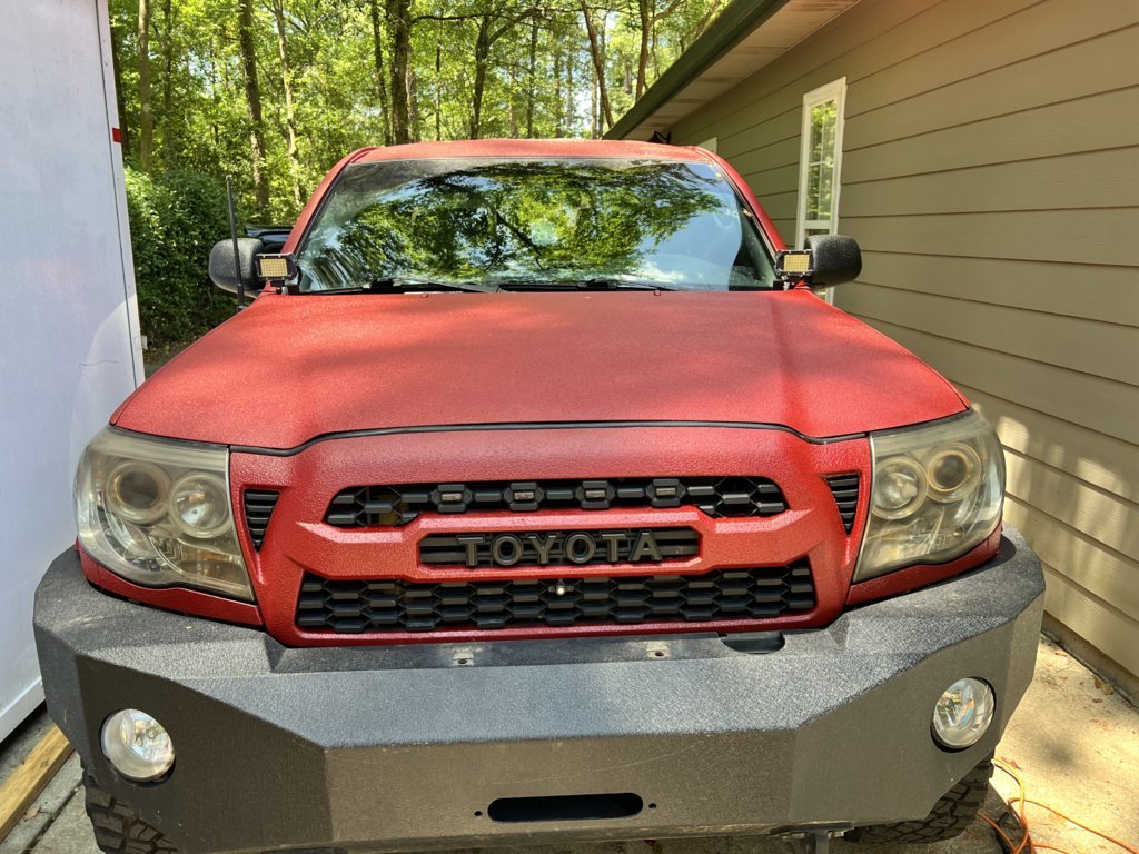

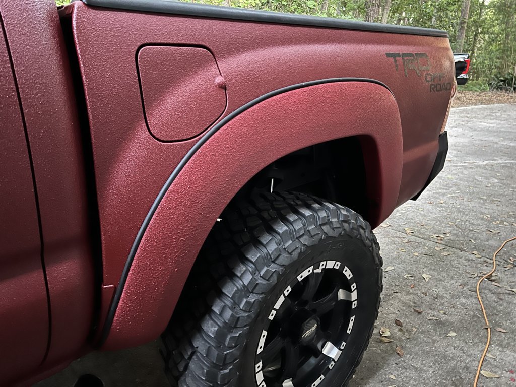

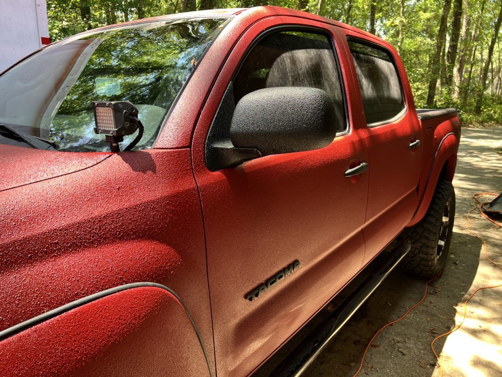

    I have been busy with bodywork though. Check it out.

    After all that work this thing is going to be niceeeee

  14. May 22, 2025 at 2:37 PM
    #354
    sikruis
    sikruis [OP] Well-Known Member
    Jan 24, 2024
    #442373
    241
    Scott
    2006 Tacoma Off Road
    Thanks bro! She's my girl!

    Looks great! I'm thinking about doing my own repaint, but not sure how to go about prepping the fender flares. It looks like they're plastic but I'm not sure if they're painted. How did you prep yours? Sanding, priming, etc. Did you take them off the truck to get the rest of the body underneath them? If so, how difficult was it to take them off?
  16. May 23, 2025 at 10:45 AM
    #356
    sikruis
    Jan 24, 2024
    #442373
    241
    Scott
    I had the same questions. I pulled the fenders off and sanded them. They were already losing their clearcoat. It was super easy after that. As long as you get the clear coat off, which mine was almost already gone. It will adhere without a primer.
