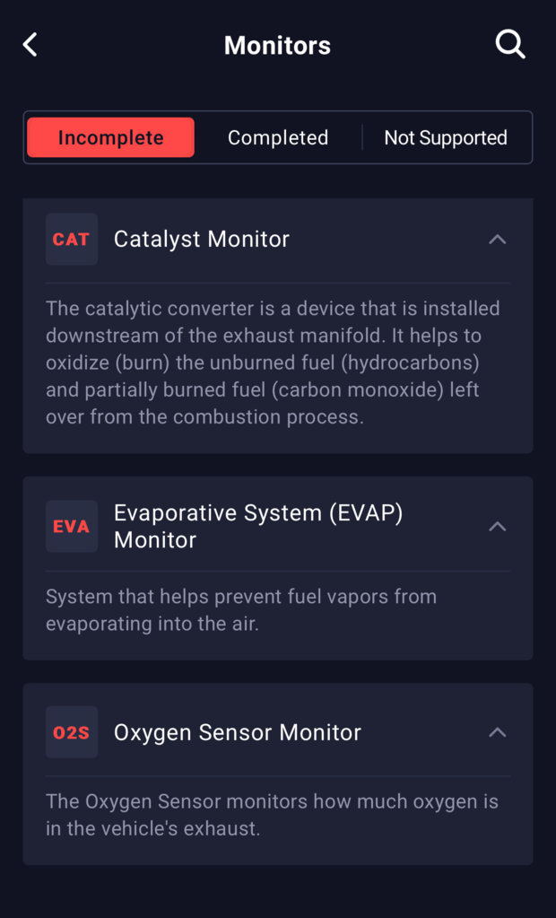

    I was able to pick the below diag scanner and clear the saved codes.
    I re-ran the diag and am getting the following codes:
  16. Feb 6, 2025 at 12:08 PM
    #56
    Dm93
    Dm93 Test Don't Guess
    Mar 3, 2015
    #150066
    14,025
    Texas
    2014 DC OR 6spd 4x4
    Predator tube steps, Ranch Hand grill guard, Magnaflow CatBack exhaust, Toyota tool box & bed mat, 2LO Module by @Up2NoGood, Rearview Compass/Temp Mirror, Tune by @JustDSM.
    Your in OBD monitors not codes, we want to read/clear codes (DTCs).

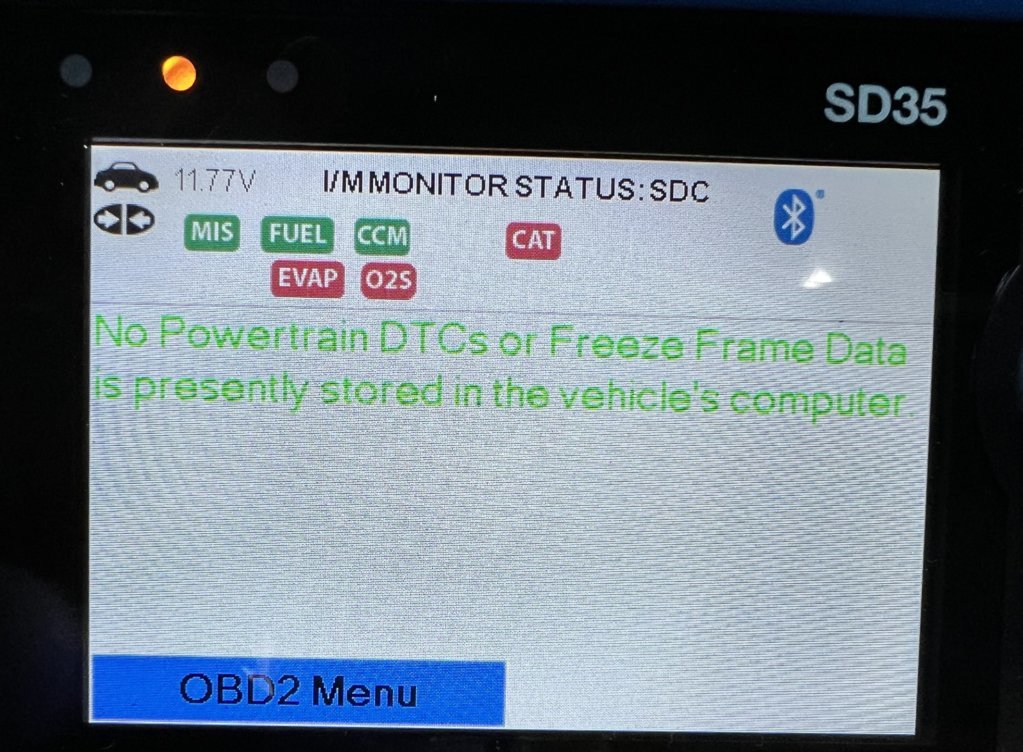

    I've erased and scanned again. No error codes.
  18. Feb 6, 2025 at 1:39 PM
    #58
    Dm93
    Mar 3, 2015
    #150066
    14,025
    Texas
    2014 DC OR 6spd 4x4
    Does anything come back after a start attempt?
  19. Feb 6, 2025 at 1:42 PM
    #59
    sikruis
    sikruis [OP] Well-Known Member
    Jan 24, 2024
    #442373
    241
    Scott
    2006 Tacoma Off Road
    This is after the start attempt.
