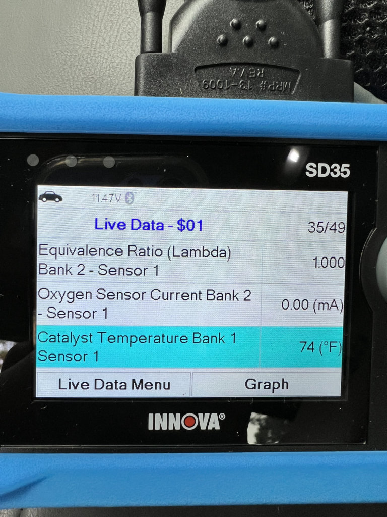

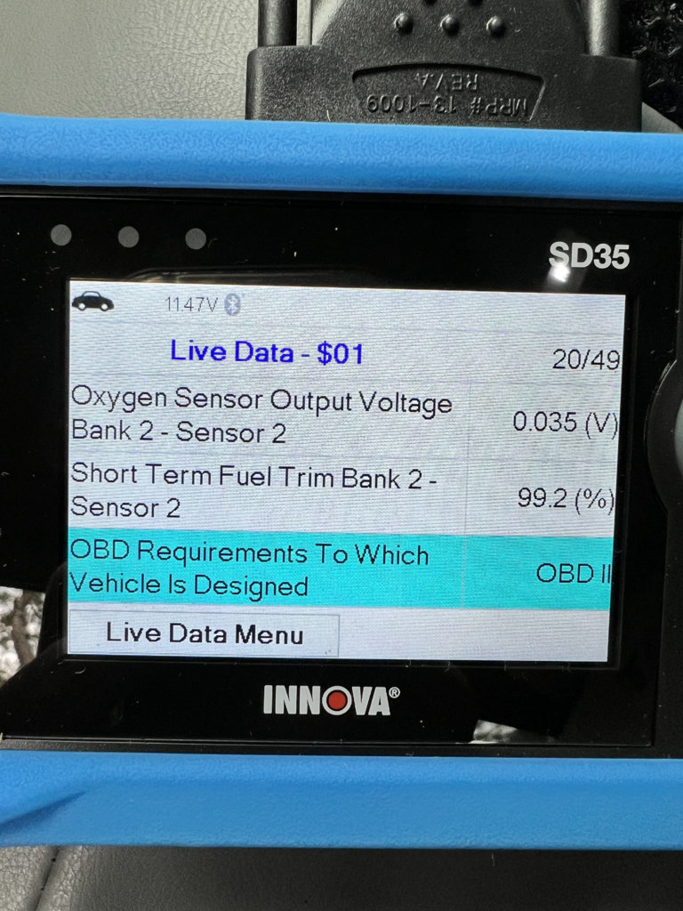

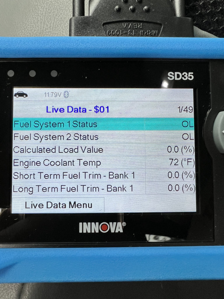

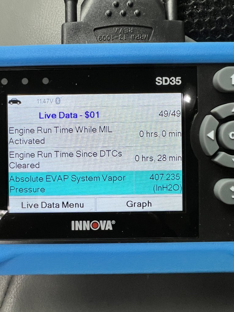

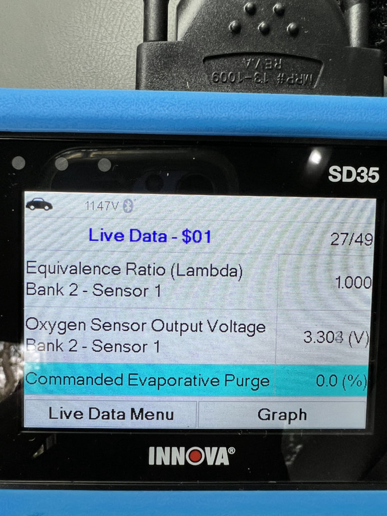

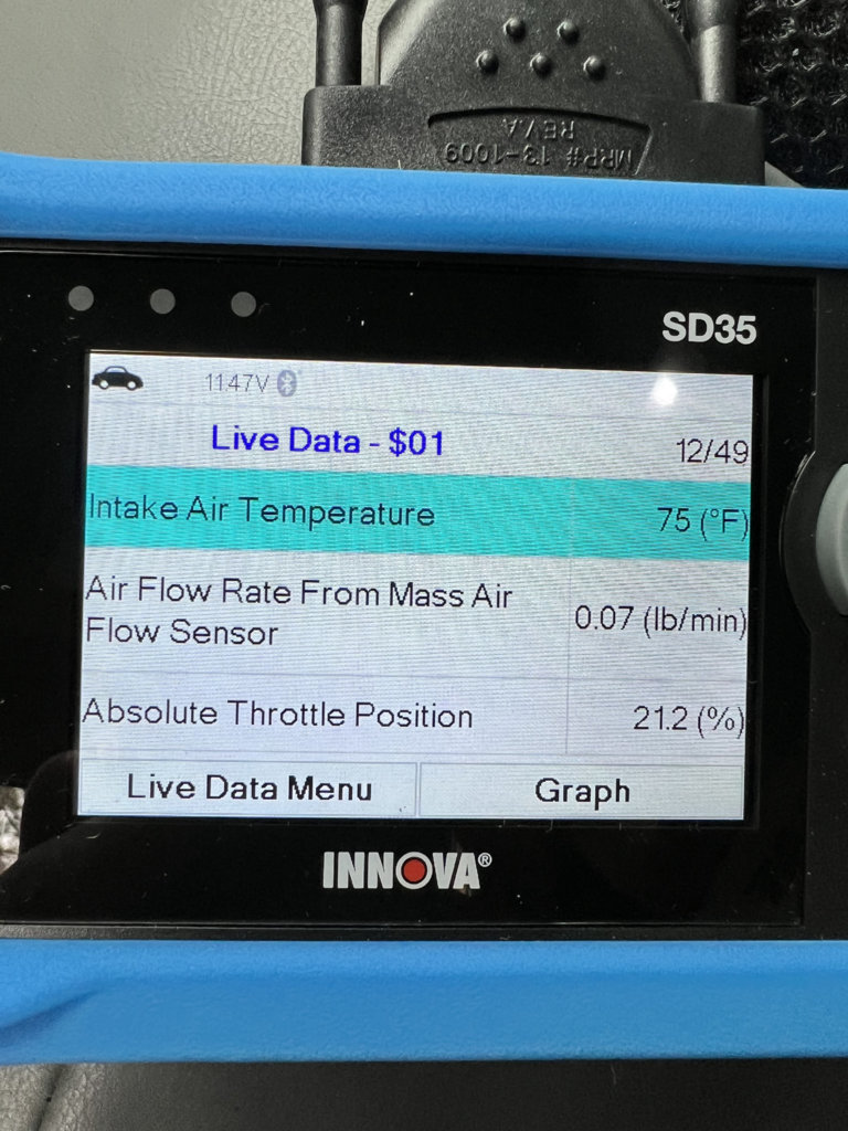

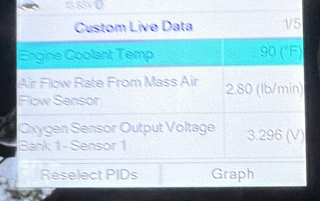

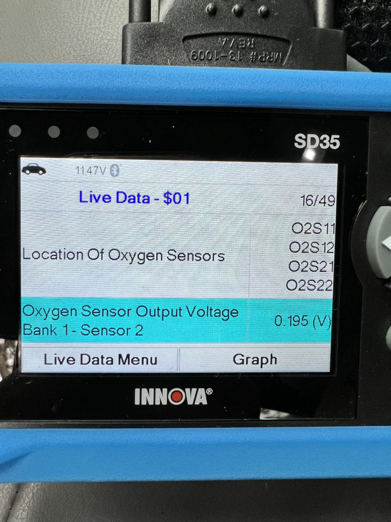

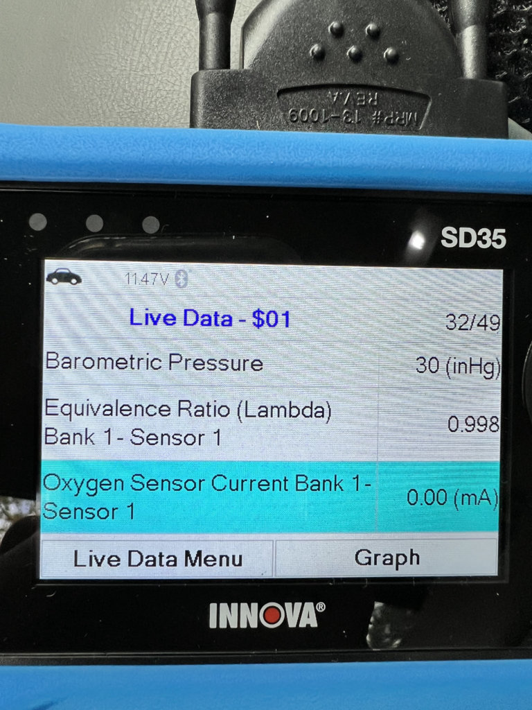

    I apologize for my ignorance, what's ECT and A/F? This is a snapshot at point of shutdown.

    Could it be a clogged exhaust? Mechanic said there was a bunch of gunk that got kicked out when he first tried to start the swapped engine.

    was this with the engine off?
  4. Feb 6, 2025 at 4:12 PM
    #64
    sikruis
    sikruis [OP] Well-Known Member
    Jan 24, 2024
    #442373
    241
    Scott
    2006 Tacoma Off Road
    As it died. It's only on for like 8 seconds.

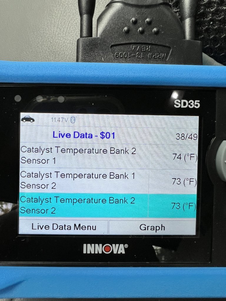

    So the engine was OFF?
    If so, that MAF reading is way high for an engine NOT running,.
    Give us all 5 pages of Data with engine OFF.
  7. Feb 7, 2025 at 1:34 PM
    #67
    sikruis
    Jan 24, 2024
    #442373
    241
    Scott
    I took that pic just as it dying, so it was running.
    TnShooter likes this.

    Ok. Can we still get the data with Engine OFF?
    All 5 pages.
    You scanner shows page 1/5.
    Be nice to see all 5 pages.

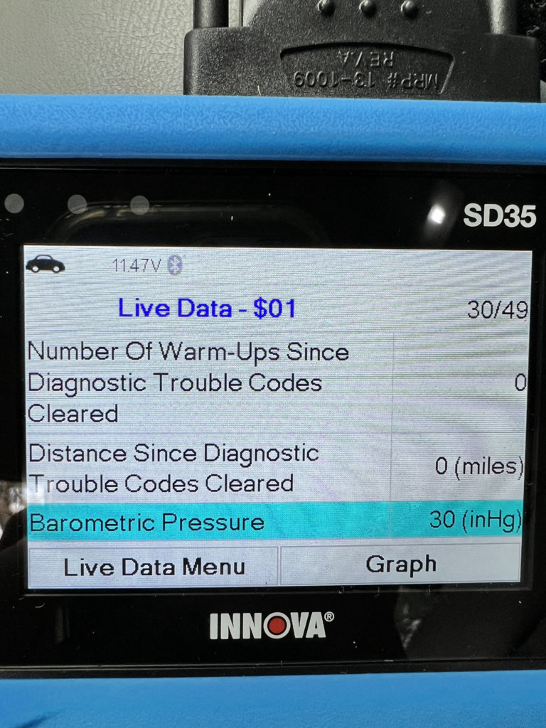

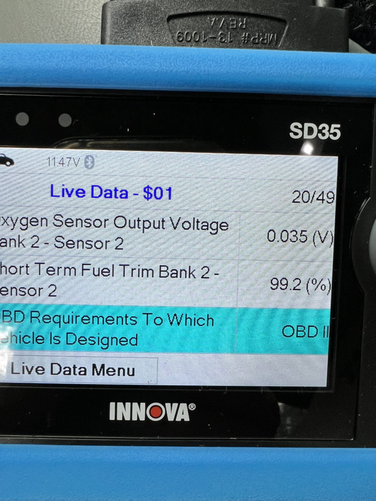

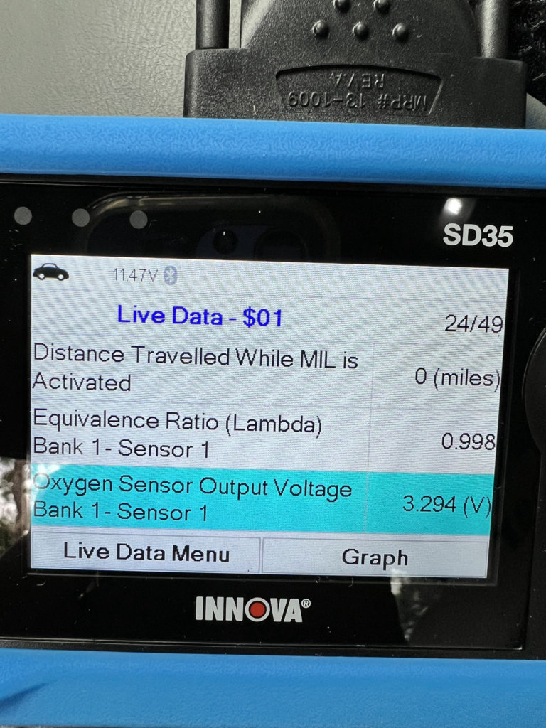

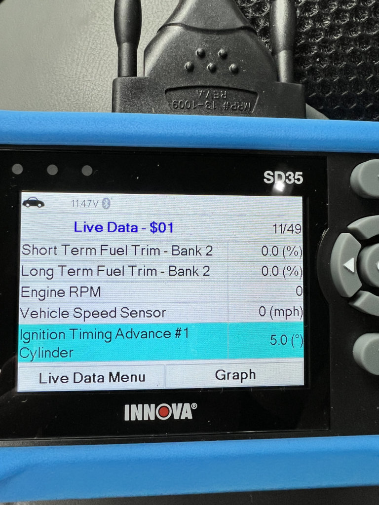

  9. Feb 7, 2025 at 1:49 PM
    #69
    sikruis
    Jan 24, 2024
    #442373
    241
    Scott
    Images from the live data
