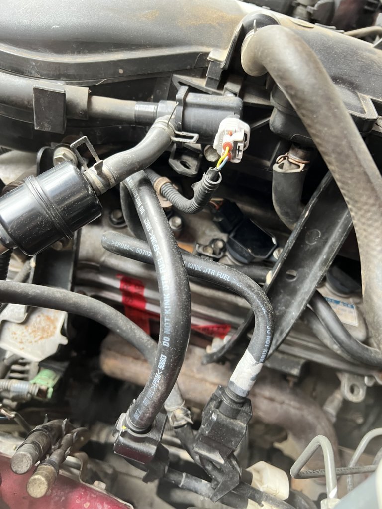

    Can someone tell me what this should be plugged into? I found this the very back of my engine. Looks like there’s a hose that needs to be connected?IMG_8322.jpg

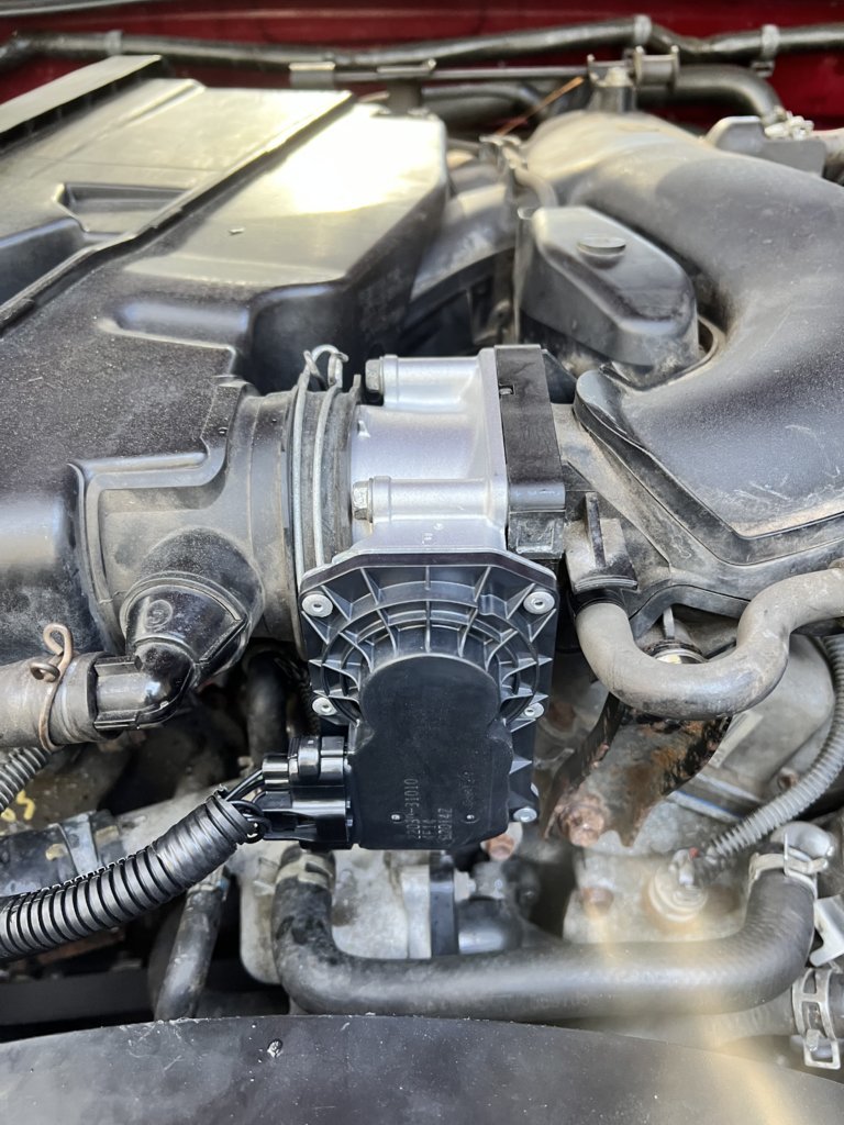

    Could it be a bad throttle body? Is there a way to test it?

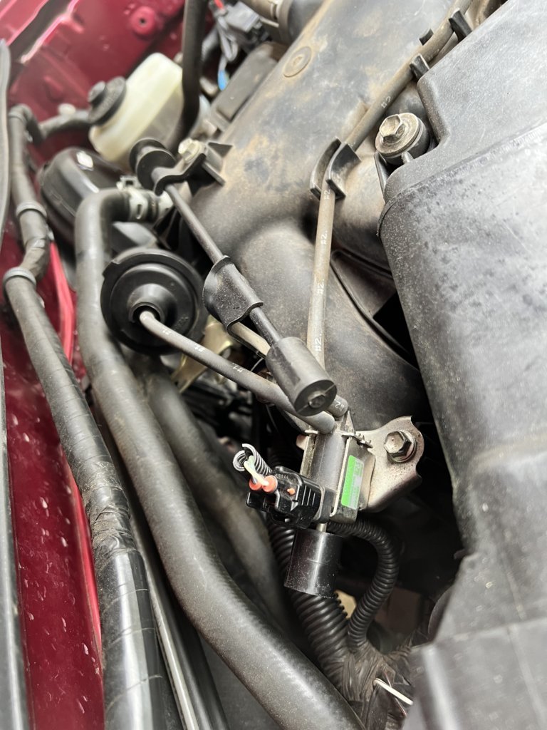

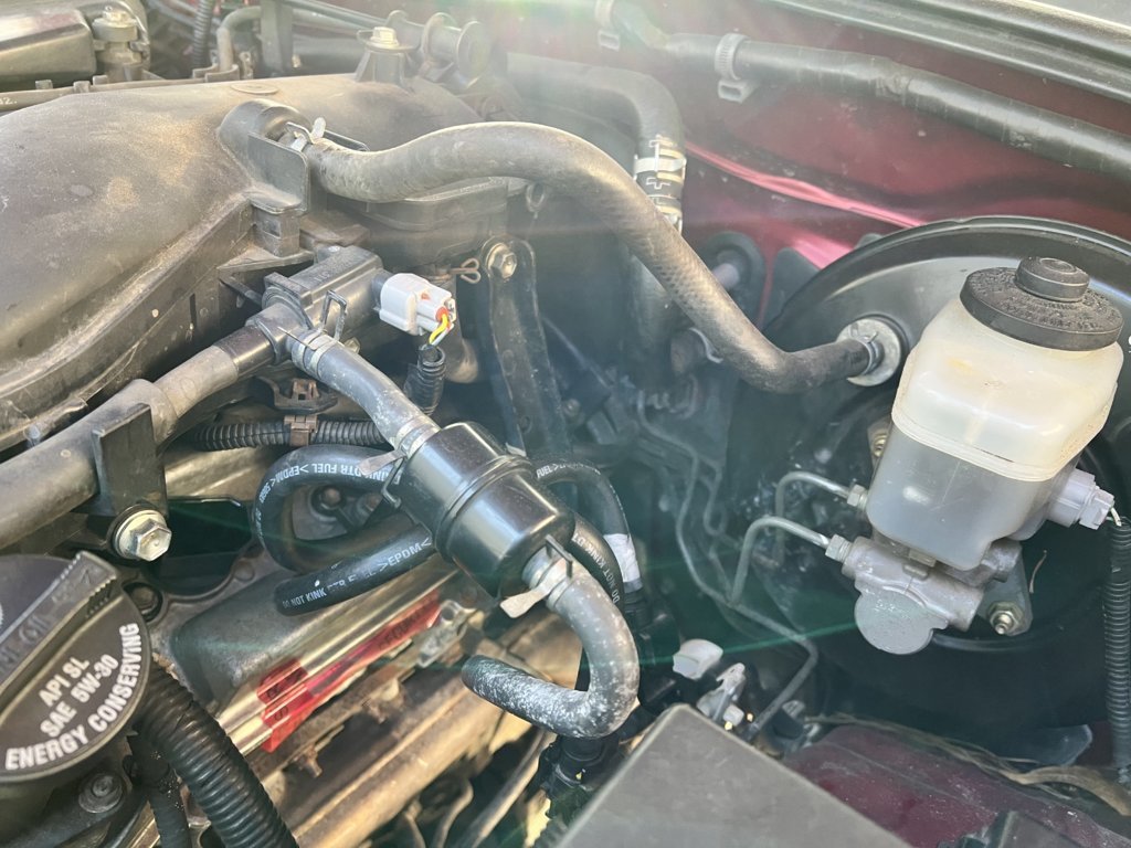

    What about the driver side hoses.
    Also, are you certain that the fuel lines are connected properly? From the feed hose to the driver side of the fuel rail, and the outlet of the fuel pressure regulator to the return hose on the fender?
    Can you get some clearer photos of the fuel lines, and where they attach to the hard lines please?

    I will get you some clearer photos. However, this is from the driver side. I have insured the lines are properly attached and ran a pressure test.

    I would have to double check but this looks like one of the vent hoses from the automatic transmission or transfer case.

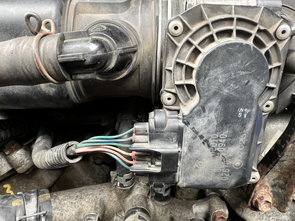

    the last photo of the throttlebody shows the plug clip is broken. I have ordered a new harness.

    All of those photos show everything to look good.

    Thanks! I did swap it back. I also ordered a new OEM throttlebody and wiring harness. If the throttlebody doesn’t work, I will return it.

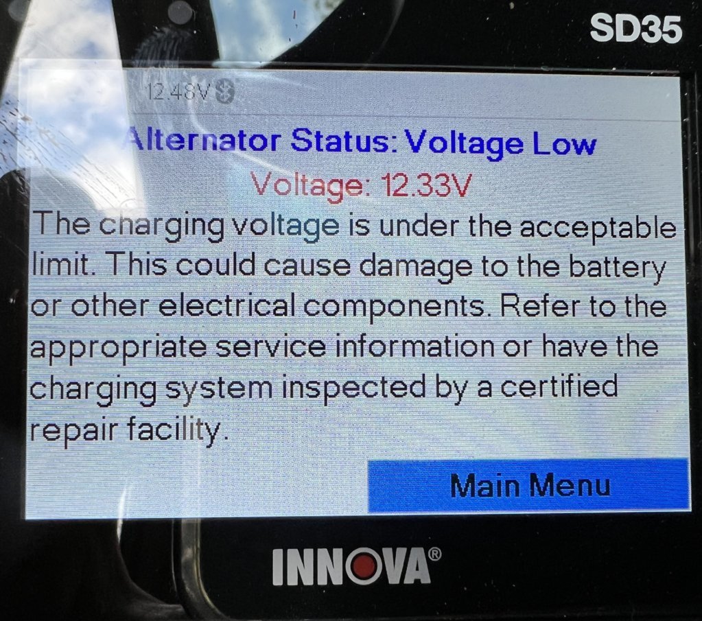

    In your earlier revving videos. Did you have the scan tool connected to see what the voltage was, while you had it running?
  15. Mar 4, 2025 at 12:00 PM
    #135
    sikruis
    sikruis [OP] Well-Known Member
    Jan 24, 2024
    #442373
    241
    Scott
    2006 Tacoma Off Road
    I can do it again. What am I looking for? The alternator voltage?
  16. Mar 4, 2025 at 12:08 PM
    #136
    sikruis
    Jan 24, 2024
    #442373
    241
    Scott
    I am not so certain about this test. The alternator is relatively new.
  17. Mar 4, 2025 at 1:04 PM
    #137
    Torspd
    Torspd Tor-nication
    Sep 18, 2009
    #22958
    26,443
    Tor
    The Great America!
    MMVI 4.4L 4x4 Access Cab
    Torspd Custom Turbo kit [] Borg Warner 9180EFR Turbo [] Haltech Elite 2500 [] TiAL Q BOV [] TiAL V44 Wastegate @ 15psi [] CP Pistons [] CP Carrillo Rods [] ARP Head studs [] ARP Main Studs [] ARP Header - Head Studs [] Ported Heads w/ 1mm oversized valves intake/exhaust [] Brian Crower Forged Stroker Crank [] Darton M.I.D. Sleeved Block [] Kelford Camshafts [] Torspd 160* T-stat mod [] APR Large Fuel Rail [] Walbro 460 LPH E85 Fuel Pump [] FueLab FPR [] APR T56 Conversion Kit [] KP RACING Built T56 [] McLeod Racing Custom Twin Disk Clutch [] One Piece Aluminum Driveshaft [] MGW Shifter [] Custom lowering kit [] Ohlins Front Coilovers [] QA1rear shocks [] Custom Ron Davis Radiator [] Dual SPAL Electric Fans []
    Just to verify that the alternator was charging at higher than eleven 11VDC.
    It is.
    You had said earlier that your catalytic converters had a smell to them. You could always drop your white pipe and take a look at them. To inspect the media and make sure nothing's clogged up. You can even let it idle for a little bit like that and see if anything changes.

    Swapping out the throttlebody did not make any changes. Could it just be bad gas? The throttle body is very responsive and after it begins to idle it dies. Again no codes.
