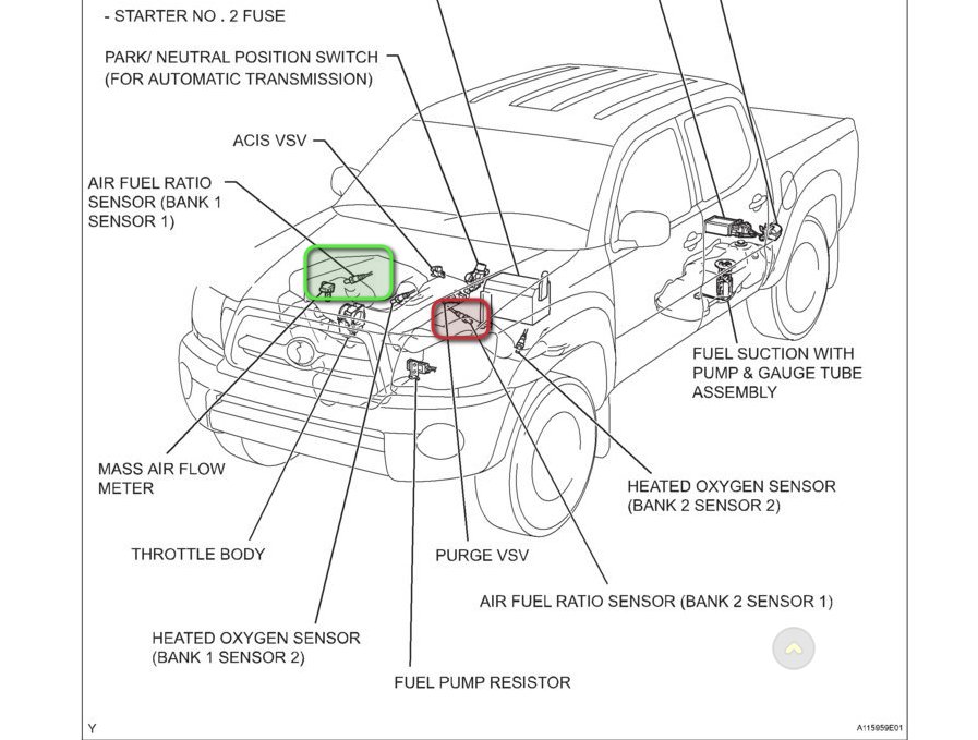

    Are we sure the A/F sensors are plugged in on the correct sides. I think it could be possible that the harness are long enough that they could be swapped. Things happen anytime an engine is swapped.
    I’d maybe unplug them. And see if the truck will go to a base map and run. But it should at least idle.

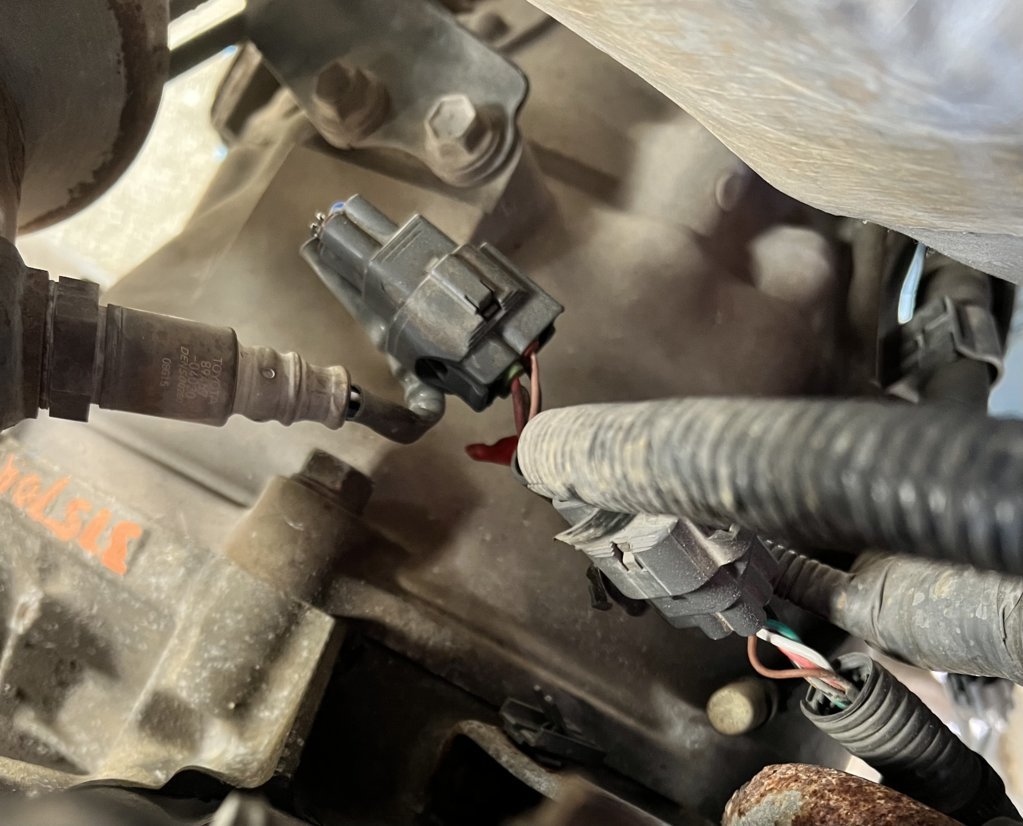

    You talking about these fellars?
  6. Mar 7, 2025 at 9:16 AM
    #166
    Torspd
    Torspd Tor-nication
    Sep 18, 2009
    #22958
    26,337
    Tor
    The Great America!
    MMVI 4.4L 4x4 Access Cab
    Torspd Custom Turbo kit [] Borg Warner 9180EFR Turbo [] Haltech Elite 2500 [] TiAL Q BOV [] TiAL V44 Wastegate @ 15psi [] CP Pistons [] CP Carrillo Rods [] ARP Head studs [] ARP Main Studs [] ARP Header - Head Studs [] Ported Heads w/ 1mm oversized valves intake/exhaust [] Brian Crower Forged Stroker Crank [] Darton M.I.D. Sleeved Block [] Kelford Camshafts [] Torspd 160* T-stat mod [] APR Large Fuel Rail [] Walbro 460 LPH E85 Fuel Pump [] FueLab FPR [] APR T56 Conversion Kit [] KP RACING Built T56 [] McLeod Racing Custom Twin Disk Clutch [] One Piece Aluminum Driveshaft [] MGW Shifter [] Custom lowering kit [] Ohlins Front Coilovers [] QA1rear shocks [] Custom Ron Davis Radiator [] Dual SPAL Electric Fans []
    Yes. The sensors in the headers, before the catalytic converters.

    Do you think it is worth swapping to try?

    No. Just unplug them for now.
    See what happens.

    I unplugged them, no change. Good thing you cannot interchange these plugs. They are keyed or of different type.

    way back in post 82, Dm93 stated that it was the A/F and the O2 sensors that could be be swapped.
    He even said that the issue it would cause, would be when you went into CL.
    I say, we unplug ALL the sensors.
    See what happens.
    I was thinking you could only get the banks for the A/F mixed up.
    Dm93 says it's the A/F and the O2 sensor.
    :rofl:I say we unplug all of them.
    The truck isn't going to like. But what do we have to loose?
    I'm still going through the 9 pages. Taking notes.
