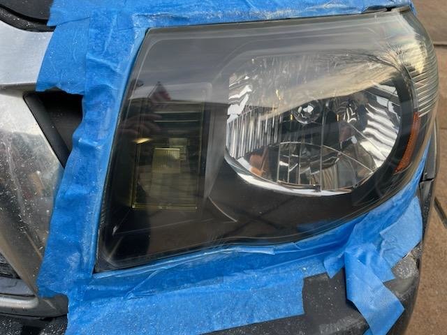

    3M headlight restoration kit, followed up with wipes from Cerakote. Mine in this photo, were as foggy as the bad headlight in a previous post.

    As long as you keep them cerakoted/waxed on a regular basis, they should stay clear. Parking in the shade or in a garage will also help.
    Feels like consumers are still "catching up" to the fact that many car parts are now made of plastic and therefore leaving them parked to bake in the sun all day isn't good. Gone are the days of glass headlamp assemblies that were impervious to UV degradation.

    Hard to go wrong with the 3M resto kit, and the Cerakote wipes. Mine still look great.
