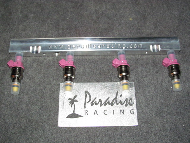

    The billet 3rz fuel rail has the correct spacing between the injectors... I have it in hand and will be used on the build!

    This guy.... showing off your shiney parts.
    Had to have ours custom made. :/

    Is that -8AN?

    That, is a great question lol

    I got it in the hopes that I could modify and use it. I was correct and so now I need AN fittings and shiz

    Where is the oem fuel damper? That may or may not be tricky to reinstall.

    Wont be returnless. I can always put an inline one somewhere, but I dont know if it will be needed

    Datalogs will let you know if you do or not. :thumbsup:
