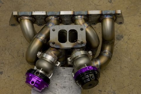

    Do you know what style of header they'll be designing? Log or tubular? If tubular, please say equal length. :fingerscrossed:

    He's doing twin scroll dual wastegates. That is going to look intense.

    It's for performamce. I want the transient throttle response to be there when im at speed. No lag between stabs of the throttle

    They'll be as equal length as possible but im sure some sacrifices will need to be made to make it work in a caged prerunner

    Probably look very close to this.:drool:

    Hmmm. Wonder if you'll have to go internal w/g due to packaging? I certainly hope not, since you have those BA wastegates.

    You jam that turbo close to the block a cage will fit. Only reason why I had so many issues is my cage should be pushed up to the top of the hood.

    I will probably have the header tubes point forward, putting the turbo about where my airbox is to allow for the cage. Also will give me room for the wastegates.
