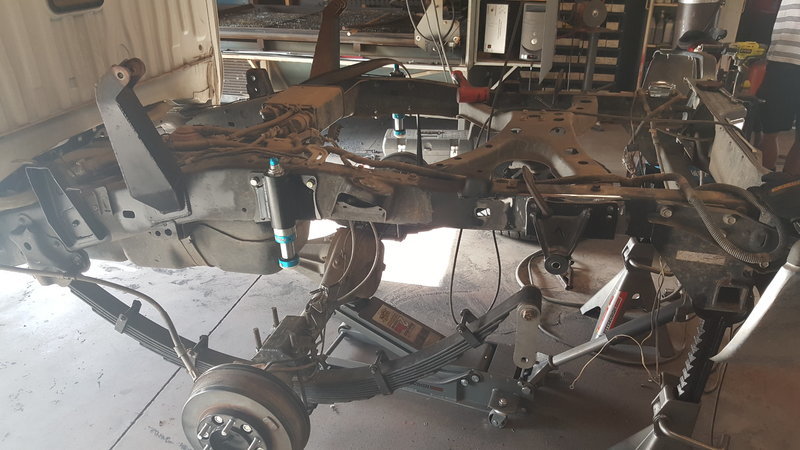

    Got some fab work done today. Taking out those rivets really suck....
    @ARCHIVE I am bypassing the bolts, and welding the brackets on. Will give you some finished pictures when we are done!

    ESB long travel kit, Deaver f67s with DTF 12 inch shackles.
    i installed that same kit on @HectoRome truck!! i did it with the bed on and was only able to not get a 2 off. other than that clean and simple install

    Dirt King Mid travel with King 2.5 coilovers, Baja Kits chase SUA with 14in fox smoothies under custom hangars.
    The rivet removal was last night with the bed on. I wish I had taken the bed off prior to attempting it with the bed on haha
    We are changing the shock towers a bit, so the bed had to come off. It will forever come off before I ever do anything back there again haha

    Is that the Albertsons in Vista???? 3rd picture.

    Hell yeah it is :cool:
    I was at mrs taco!

    How hard is it to remove the bed? I just picked up a shackle flip kit from a 'local' member.

    Undo those 6 T55 torx bolts, disconnect the tail lights and push the wiring out the bottom of the bed, remove filler neck hoses to the gas tank.
    Lift bed off. I reccomend squurting some penetrating oil on the bolts first. It helps!

    Thanks. I thought it might not be too difficult, but wasn't sure.
