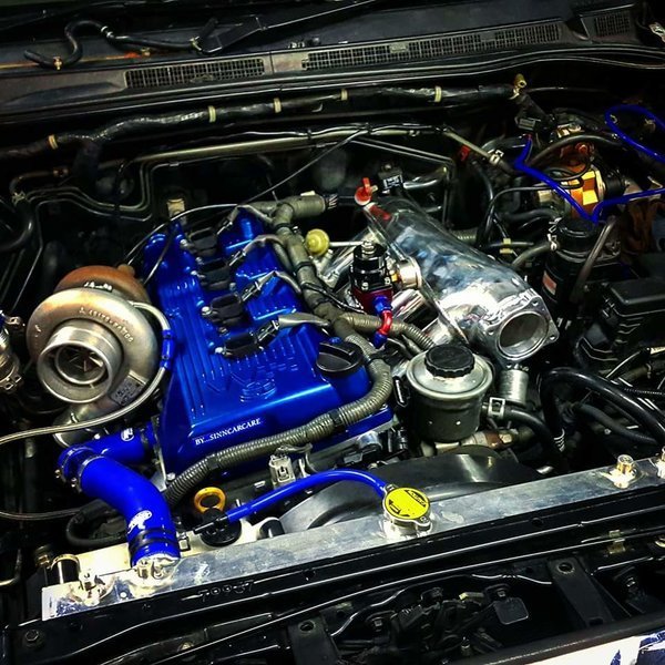

    Thats an engine built by my friend from thailand!
    Sinn car care!
    And the NDA will end in a couple months! And notice I have the same intake as him too :D

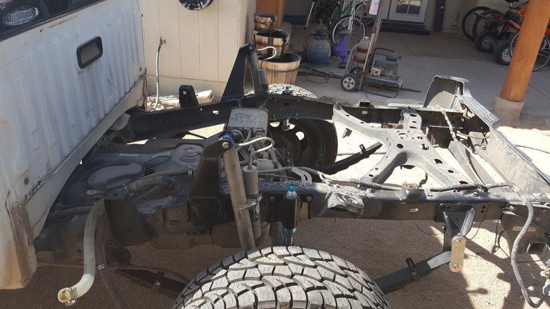

    Post that leaf spring pic in here. I'd almost recommend sliding that rear hanger more towards the cab.

    We cycled it, it works fantastic. Plus, it's welded on haha

    It feels weird having zero binding in the rear now hhaaha cant wait to get the front figured, and hit ocotillo

    Usually at full droop you'd want the hanger slightly in front of the spring. Just in case it feels harsh on dirt.
    edit: it isn't a long travel leaf so I doubt you'd have problems. It's the 62" and 64" leafs get angry.
