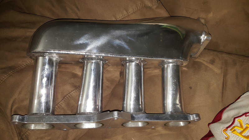

    So yesterday, I got my intake in! :rofl:
    And I already want to chop it up :crazy:

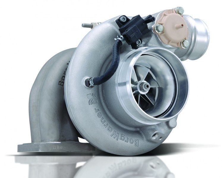

    So I got on EBAY and ordered a 76mm throttle body off of a 2urfe to start my measuring. I'm going to be upgrading from 61mm to a 76mm throttle body! I wanted to do this because of my turbo choice:
    I finally bit the bullet and purchased the EFR 7670 with a .92ar twin scroll housing. I wanted to match the size of my throttle body to the size of the Inducer on the compressor, because CFM's are everything and I wanted no restrictions.

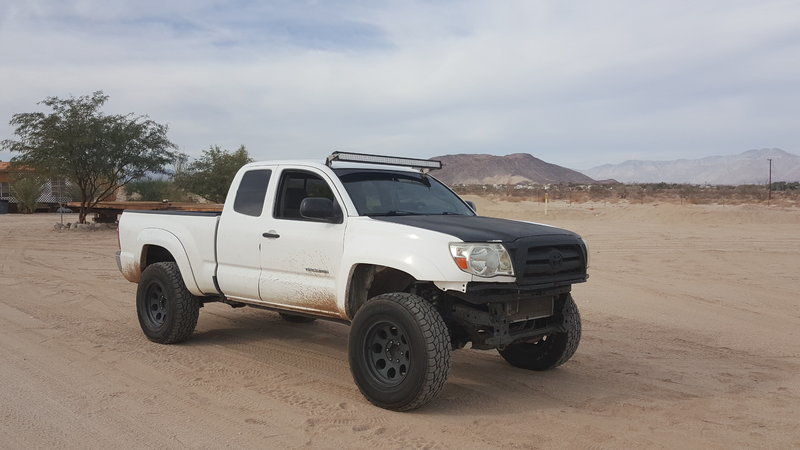

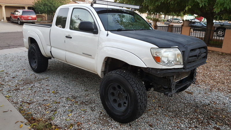

    NEW MEATS! I went with the Cooper ATP's again. They were a solid tire so I just bumped up size.
    285/70R17 33's cuz I don't want to trim all the things.
    Fiberglass fenders will be picked up tomorrow :cool:

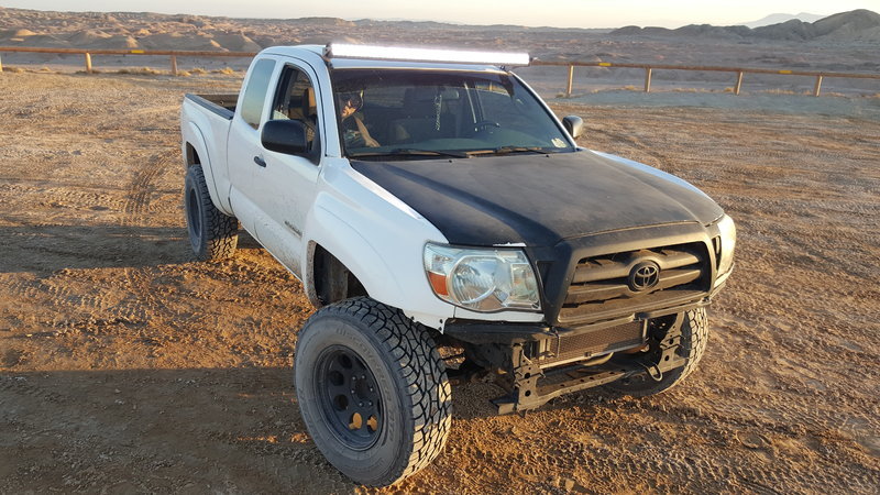

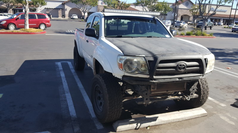

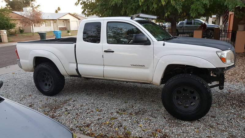

    Glass happened!
    Just fenders for now. Picking up bedsides on the way home from cali! And got some new hubs on the way too. Christmas will be good :cool:

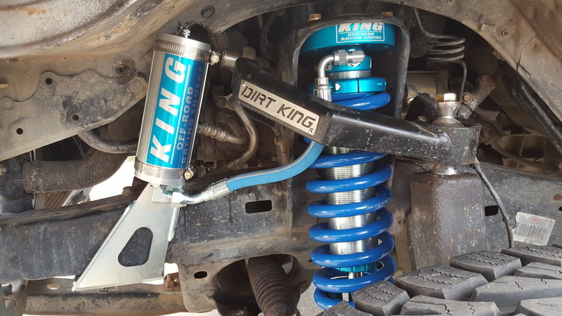

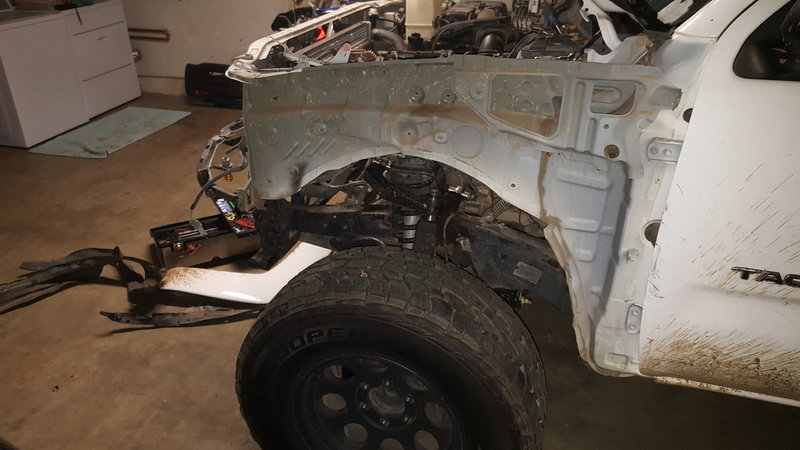

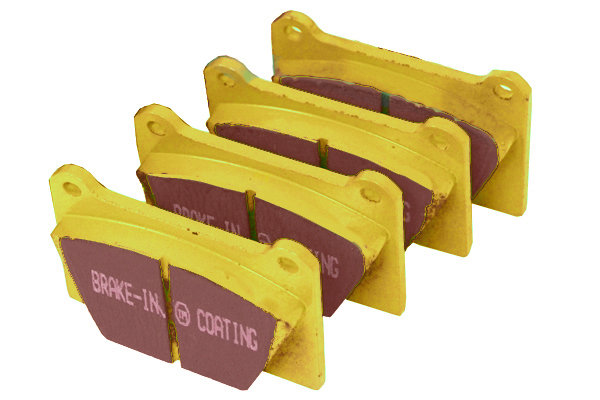

    Got some updates..!
    20161211_124416.jpg 20161129_201947.jpg 20161204_122856.jpg 20161205_160449.jpg 20161212_171643.jpg ebc_yellow_stuff_sample_image.jpg
    Got my Mcneill Front glass,
    installed my 2.5 kings,
    put some EBC Yellow stuffs on her.
    She now floats over everything(front does, at least) and stops on a dime. If you are planning to run 33's or bigger, I recommend the yellow stuffs for sure. I am halfway through braking them, in, and they are already very grabby!!! No brake fade as of yet.
    I should be getting my Baja kits spring under parts kit tomorrow, and then there will be a new, new update with new new pictures before the weekend arrives!!:cool:
