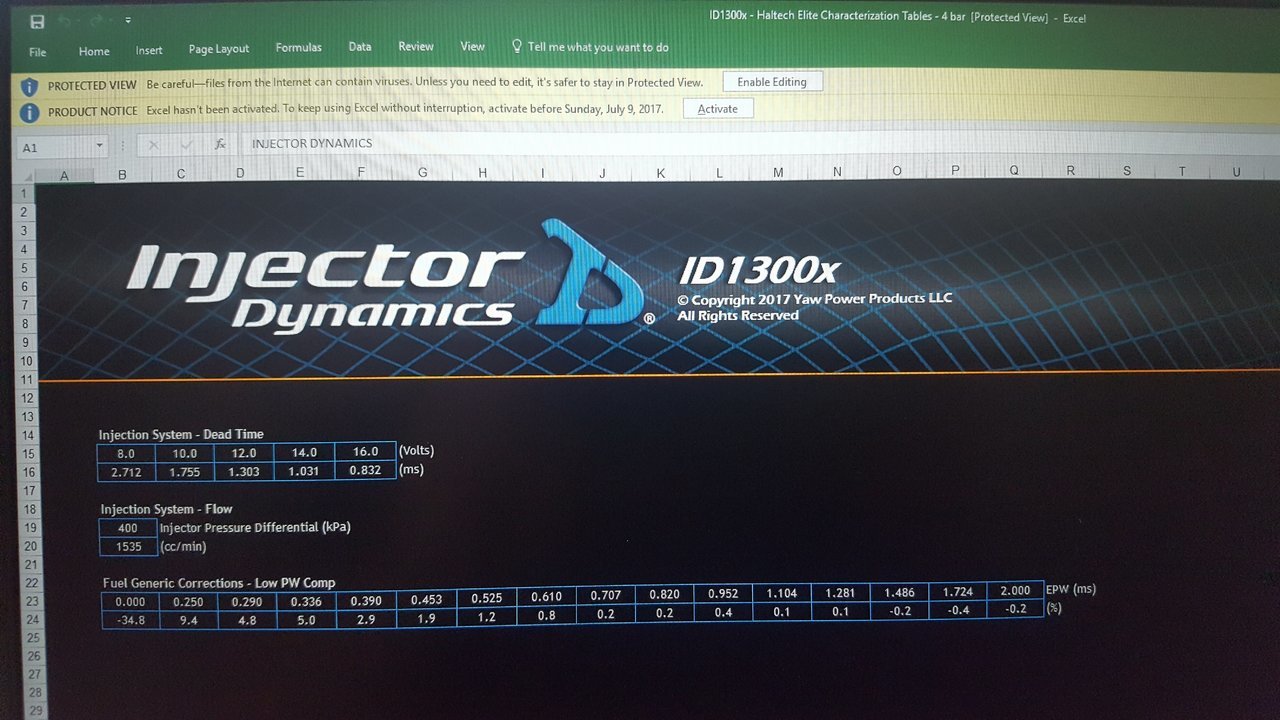

    Do you have the Dead times for them?

    I wish.... just a flow rate and supposedly they were checked for matching flowrates
    From my friend overseas lol i may end up just tuning with the stock ones and seeing how much I can yank out of them

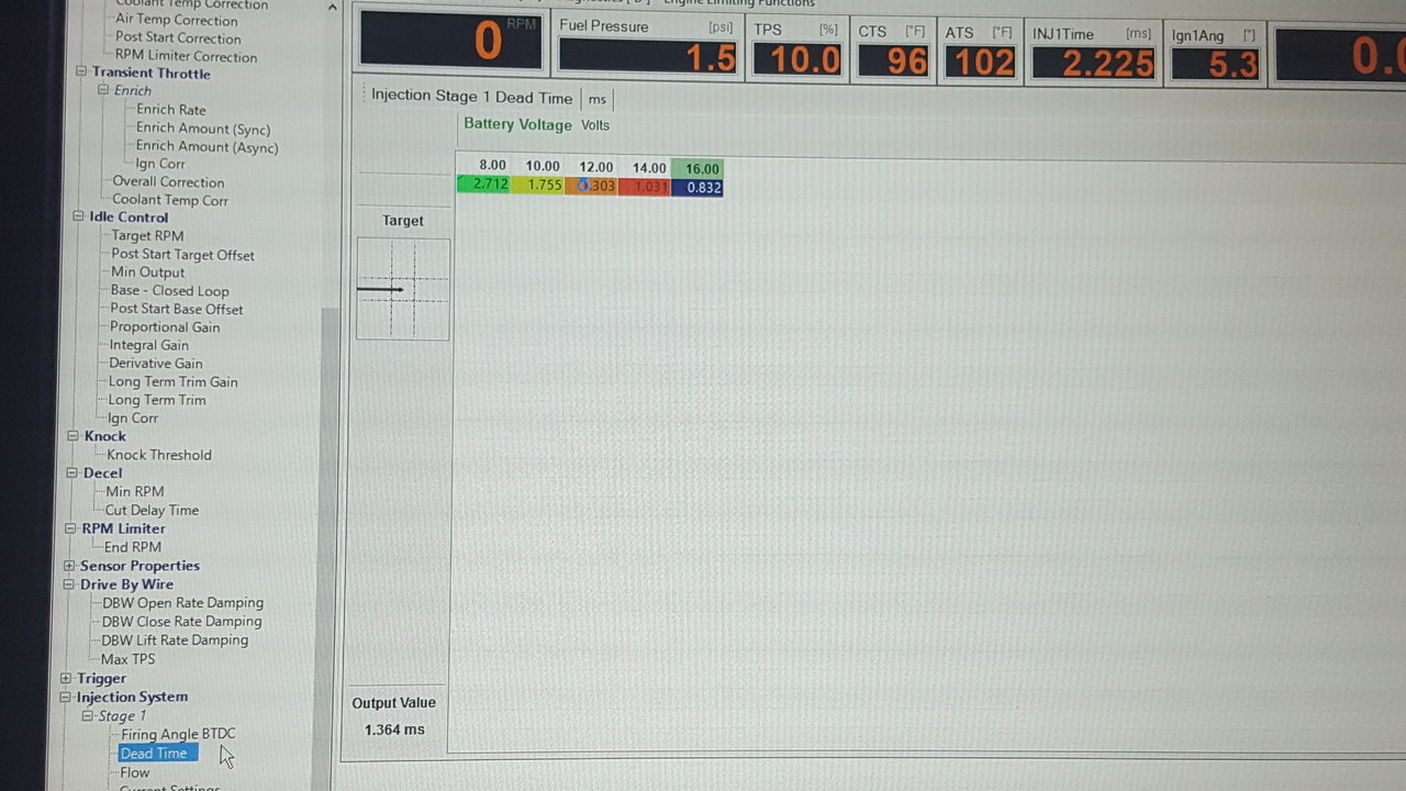

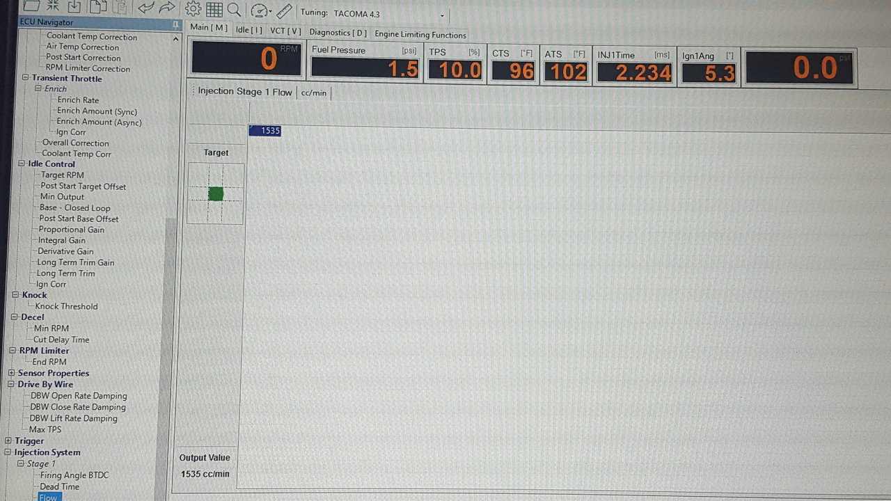

    As in these, for reference?

    I imagine with a quick search, you should be able to find that information. I might take a gander in a little while.

    Those look good.
