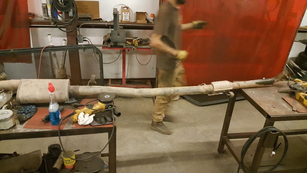

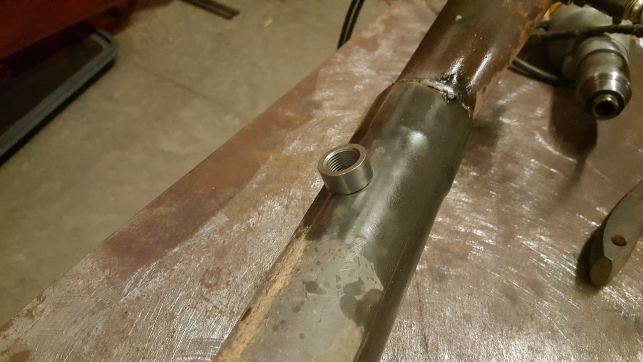

    Well, got the Wideband in!!
    :woot:

    Another piece of that puzzle. What's the word on the Haltech?

    Please share baseline AFR numbers before you plug in the Haltech.

    I am actually quite pleased so far! Seems toyota has a pretty well tuned ecu
    After the install, sitting there idling, it was +-.1 on 14.7
    Under almost all conditions under light load under VVTi, it is holding +-.2 on 14.7
    High RPM load I am seeing up to a whole unit rich but thats to be expected with a stock open loop WOT style.
    Now, it's time to do the Haltech, and double the injector size MWahahaah
    Just finished setting up all my sensor output/inputs to align with the boomslang. Should be plug in, wire in the analog wideband signal, check base timing with a timing light, install new injectors, and get her started!!!
