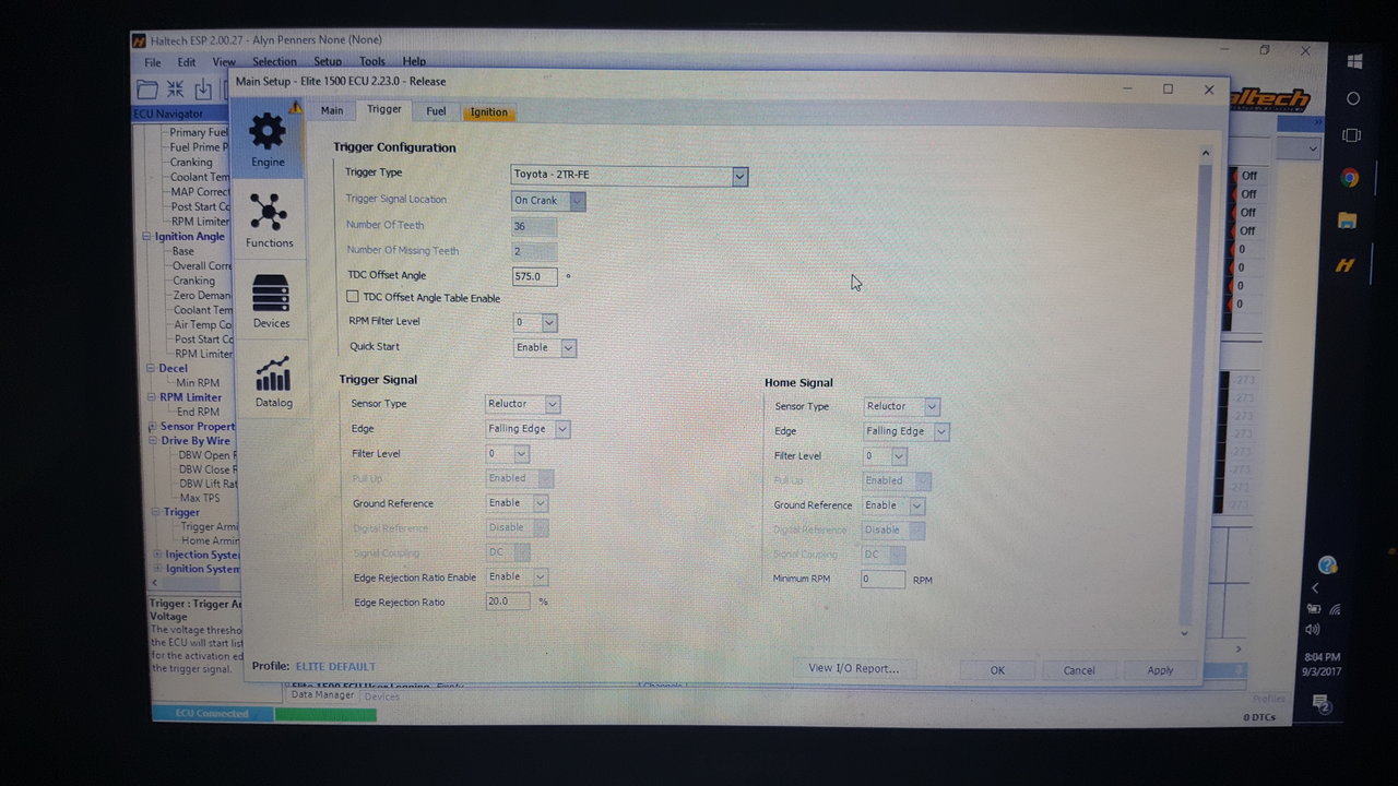

    SOME SUCCESS!!!
    After fighting with settings for what seemed like a week, I caved in and called Haltech.
    Mitch remote viewed my laptop, and within 15 seconds the crank signal was stong and he also set my offset.
    Tomorrow morning, injector swap, and first fire up...?? :D
    My Haltech Settings for the trigger:

    So what you are saying is, that the Toyota Tacoma 2TR-FE engine has a crank trigger with 36 teeth, missing 2; has a Reluctor crank position sensor; and a TDC offset angle of ~575 degrees (+ or - a few depending on the engine)? Just want to be sure for future purposes. ;) :D :spy:

    It times up perfect. Worked immediately after he set the ECU lol
    575 is def the offset for any american 2TR
